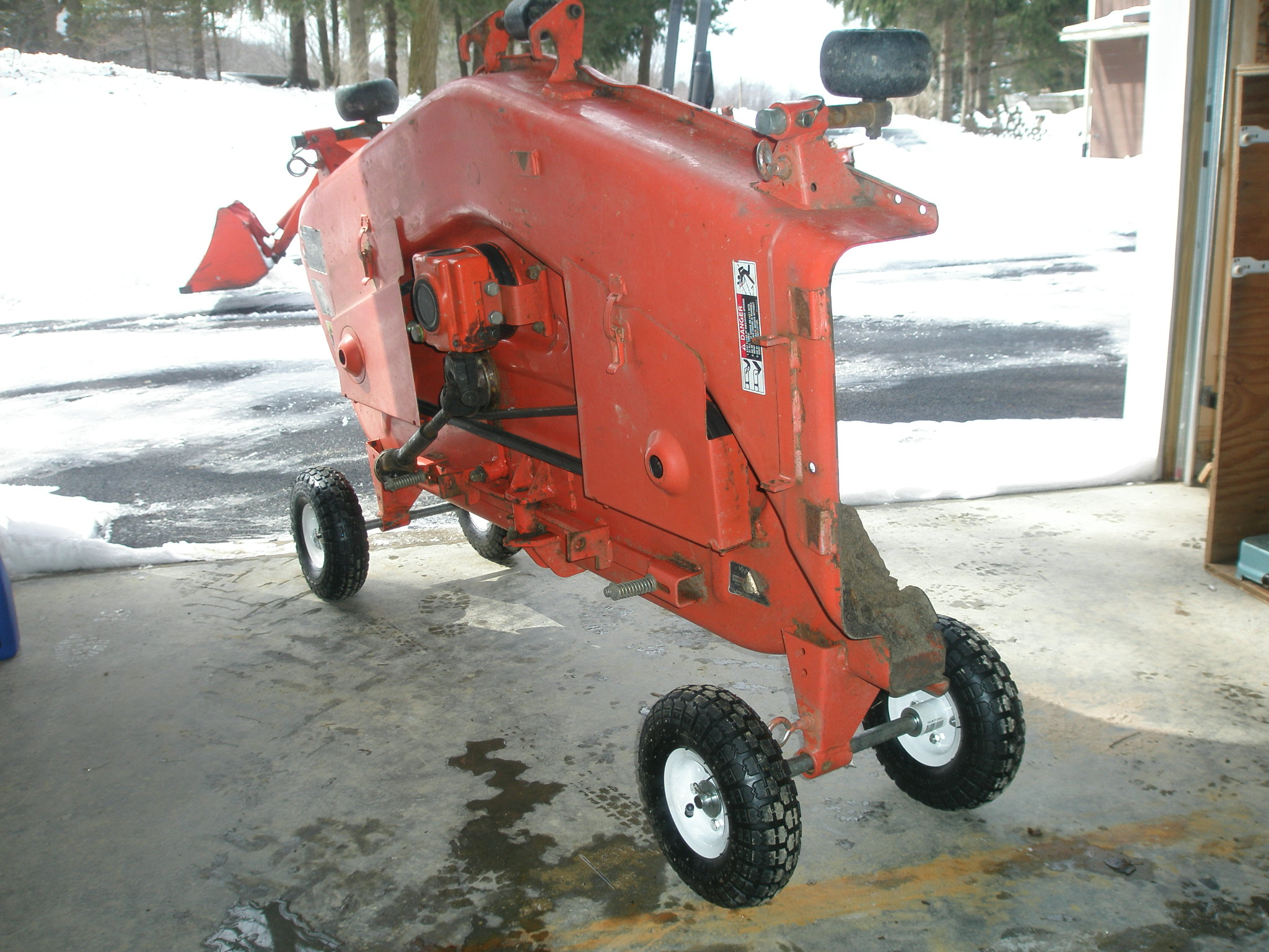

I did it! The mower stand is complete. Thanks for the Idea KennyG. Overall length of unit is 16". Gave it a rocker test and it will not tip over while working on the deck. I think if I should build another set I would make it 18" but am happy with what I have built. Couldn't help getting a picture of my newest acquisition from an auction today.

What about the oil in the gear box.I have a brand new mower that I haven't even used yet.I set it up on the stands & lost some of the oil out of the gear box.Can't understand how it leaked out as everything was tight.
   / Mower Deck Storage Stand #23
Rich F, I have had the deck on the stand for 10 days now and no oil leaks. I use 80-90 gear oil. I have a snow blower that would leak real bad so I went up to 130 weight gear oil and it helped slow the leakage down a lot.
#24
Most gearboxes have a vent hole somewhere so they don't pressurize when the gearbox heats up. I'm not sure how my JD 62 is vented, but it doesn't leak when it's vertical on the stands. On the other hand, I considered storing my 3 point snowblower on end to save space, but the gearbox on it has a vent hole on top that will leak when you stand it up.

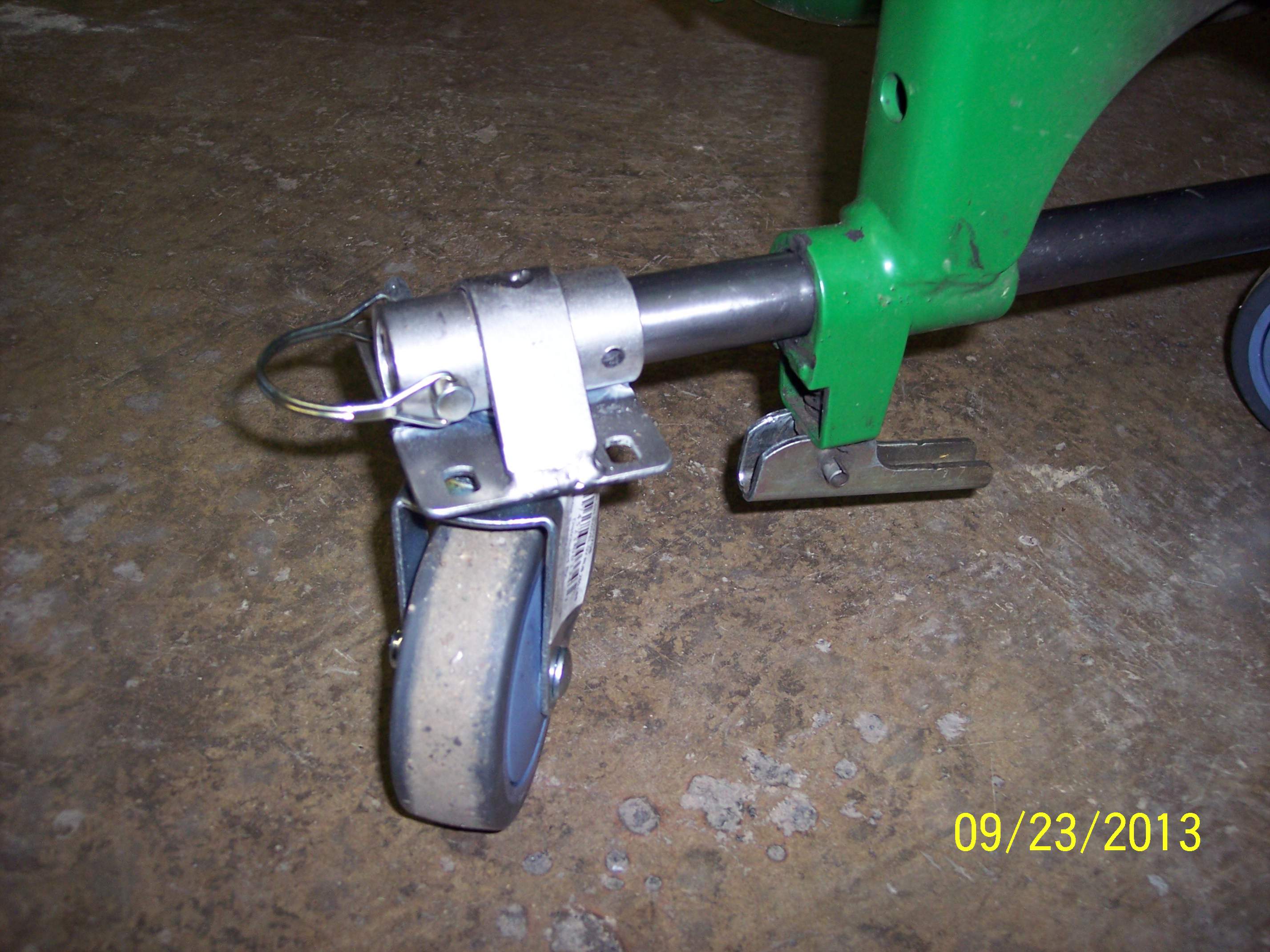

Does anyone have any idea as to what to use for a 1" diameter axle on a JD 60D mower deck? All of the 3/4"steel pipe and conduit are over 1" in diameter...
   / Mower Deck Storage Stand #34
I simply used 1" solid round stock and turned the ends down to my bearing diameter for two wheels on the one axle. A simple job for any machine shop. Or you could shop around for 1" DOM (drawn over mandrel) tubing.

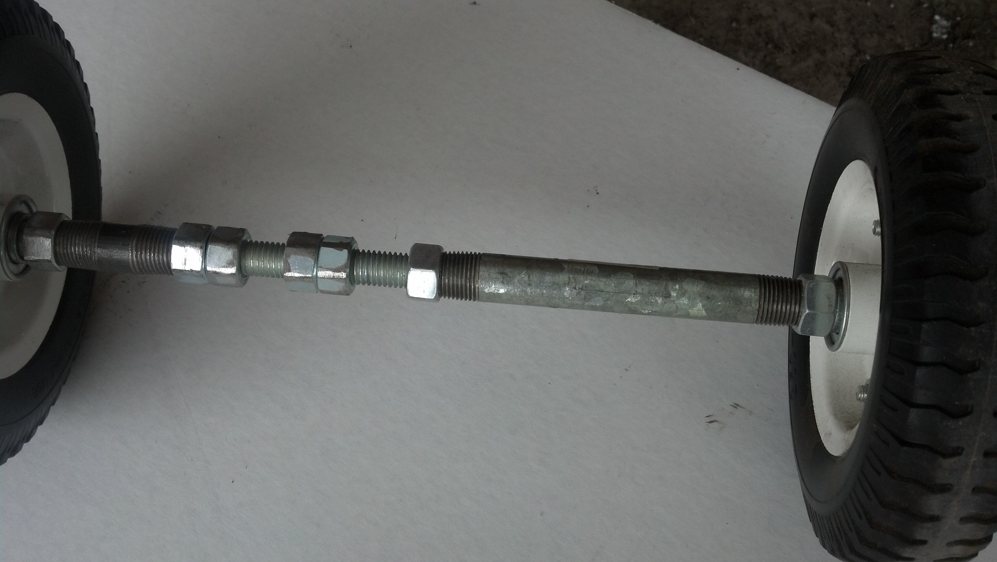

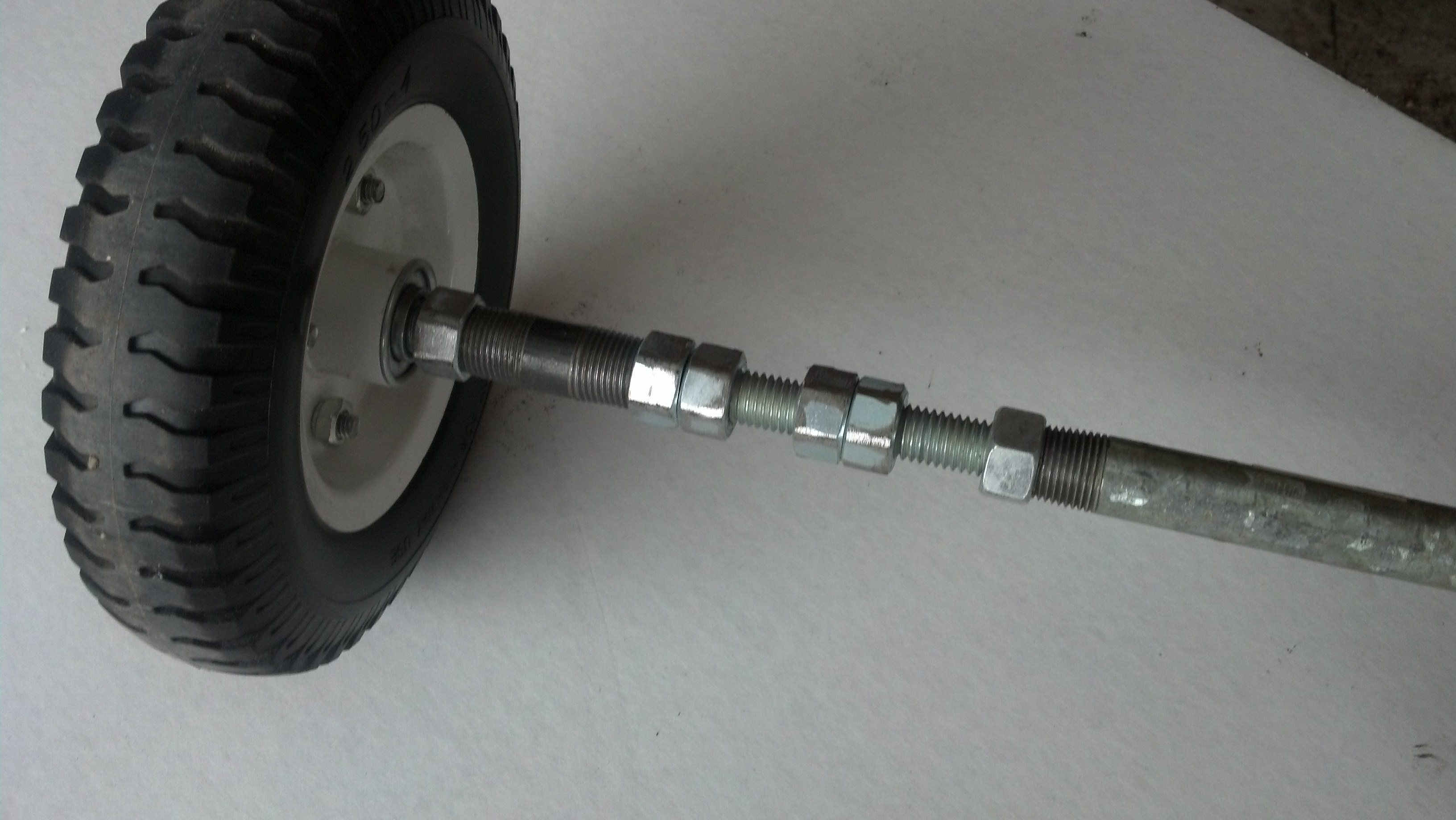

This is what I did for mine:
The only machining required was to round off the corners of the four nuts so that they slide into the mount on the deck. The gap between the two sets of nuts let me use the height adjusters to prevent the axle from sliding out.
The components are 5/8 threaded rod and 1/2" galvanized pipe.
I've used this for three years with no problems at all.
Hope this helps.
Dale
