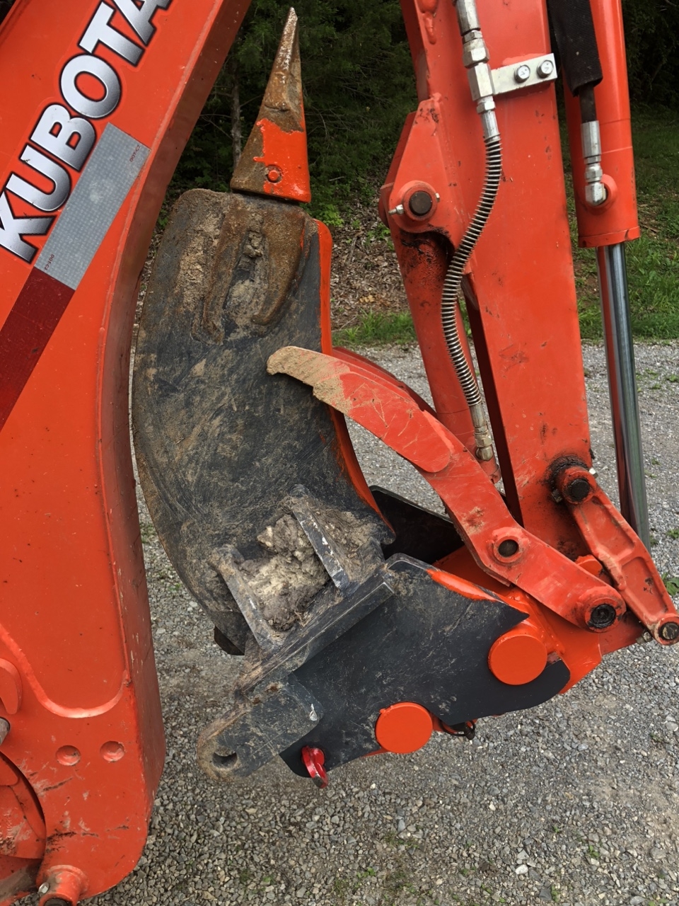

Taking advantage of the lower temps in middle Tennessee, I used the Terramite BH to dig out some trees of various sizes this morning. Compared to a couple months ago, I'd rate the digging at 4x harder than a couple of months ago when there was still some moisture in the soil and much worse than this Spring when the ground was loose.
I'd recommend that you temper your expectations because the results you can achieve in these dry conditions after the summer heat has thoroughly baked the soil will be much different than next Spring.

Trees are a constant threat of completely taking over the my hillside farm. Everything grows kudzu fast. A ripper on a small backhoe certainly speeds up the stump removal process. One of many tools for plant defense. Success is only temporary from the green aliens. Sure miss my cows and goats.

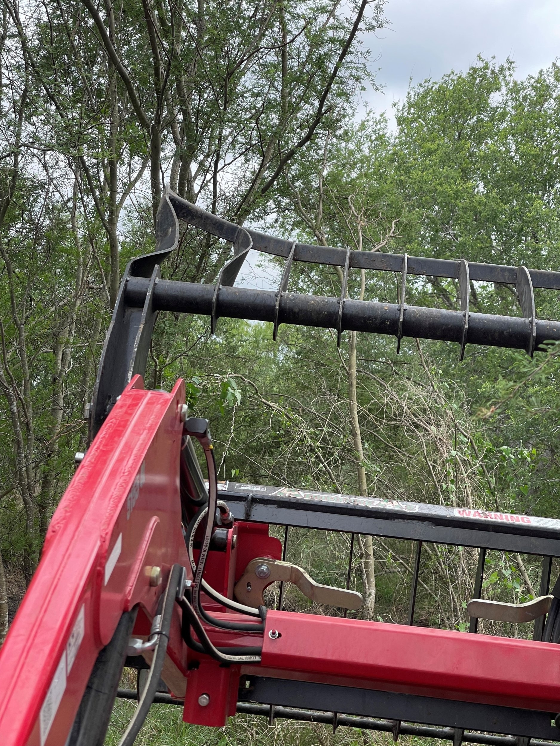

for small stuff 1"-2" i use the root rake on my grapple to push and clear them fast and then take the grapple using the curl function to lever anything that does not clear out of the ground. the larger ones i push over at 5' above the ground then hook the root ball with the root rake and then lift them into a pile. i learned the hard way not to push them over and then grab them from the side and pull. this was from an 8" that i had pushed over but the tap root was still intact, i had issues with access so instead of taking my time and clearing a path to get a better angle on it i grabbed it from the side rolled the grapple under and pulled, not a great idea.
