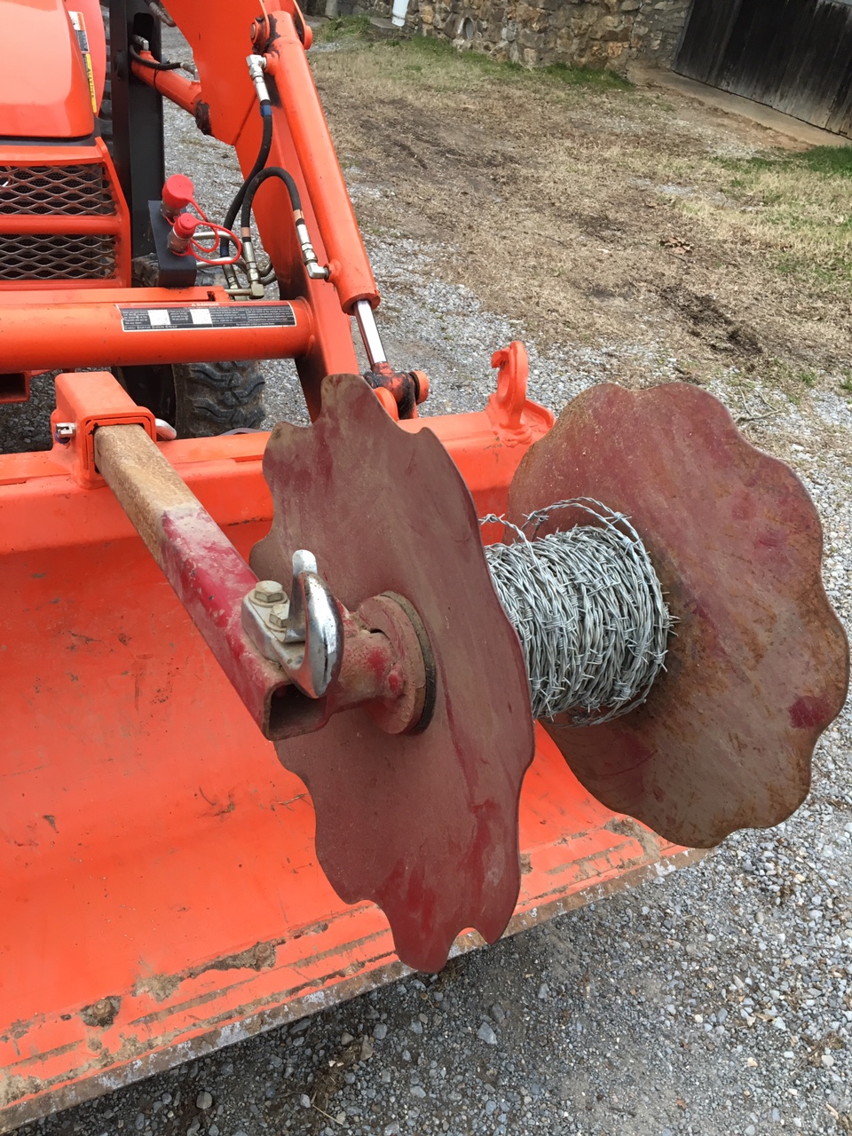

With the coronavirus keeping us self isolated, it has given me some time to add a fel hitch receiver to the bucket of my Kubota. Here are a few pictures. I used a 6” long 2” receiver and cut a hole in the back of the bucket to allow longer bars to be inserted. I made a cap to stay in place when I’m not towing.View attachment 649223View attachment 649225View attachment 649226View attachment 649228
Use the receiver more for barbed wire dispenser, bale spear, vise, sprayer platform as much as trailers.

I put one on the top of my bucket like Smokeydog when i first got it, along with 2 hooks, in line with each arm. I've used the heck out of the hooks. I've tried using the receiver to move my old trailer, but it just sits too high up to be useful. Eventually I bought one that goes over the lip of the bucket and has a big bolt with a giant T Handle to secure it. Works great. For what they were charging, it wasn't worth building my own, and I really didn't have the time right then either. If I had other uses like the barb wire reel you show, then it might be more useful.
