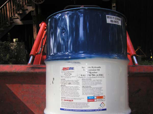

If your hydraulic fluid is hot enough to boil water (212*F), then you are in major trouble as it shouldn't ever get much above 160*F or so. It does NOT operate like crankcase oil.
Our Kubota L-39 GST TLB does have a hydraulic oil cooler due to the severe service it sees, as I would imagine the Kubota HST tranny tractors would too, I don't know for certain, but I would think it mandatory for an HST to have a hydraulic cooler.
The main differences between the two specs are in the kinematic viscosities across a range of temperatures.
The 55 gallons of Amsoil's Full Synthetic 5W-30 Hydraulic fluid that I am using in our L-39 GST TLB, L-3130 GST, and ZD-21 HST match Kubota's SUDT specs!
