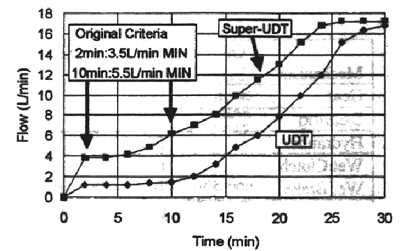

Here is a real good reason to use SUDT instead of a UDT rated hydraulic fluid in your Kubota HST, GST, and hydraulic pumps! /forums/images/graemlins/blush.gif
That makes it extremely easy to understand why Kubota put their special SUDT in my L-39 TLB with 23 gallons per minute of hydraulic flow!!! /forums/images/graemlins/grin.gif
