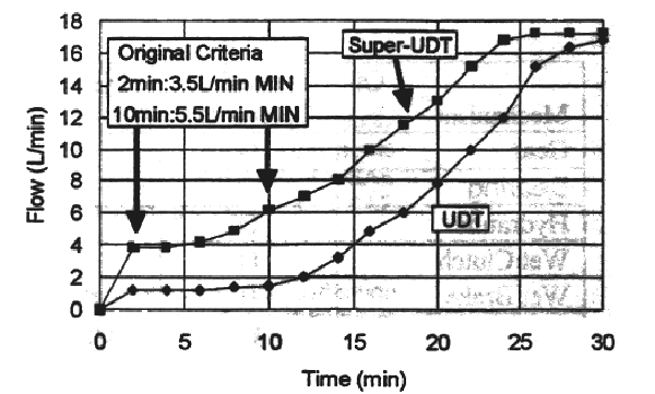

So did everyone finally understand why a dealer advising against using Kubota's Super Universal Dynamic Tractor Hydraulic Fluid in the HST and GST tractors is a dealer who you do not want to take their advice or your business? /forums/images/graemlins/cool.gif

Does this mean you won the UDT/SUDT comparison debate? /forums/images/graemlins/shocked.gif To a degree it does. /forums/images/graemlins/smirk.gif Does Kubota advise against using UDT as you do? No, but they clearly state that it offers better protection. So they weigh in on your side.
I was not too suprised by the flow separations in your attached graph. Basically what I would have expected, except I thought the merge would be closer in time. I didn't see the ambient or fluid temps noted though. I'd be curious to know that if you do.

Chris, that graph is @ -30*C. I am glad that you asked that as I specifically did not post that infomation to see how long it would take for someone to ask, indicating that they are really thinking....
FYI, the other graphs I did not post, show SUDT and UDT not even coming close until oil temps reach 100*C, which I seriously would NOT advise trying in your hydraulics.
But, even at 25*C which is a normal ambient temp of 75*F, there is no comparison between the flow characteristics of SUDT & UDT, none.
Also, SUDT is particularly good at preventing rust in the HST's wet clutch compared to UDT, as well as keeping water emulsion from blocking out the hydraulic filter assembly.
   / My dealer advised against SUDT #34
UDT could never hope to match SUDT, it is chemicaly & physically impossible for a straight cut 30 weight dino UDT to come anywhere near the flow characteristics of a multigrade 5W-30 synthetic, as the graph indicates, flow rates are 200% to 300% better during the critical first 15 minutes of operation....I'll take my SUDT anyday... without the waxed paraffins! /forums/images/graemlins/cool.gif

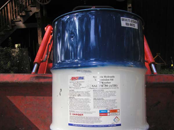

I started up my brand new New Holland TC48DA with LA18 loader at 22 degrees F Saturday morning, and the noise comming out of the valving where the loader control lever is located was a bit un-nerving. I must say that 22 degreees F isn't that cold. My neighbor and I went together and bought a 30 gal barrel of Amsoil 5-30 synthetic hydraulic/trans fluid and I can hardly wait until 50 hours service to change mine out. I'll save the "old fluid" and use it in the backhoe, that only really sees warm weather use. It will be interesting to "hear" how the Amsoil flows at the "extreme" low temperture of 22 degrees F. /forums/images/graemlins/grin.gif
   / My dealer advised against SUDT #37
I think you will be pleasantly surprised at how much difference there is with the increased flow from the Amsoil 5W-30 multigrade synthetic, money well spent!!! /forums/images/graemlins/laugh.gif
