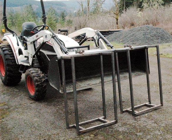

This is a project I finished some time back, but I'm very happy with it and decided to share.

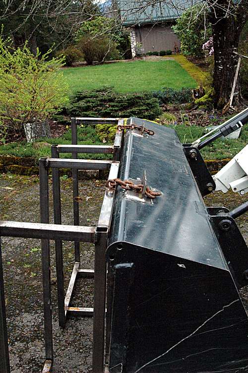

I built a set of firewood racks out of 1 1/4" tube, so I could haul wood from the shed to the house. They have some old chain welded to the top-piece so I can carry them using the FEL and my chain slots.

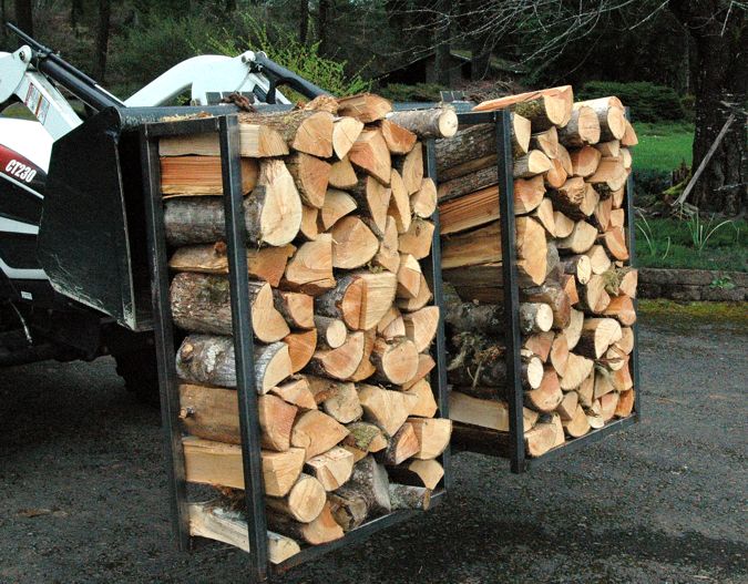

Here's a photo of the racks full of wood being carried by the tractor.

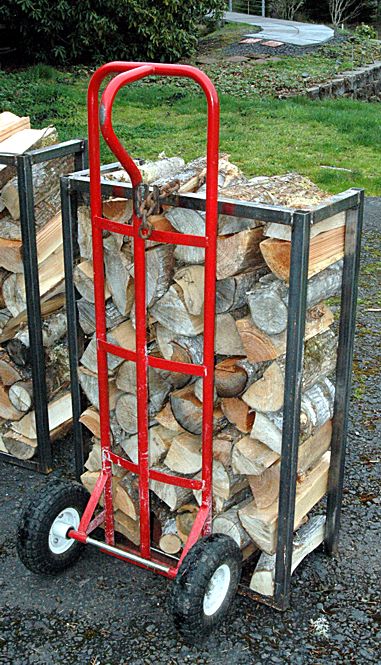

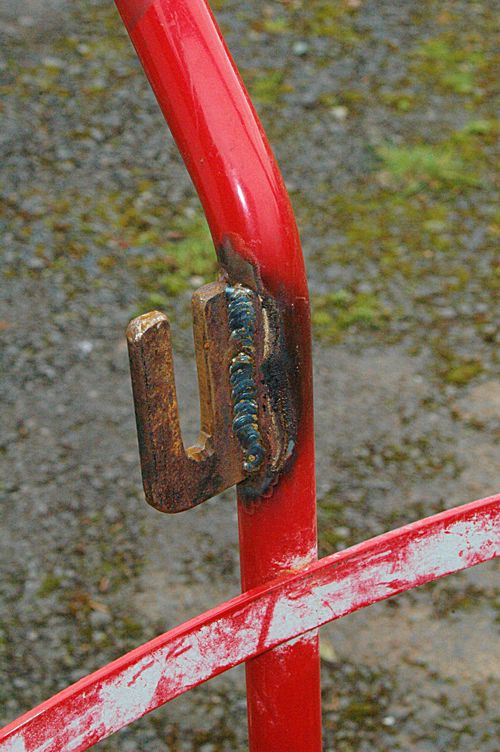

Once I get close to the house, I use a little Harbor Freight hand truck to move the wood to my deck. I welded a little chain-slot onto the hand truck to help secure the load.

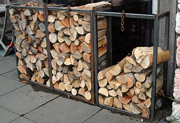

Here are three of the racks staged next to the chimney and a sliding glass doorway.
I forgot to show the canvas cover I sewed to protect the wood from rain and bird-poo :smiley_aafz:. It's open on the house-side so I don't need to take it off to get wood.
