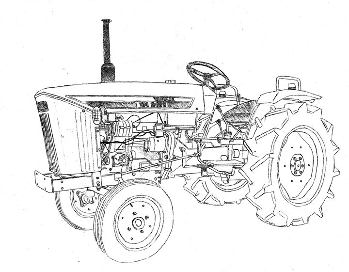

Good to hear you got your Yanmar running! At $200 you defiantly stole it. :thumbsup: I actually did a drawing of a YM2000 I did a while back that you might enjoy and it is even the same style as your Yanmar. :thumbsup:

Nice drawing Johndeere.
