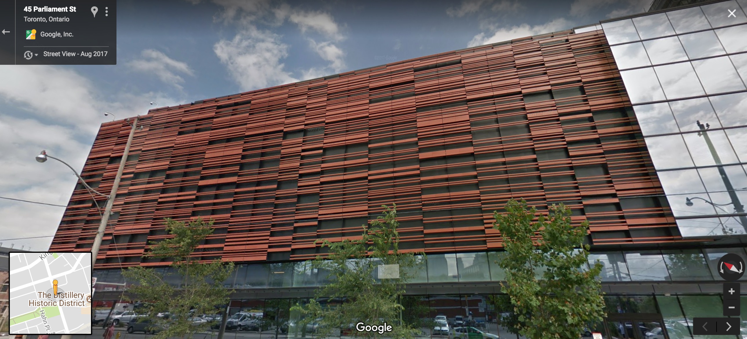

So to all, I do get that it is easier to bid something you have done as opposed to something you have not done. Eddie, you are absolutely right and I came very close to just building a more conventional structure. And in the end you are going to be right, the lines of the building will be harder to see. Siding will be critical to the modern motif. I saw this the othr day, it was really an interesting idea for siding. But this quote is now at the price of normal pitched buildings.
But taht would be for down the road, not for the immediate.

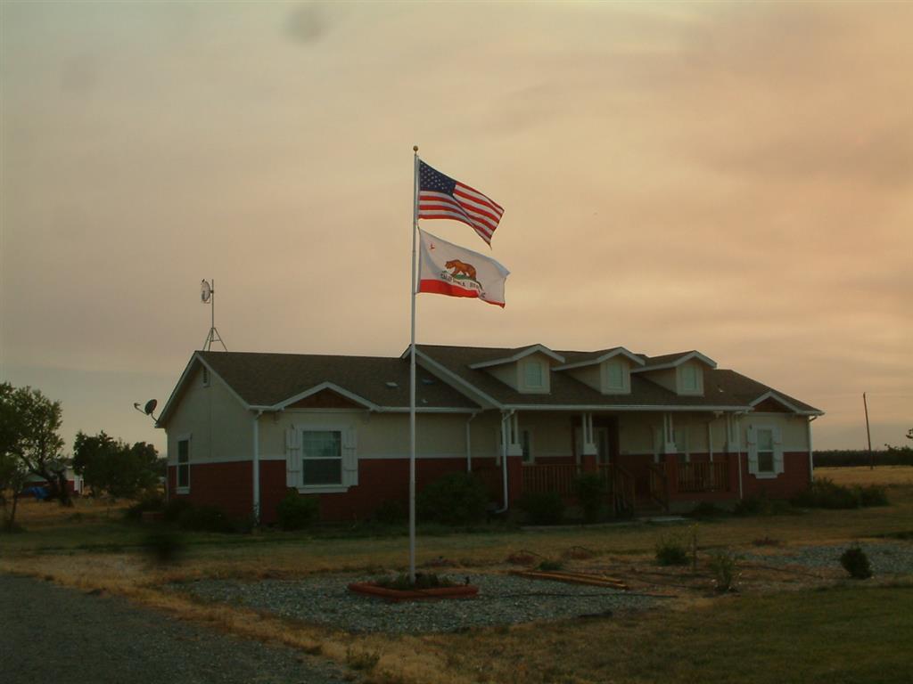

Here's my manufactured home. 1800 sq ft, 3BR, 2BA on a permanent foundation. Installed in 2005 on my 10 acre ranch.
