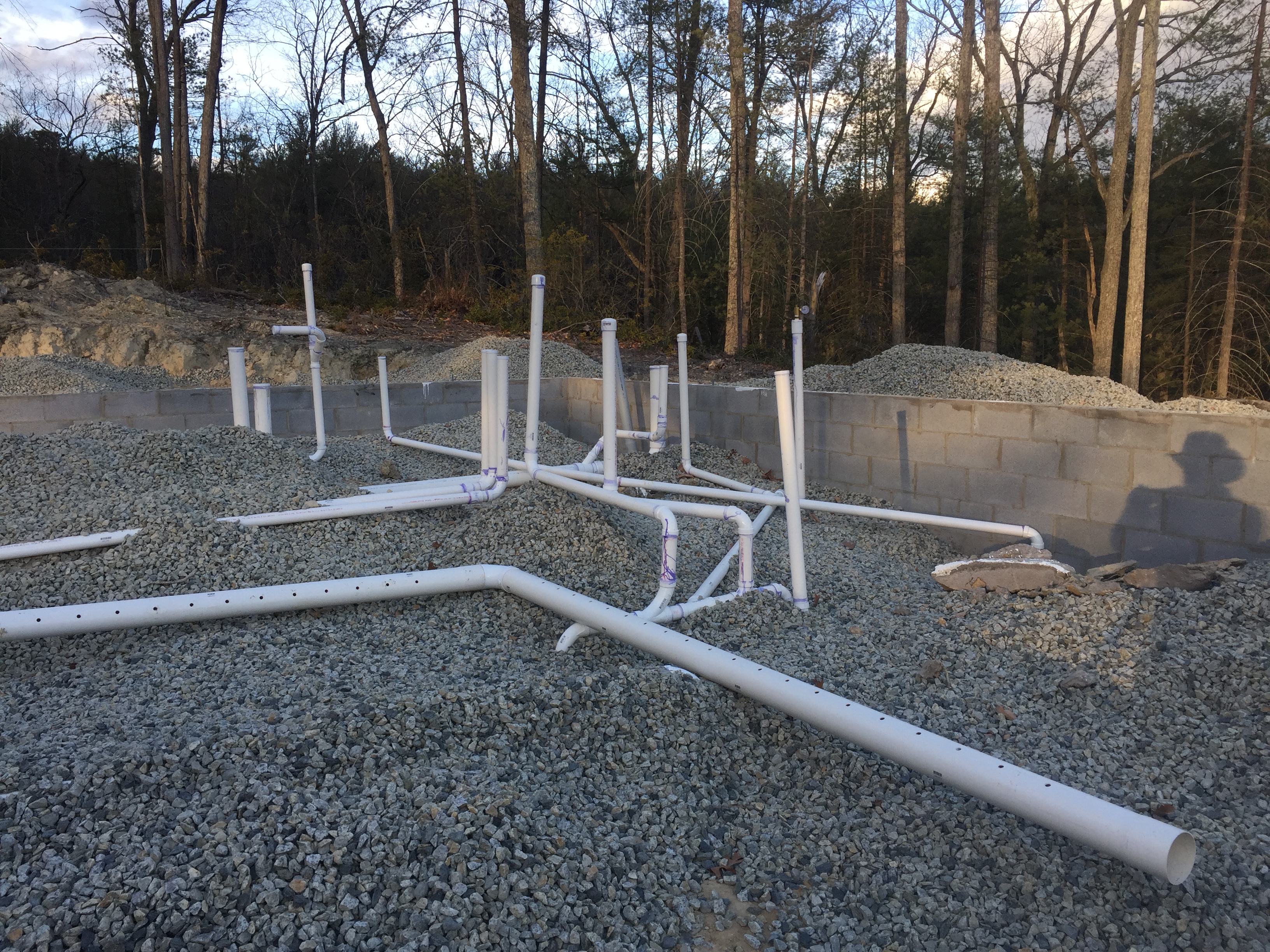

In coordinating with my cement /foundation guy, there was a little more I wanted to get done before they came in to fill the gravel and instal the insulation for the cement.

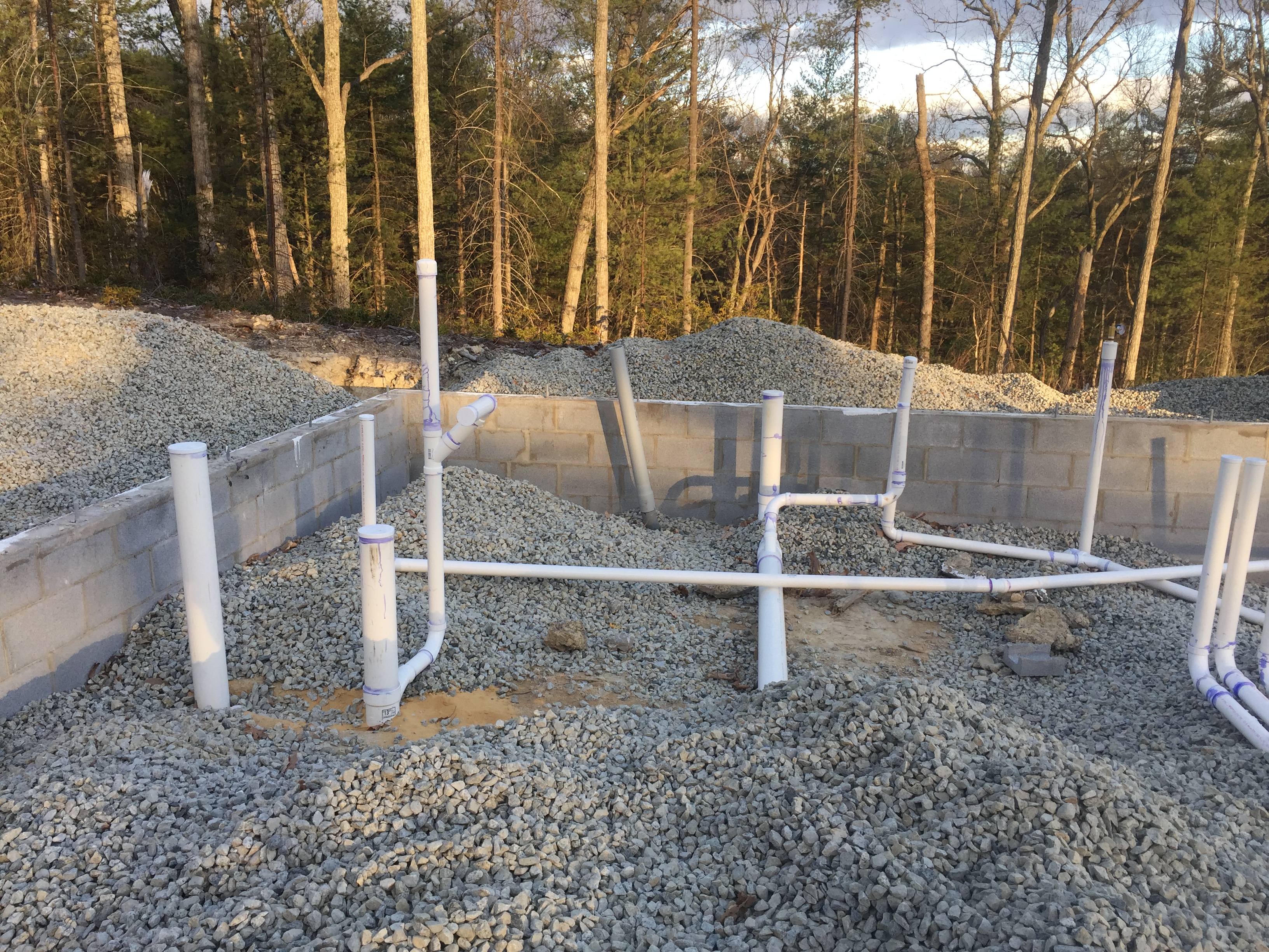

Radon mitigation, built in from the beginning, was important to me. I needed to run some conduits across the house to carry electricity's from one side to the other because the center of the house is open ceilings with post and beam.
I am just realizing that I didn't take pictures of the radon pipe I put in. Here is a picture of the end of that pipe as well as a floor drain that I added for the boiler room. Drain pipe crosses from left to right and exits wall to daylight.

The radon pipe is set up in a U shape which follows the general U shape of the house. I emplacing the egress pipe on the opposite end of the house from our bedroom, incase the fan can be heard inside the house. My daughter took offense to that since her room is on that side of the house and I mentioned that she was only going to be there a couple more years and perhaps it would provide motivation to get out when the time came.:D

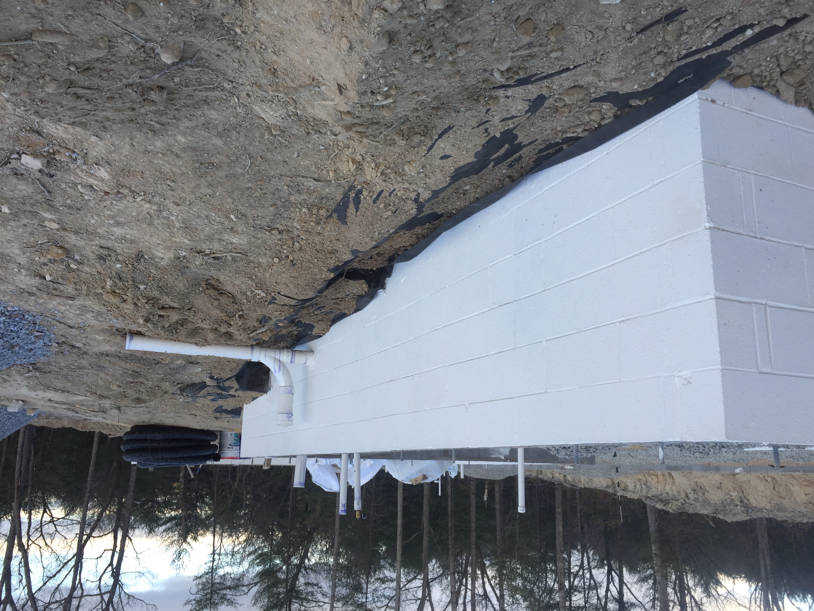

French drain. This was a tremendous amount of work. We put 3 coats of Dry Lock extreme, trying to seal every pinhole and crevice. I know it isn't possible but making the effort gets you a lot closer than not making it.

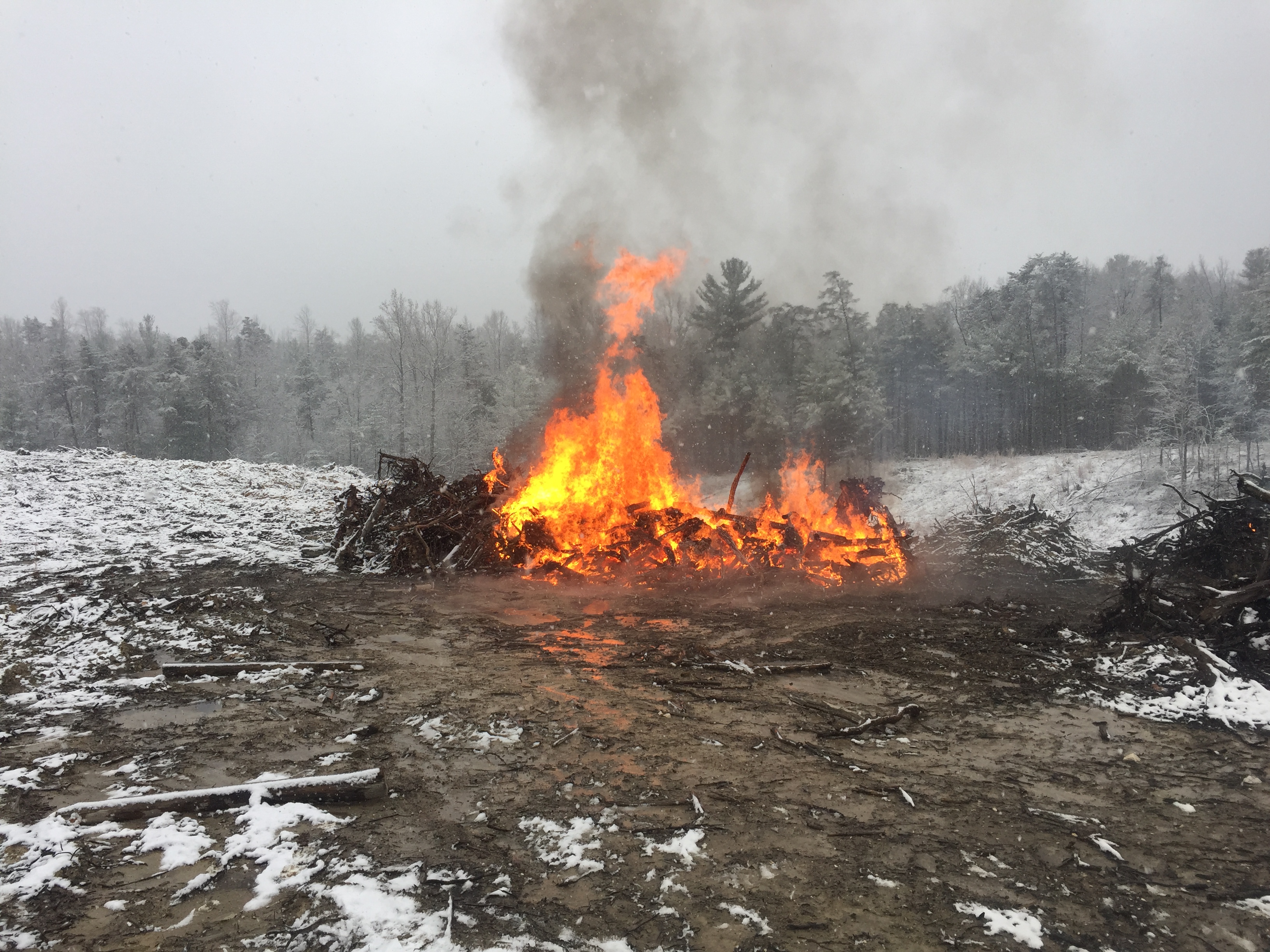

Building a house involves a lot of peripheral tasks as well. We had snow last weekend and this provided an opportunity to burn some of the debris. We will be burning for a several years before we get it to a maintenance level.
Burning a large pile is a full day but I prefer to stay out of the build site when it's raining or wet because it just turns into a big mud pit.

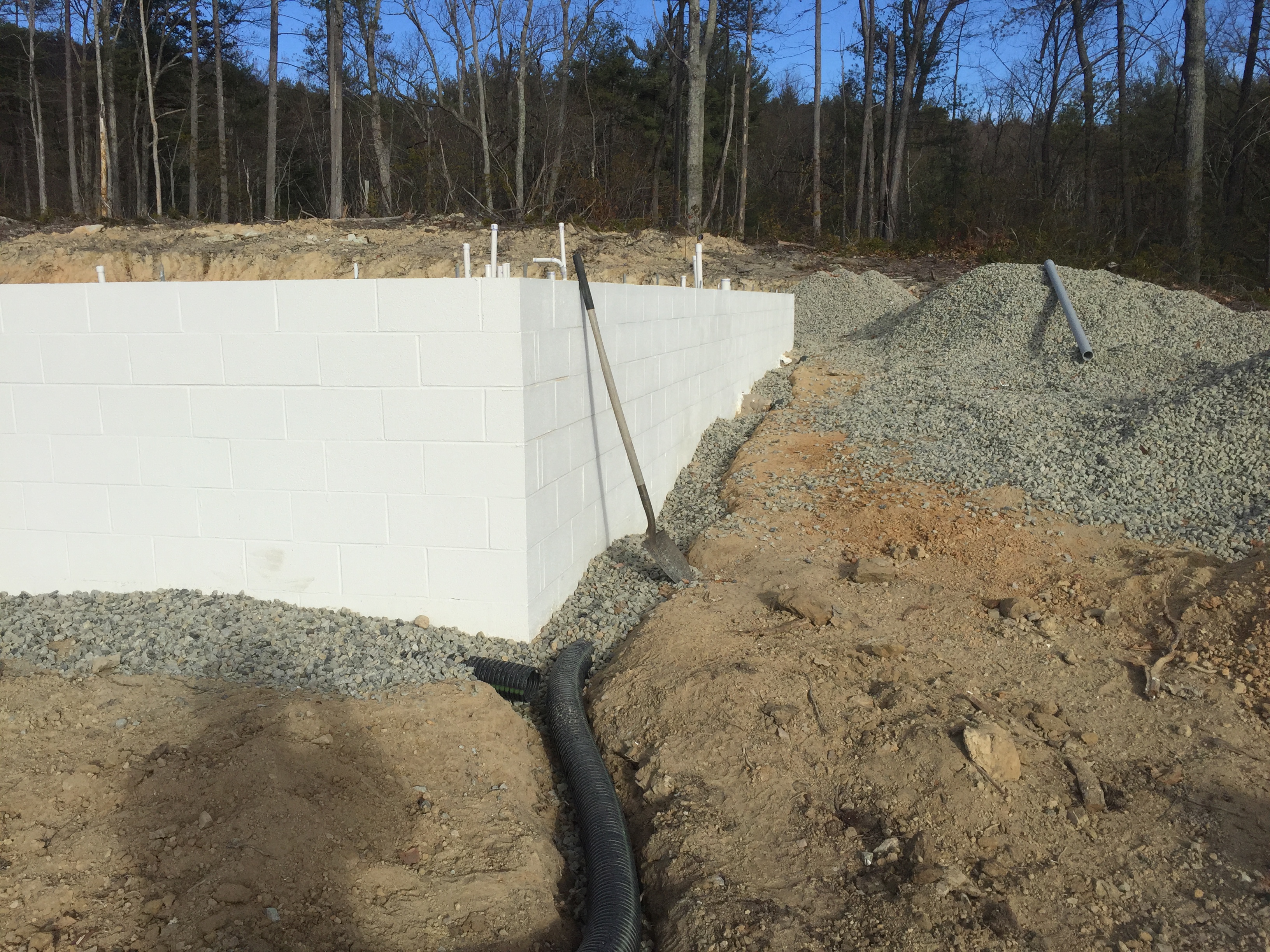

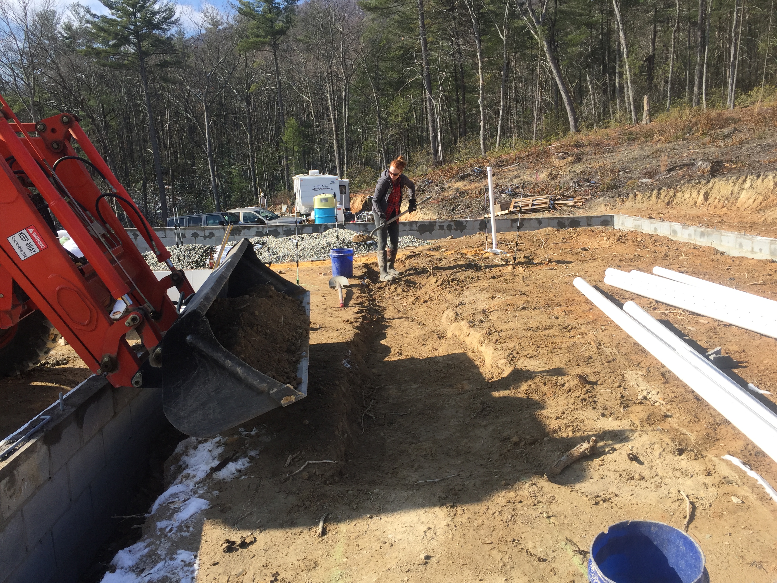

So the snow melts and it's back to work. I started digging out the trench for the French drain. My foundation guy doesn't think I need it. the slope of the land and the planned slope behind the house should be enough. I think about all the trouble my parents had with their foundation as I was growing up and how much of a pain it is to put something like that in after the fact and decided that I was just going to bite the bullet and do it now. Do it once, do it right. Hopefully I will never have to think about it again.
I dug out a 4-5 inch deep trench next to the footers all around the back and sides of the house, as well as the front , but not inside the center of the U because that will be cement courtyard and I don't think it will be an issue. The main roof slants toward the back of the house and gutters should channel water to a cistern but sometimes the rain here is intense and I imagine it might overpower the gutters. Also there is the slope of the land behind us that will saturate in a heavy rain and the water will flow down toward us. Again, the plan is too properly shape a swale into the land to carry that water away and never have it get up to the foundation......but just in case. put in a layer of stone, then the 4 inch corrugated drain pipe, holes facing down. then covered that with stone. Then covered with landscape fabric as a soil separation barrier. Then began the process of covering that. All told, I used 300 ft of pipe and a 3x300 ft roll of landscaping fabric.
Because of overlapping at corners, the 300 ft roll of fabric came short of the last pipe....had to improvise with 10 feet from an erosion barrier.
The digging and burying of the drain took 4 days first and last day was me working alone. One day I had two of my kids working with me and one day I had my wife there. I worked from sunrise to sunset each day.

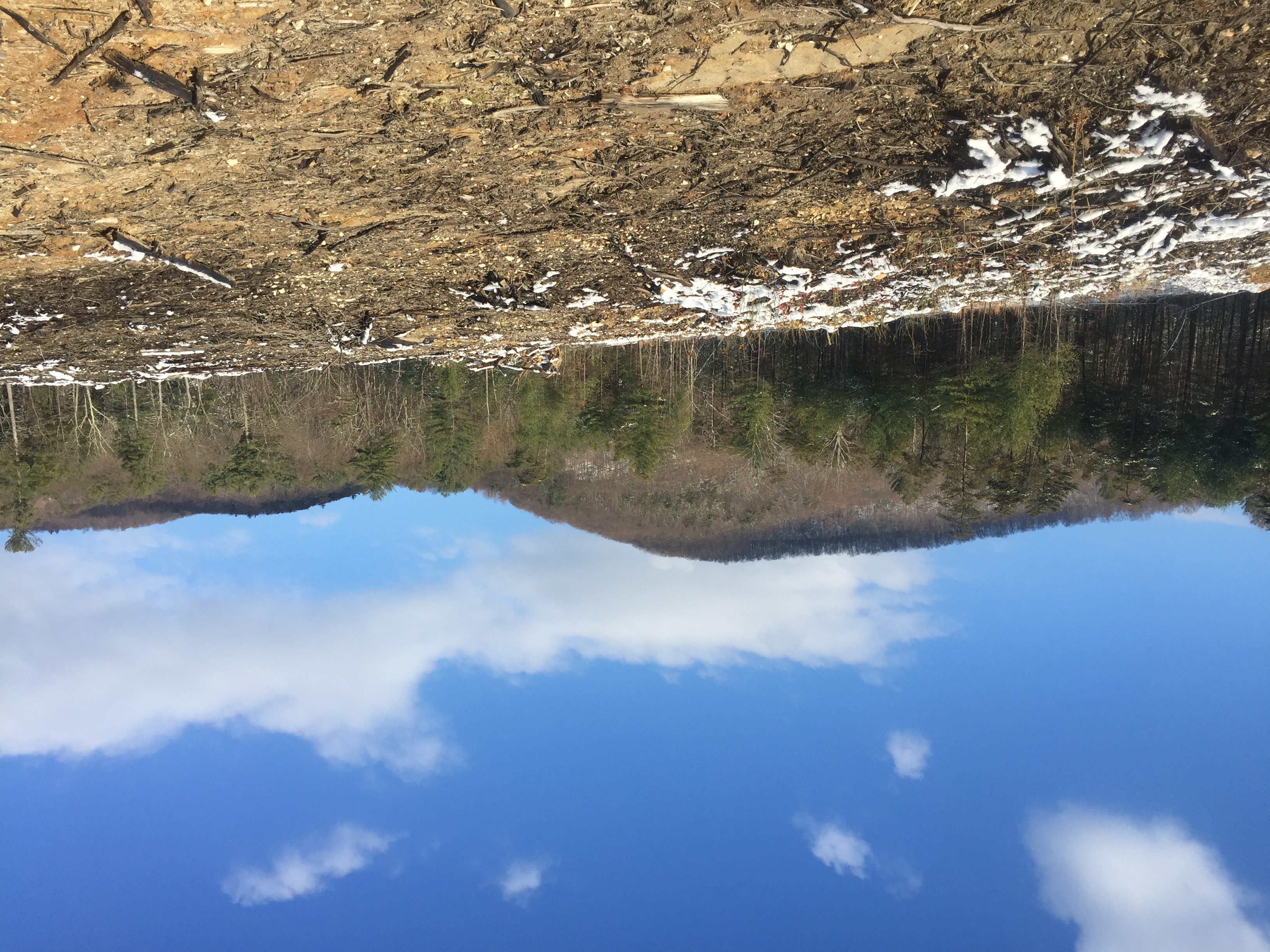

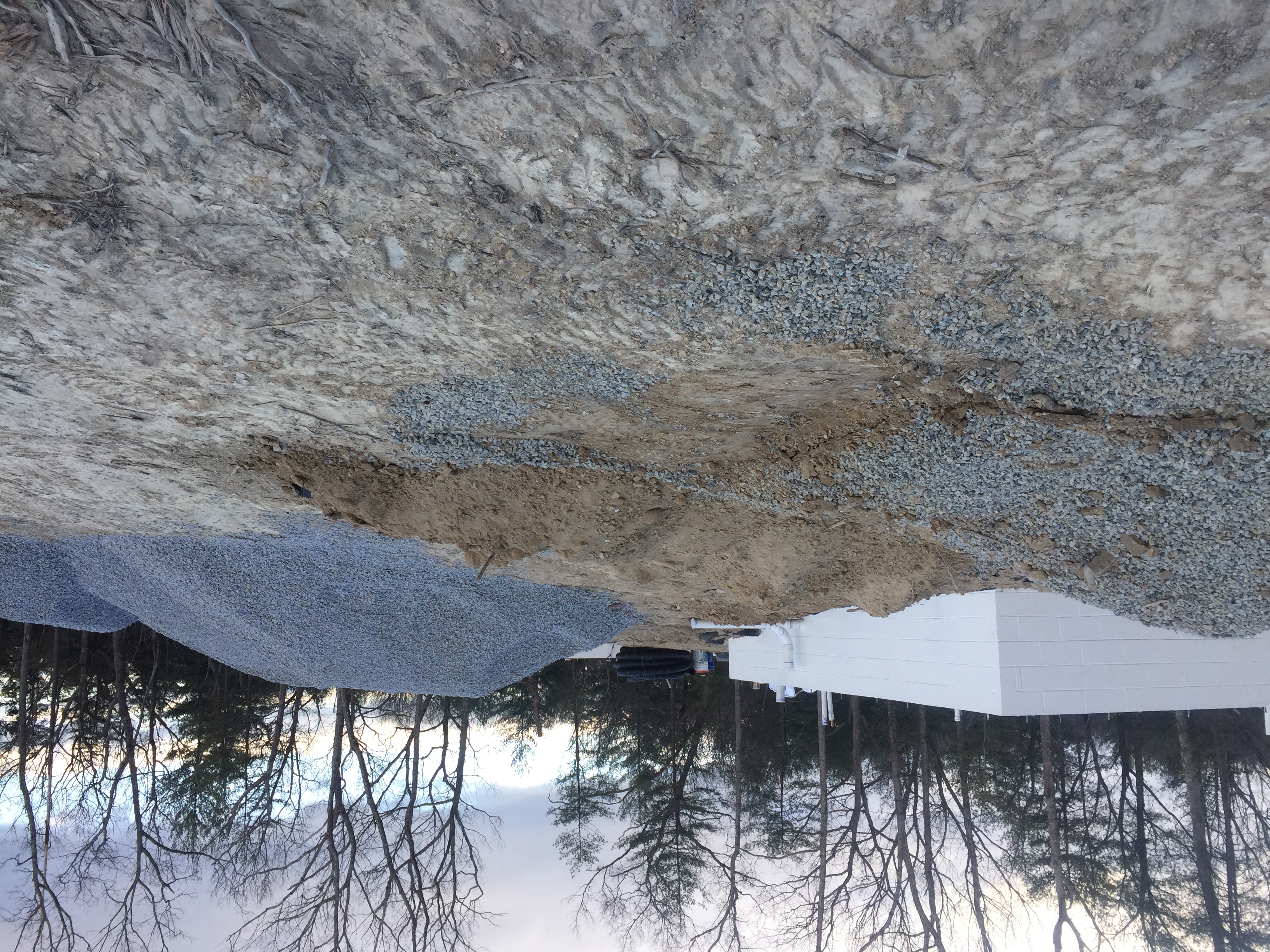

upside down pictures irritate me

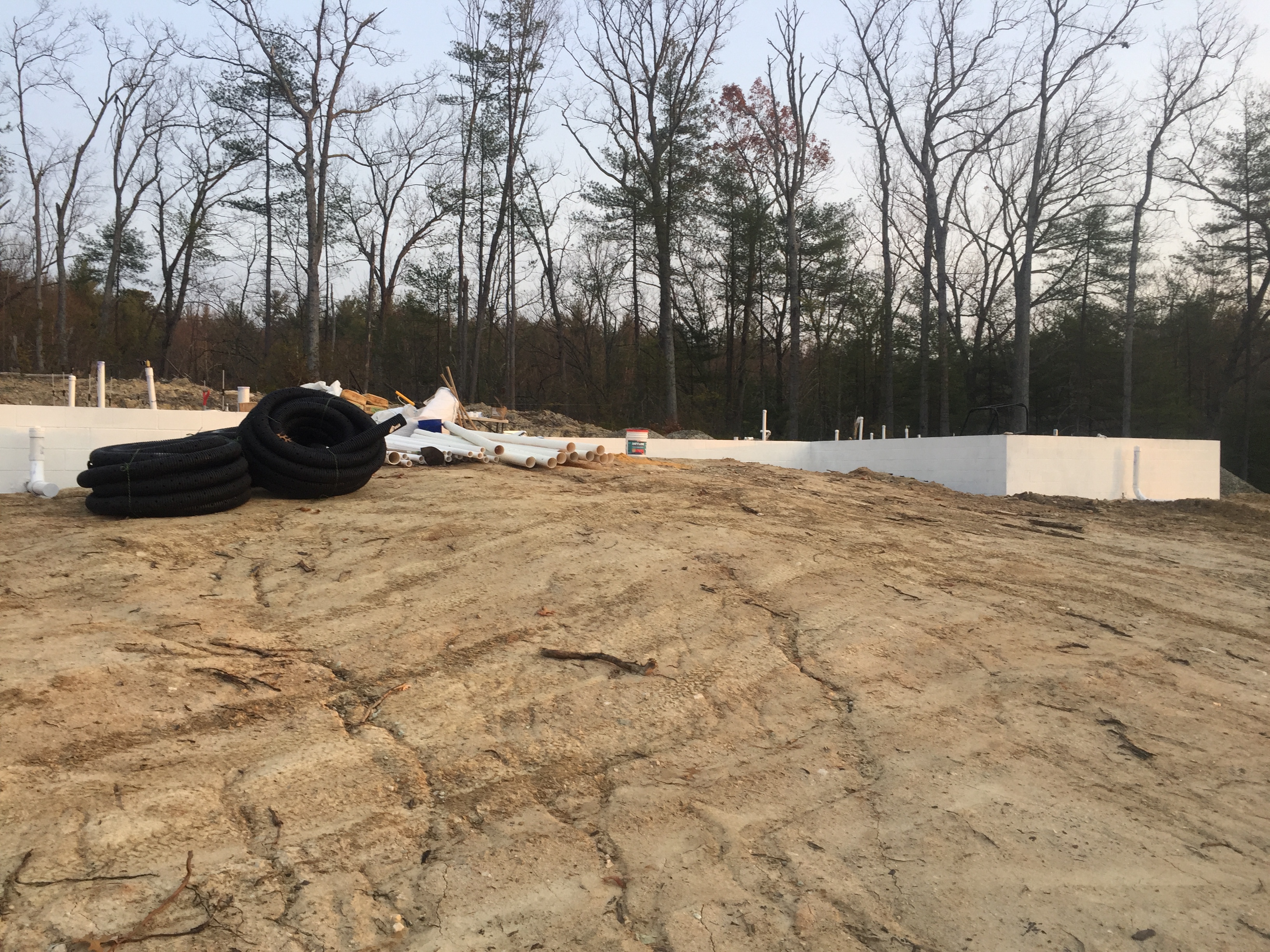

So as can be seen from some of the pictures there is more gravel than was there before. My foundation guy said we needed another 60 ton of fill, so I ordered 80......If there is any left over it will get spread on the road. We had 4 trucks show up all at once yesterday morning and another truck came back a few hours later.
the last thing I did was put in the conduit for the pigtail to the well to come in the house. it is the grey pipe in the back. It is slanted to the side, intentionally. If I came straight up, it would have been in a wall. I want it to come up in the boiler room.
One last picture of the floor drain for the boiler room. As I said, it goes out the wall to daylight, tied into the French drain. Hopefully it will never see a bit of use.IMG_8074.JPG
And this his where I am now. Thursday, the crew will arrive and start working on filling the rock in. The materials will be delivered for the insulation and reenforcement of the cement. Over the Christmas break, I will probably get up there at least one day and clear and flatten the land behind the house where they are drilling our well and hopefully they can get started on that early in January. I expected to have the house under roof by now. Hopefully my experience can be of use to someone else. I have tried to include some of the mundane things associated with building so that realistic expectations can be drawn for anyone else preparing to do this.
