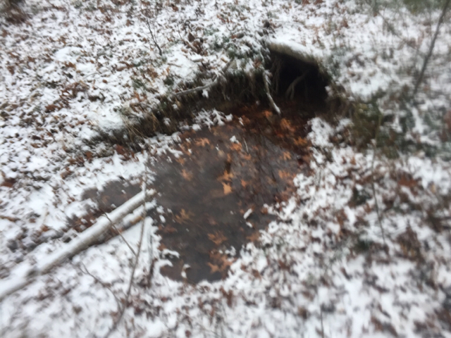

I went for a morning walk yesterday to enjoy the snow and took a quick picture of one of the springs.

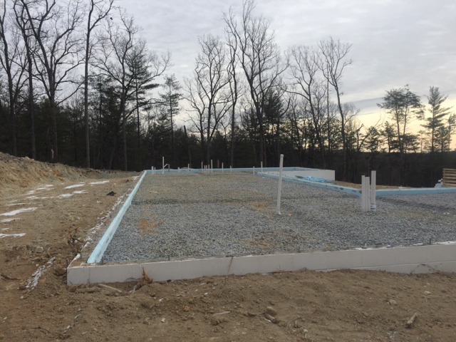

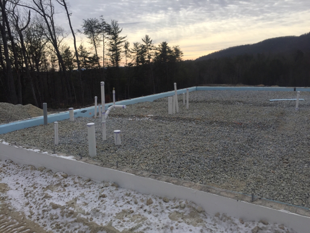

We are at a stopping point in the house. The stone fill was placed in the foundation. My cement guy likes for it to settle for a few days before mechanical compaction. Also it is so cold the tape wont seal well on the insulation And plastic sheeting. IMG_8156.JPG

Well, that's real nice. There's something about a spring that just feels good. That one looks like one of the typical small perculation springs that are formed when there is an underground connection through porous media to some higher perched water table. If that is the case, the water quality will depend on whatever filtration & mineralization is happening as the the water is traveling to get there, and also on the state of the upper supply.
You are lucky being in Va, as they are one of the states that has a program that maps and documents springs - that is, if you want to go that way. Or if you just want to use the water without gov't help, there are lots of publications that show how to properly develop a spring box. https://wvdhhr.org/phs/forms/SW-252c,_Springs.pdf
The idea behind a spring box is to slightly increase the rate of flow while cleaning up the quality. Making one is simple to do and works well. Before chlorination, spring water was the best there was. Some still think so. You could make a proper spring box and then have the water tested yourself for a reasonable fee.
I test ours every couple of years by sending a sample to a local lab at the university.

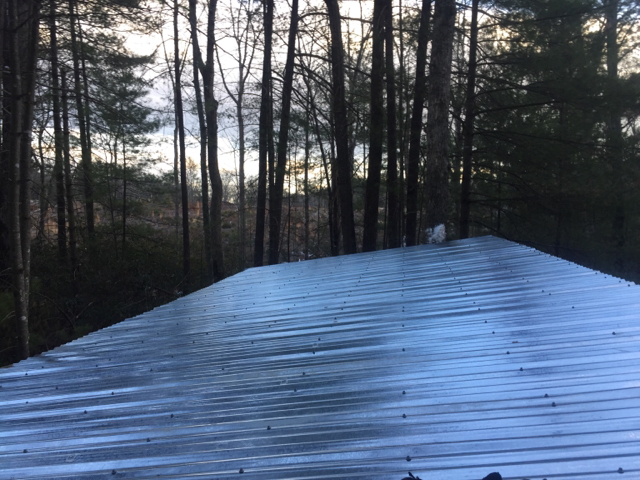

While the house build is stalled, there are many other tasks on the farm. Yesterday we put a metal roof on a storage shed that we had rebuilt and today we are heading back out to put osb on the walls. I have been meaning to start a thread about the rebuild of this shed, which was an8x8 hunting shack when we bought the land. Roof and floor were rotted out and windows were never installed but were onsite and broken. I began tearing it down and discovered that the bones were in decent shape. The location is convenient to store hand tools so i decided to rebuild it and tripled the footprint. One side has had osb on the walls and the roof has had osb and underlayment for several months so it has already proven to be convenient to keep tools and supplies out of the weather.
