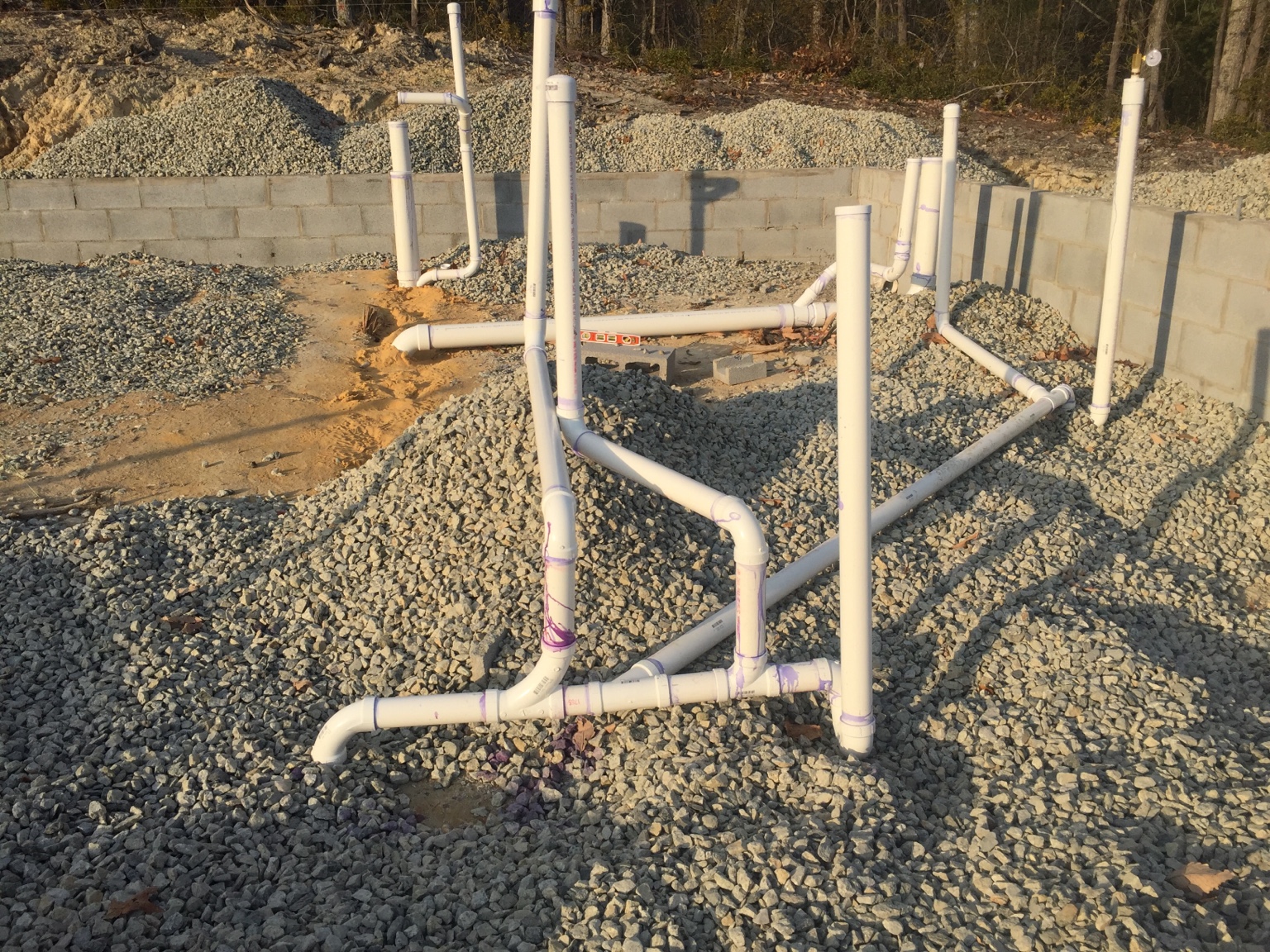

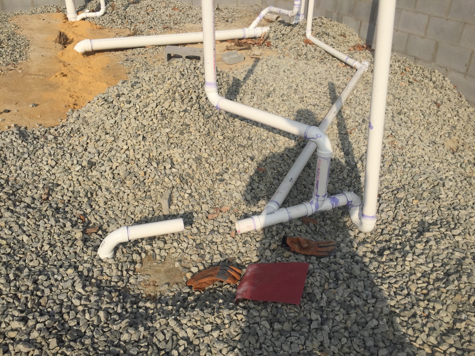

Since I'm in Crozet, having some chick and waffles (and the internet is stronger) I thought I would update some photos.

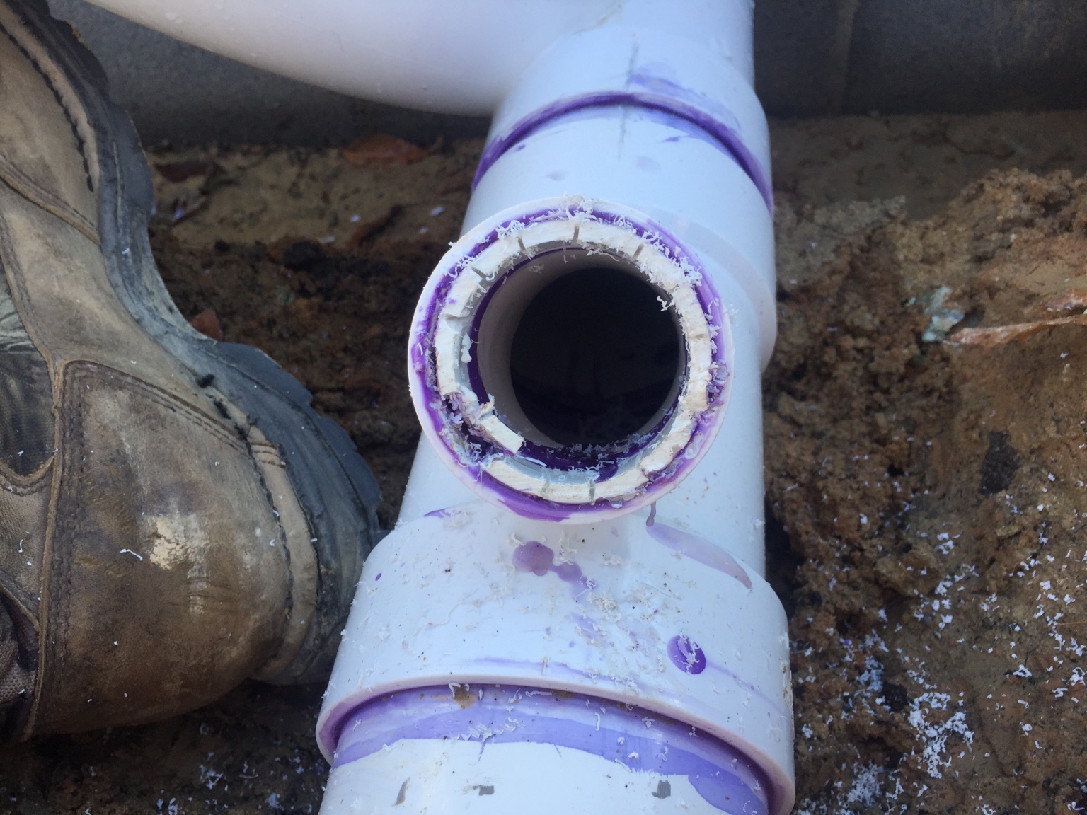

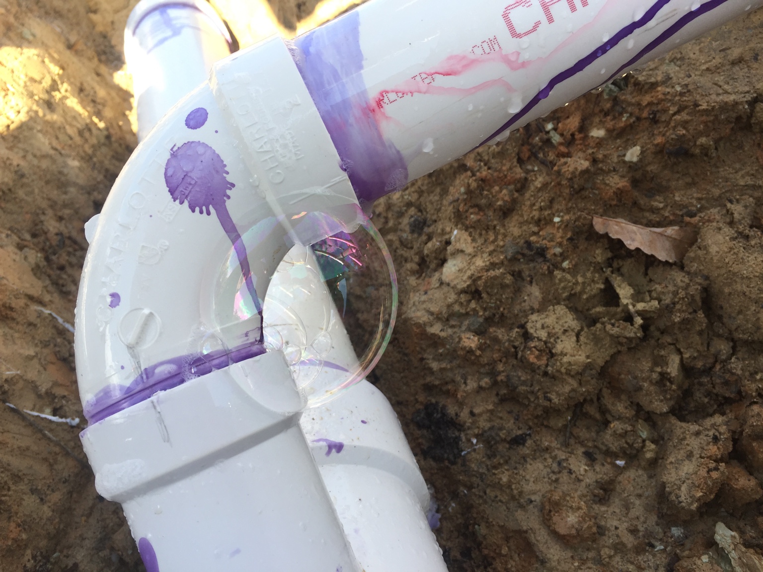

One d the two cleanouts that wouldn't seal
Replacing the elbow without destroying the rest of the line.

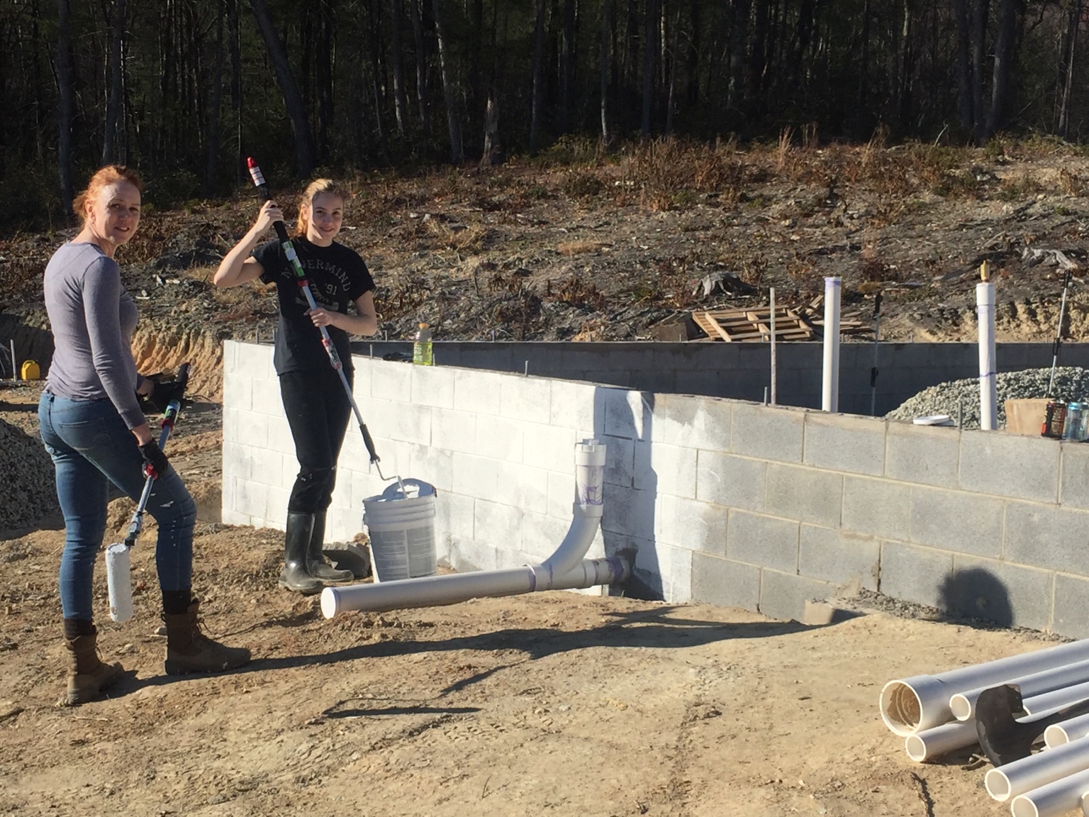

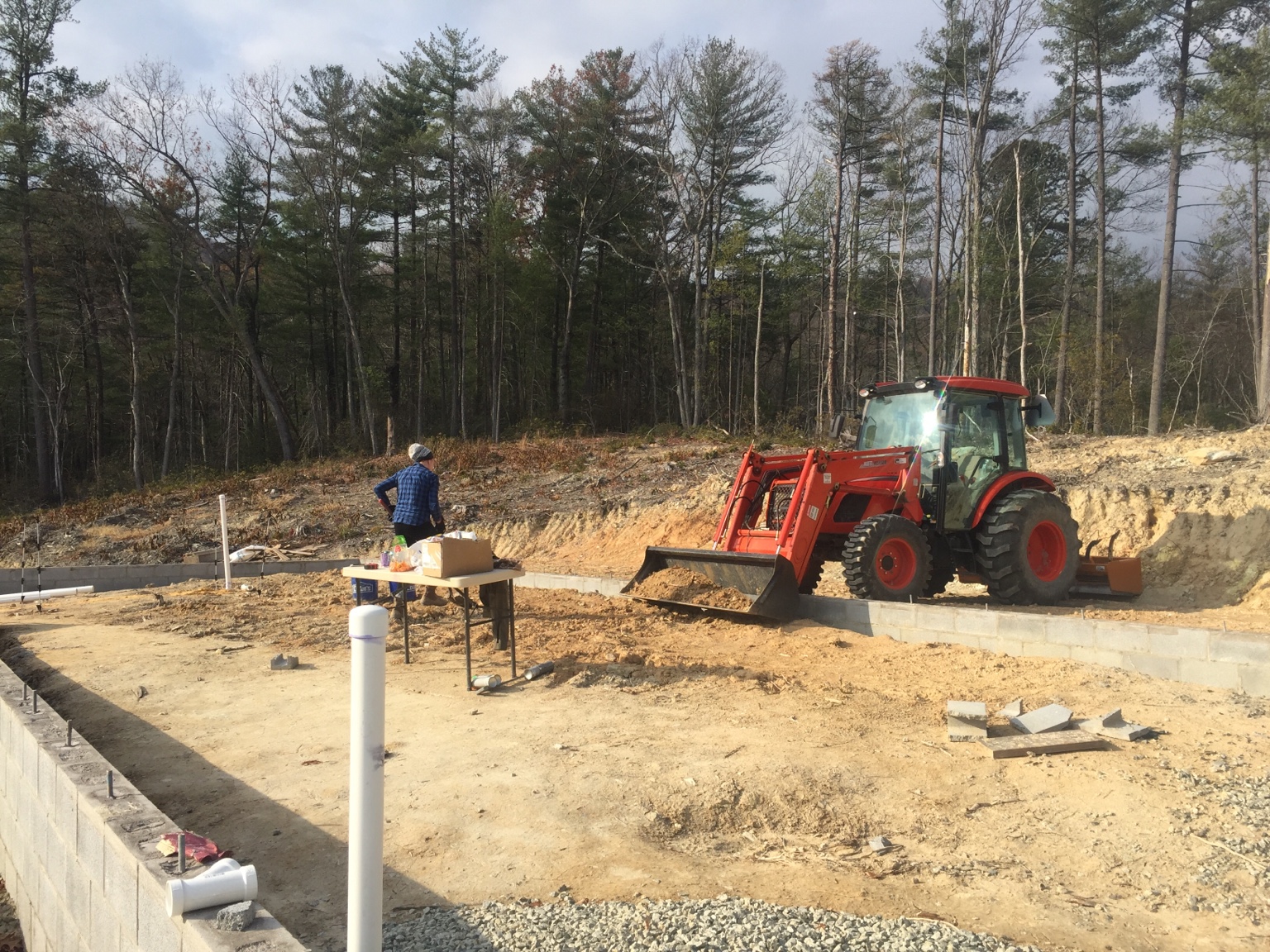

My bride clearing loosened dirt so we can get the needed depth for the insulation and the floorIMG_7957.JPG

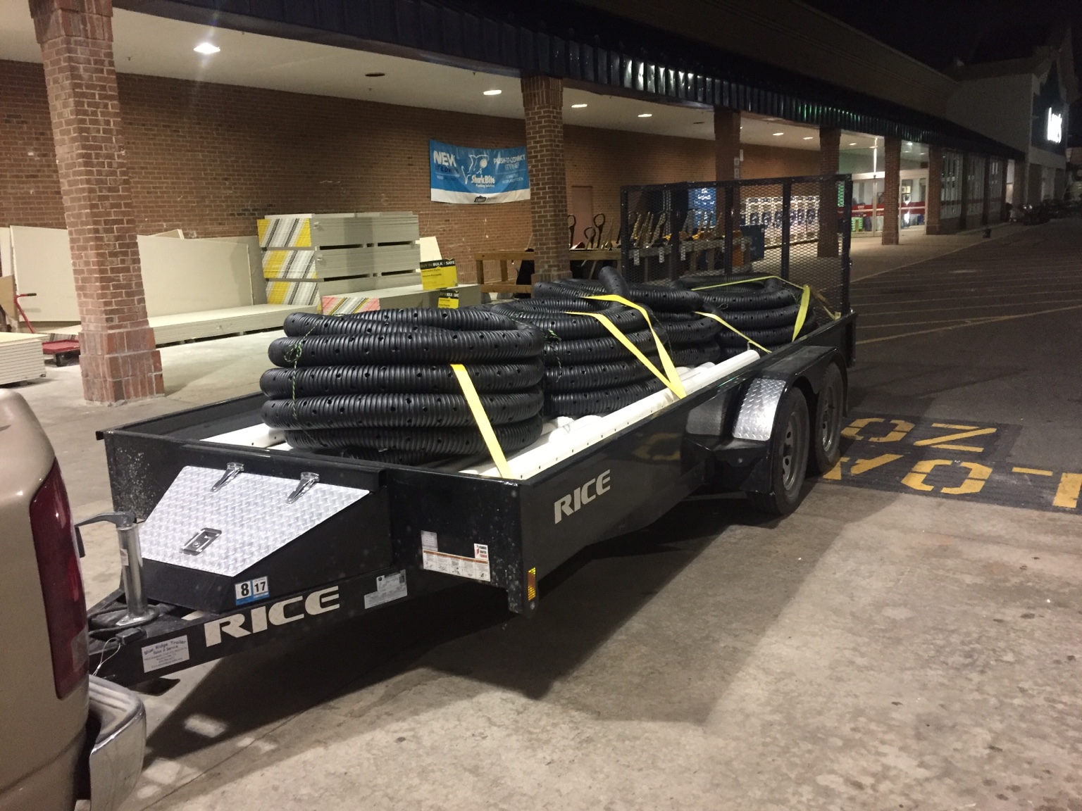

Picking up supplies for today's work.
Waterproofing the foundation.

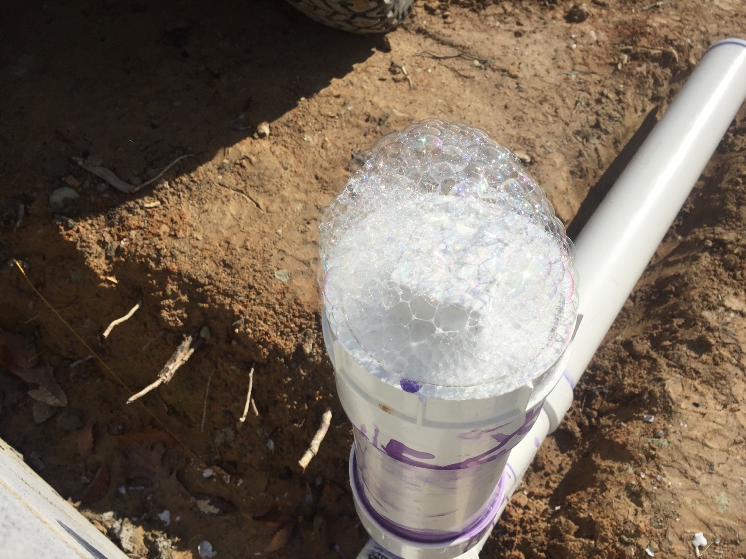

For any leaking PVC fitting, the best solution to try is to goop it up again and again with pipe cement. It will seal up after an application or two (or three..).

I forgot to mention, I pressurized both sides today and it holds fine. Looking forward to tomorrow and getting this monkey off my back.
