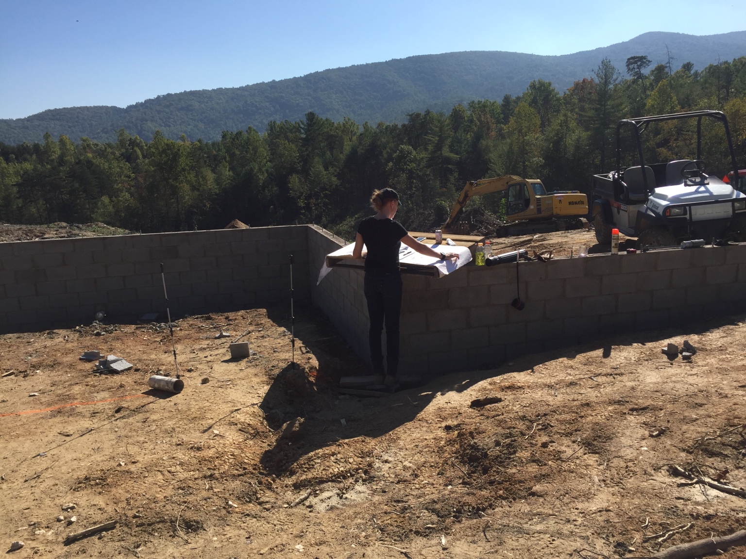

Good God that's a lot of work. Wouldn't it be easier to make forms and pour concrete for the footer? Why go cinder block?
Looks excellent, but I was thinking the same thing.

The footings were dug because they wanted to get down to where the stone begins. The block is the outer wall of the foundation and also is the base that our SIPS walls will sit on.

I agree it looks beautiful but that must have taken forever.
Block work took about 3 days and another day to fill. I can't say it has been particularly cheap but I found it to be reasonable block was specified by my architect. Perhaps we could have done poured walls. I'll have to investigate that for next time ( the barn or cidery)

The walls were filled and the anchor screws were set. 102 of them. That's a lot of holes to drill for the sill plates. I began laying out the plumbing for waste connections and ended up spending all of today changing the layout of the bathroom on the fly. I needed more room space for my boiler room. Wife and I came up with a layout that she likes and will give us the space we need. It requires me to move one three foot wall and reposition some drains.
