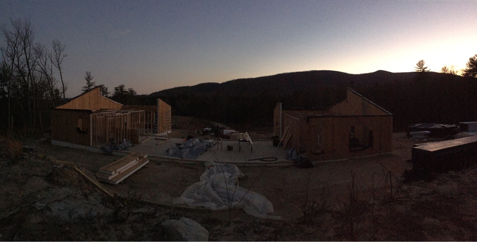

Ahh the sip instructions. Today, we were working on the walls in the master bedroom. Yesterday we got chased off the job by rain. There were still some puddles of water on the foundation, and the wind was 12 mph with heavy gusts. The plans got blown away into a puddle and were probably there for an hour when they were found. They basically dissolved when we tried to pick them up. We set them in the truck to dry and tonight, while most people were watching a football game, I was piecing them back together with tape. This is the less glamorous side of building. But we got 12 panels installed today there is nothing left to build for walls, that doesn’t involve the post and beam. I took this picture tonight as I was cleaning up to leave. The lighting wasn’t great.
   / My Industrial Cabin Build #660
12 panels is kind of a big deal - Congratulations! Can you get duplicate plans?
