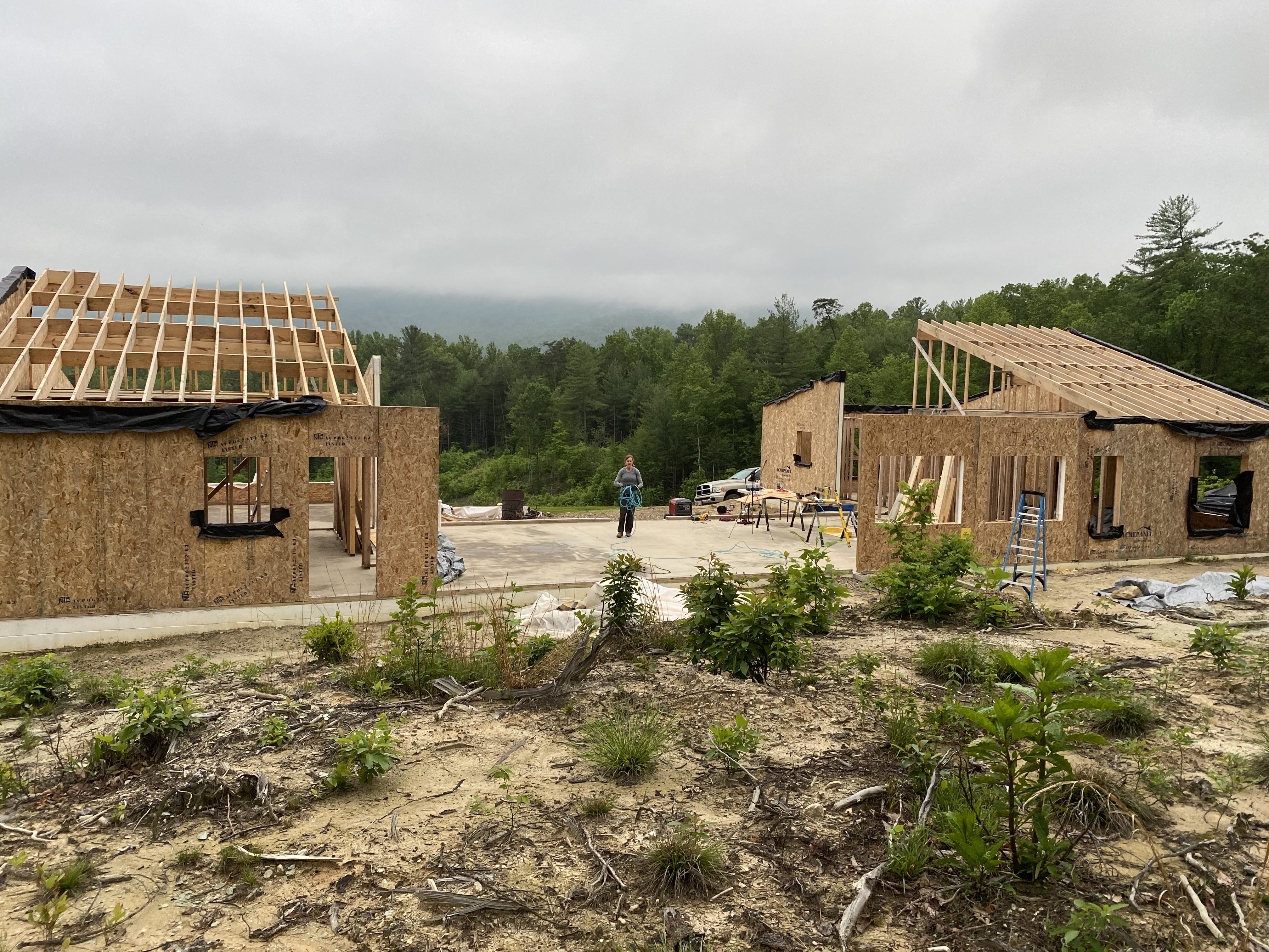

Eddie, I think it is different than a lot of people who build with Sips have ever dealt with. There mistakes along the way that have caused changes to plans and delays. If I had it to do over I would make a lot of changes in the way I did some things. I would trim almost every 2x spline that I put in to make it go easy. I would trim the foot plate all the way around to make it easier to get the panels down.
The post and beam is going to be an extra challenge because of mistakes made with the cement work. I should have been on it and caught the mistake but I didn’t have the experience to recognize the issue.
I ended up spending a lot more on timbers to fix the issue. This is where a professional would really shine.

Any thought to putting some sheathing up on those rafters just to help keep the rain off? Maybe set the sips roof right on top? Course that would create a half inch problem at the post beam center.

Woodchuck, I think your SIP manufacturer did not provide a very high quality product. I saw you deal with things I never had to. It is unfortunate you had to deal with over size, in square, and wrong cuts from the manufacturer.
There have been a few issues. I have been able to deal with all of them so far. I have no other experience with SIPs so I have nothing to compare to.

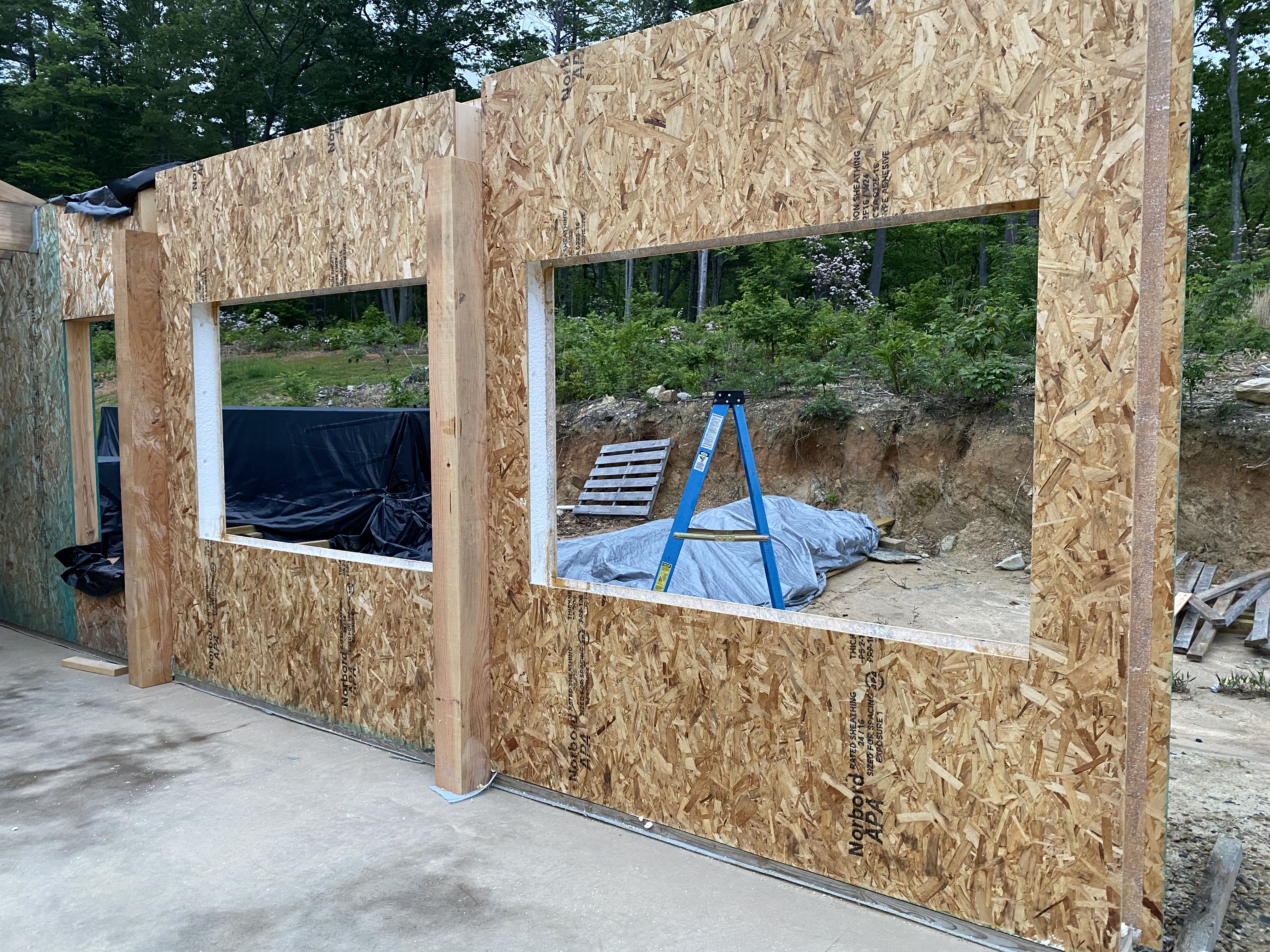

Saturday I cut the remaining threaded rods for the post and beam fasteners. 3/4 inch B7 steel. I used an angle grinder and a stack of cutoff wheels. Then We had to spray the orchard and didn’t get to the build till the afternoon. We ran into problems and didn’t get anything accomplished. Yesterday(sunday) I got back out there and we put up the first Fir post. We got two posts and two panels up. Im about to hit the hardware store then get back out there. I appreciate the encouragement from everyone. I’ll try to get another video edited and up in the next couple days. It does eat time.
Here is a little teaser from yesterday.
