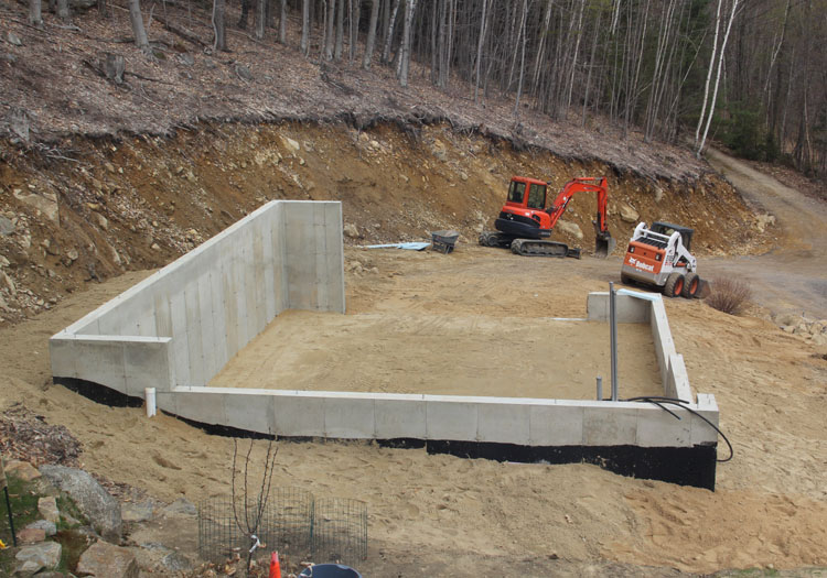

Lol..... Thanks Bill, you know the one thing NH has plenty of, it's Rocks!

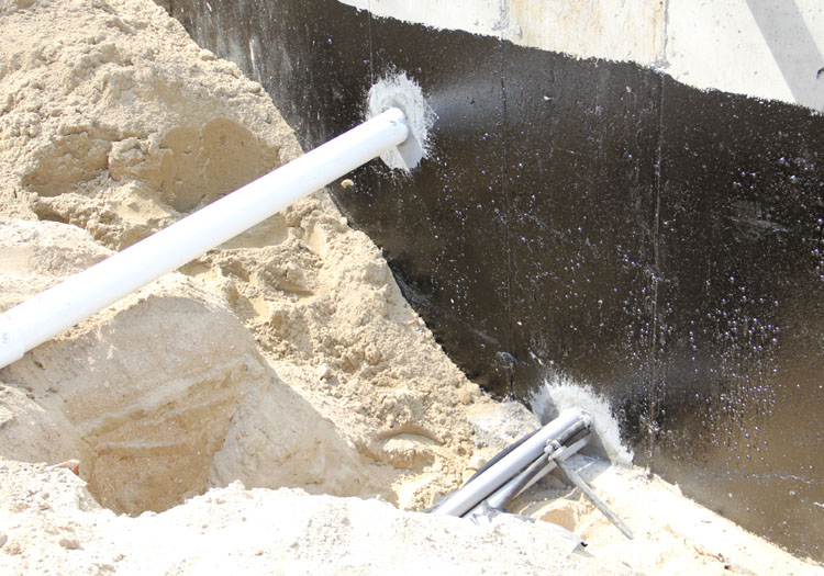

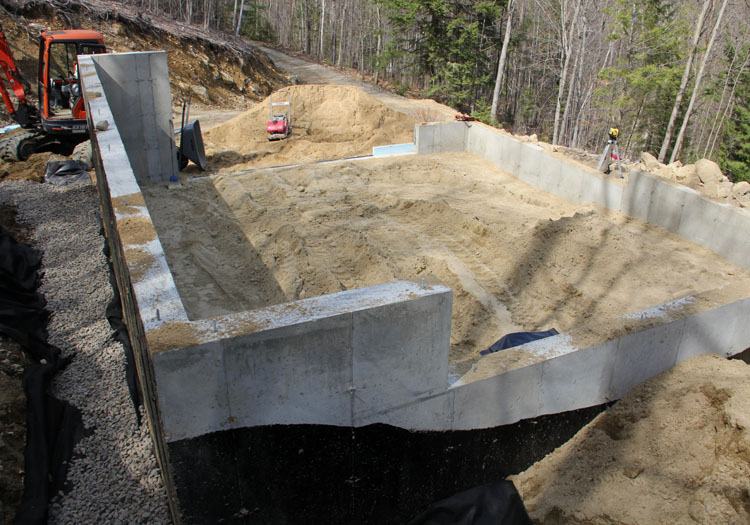

Here the latest pix.
Getting utilities inside.
Installing french drains on hill side.
All backfilled and ready for framing.
I plan on doing something with the hillside to prevent or slow down wash downs, I'm just not sure whether it'll be rip rock (4-6" crushed stone) or mulch. Either way, it won't be easy or cheap! :cool:

How many truckloads of sand did you have to bring in...
   / My new Garage/Barn project
#15
One more load coming for the right side, which will make 6 load of 16 yds. each. We were also able to take some material from the inside that we used against the hill.
But all together?? Not sure, I wasn't there when they were putting in the drive.
I will still have to have more ledge pack for all the driveway area after the trucks are gone to finish it off.

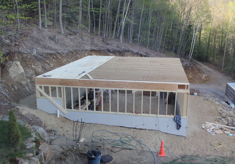

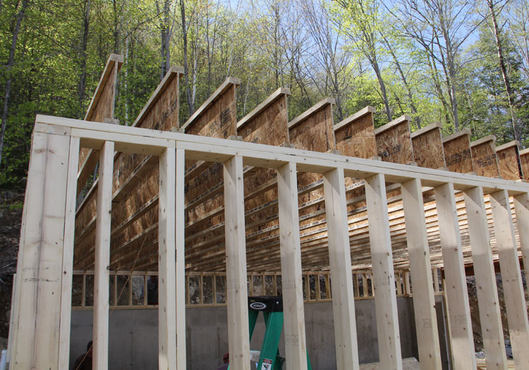

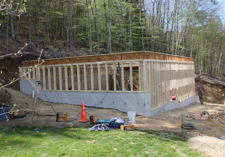

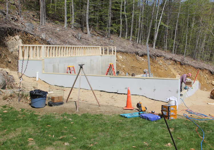

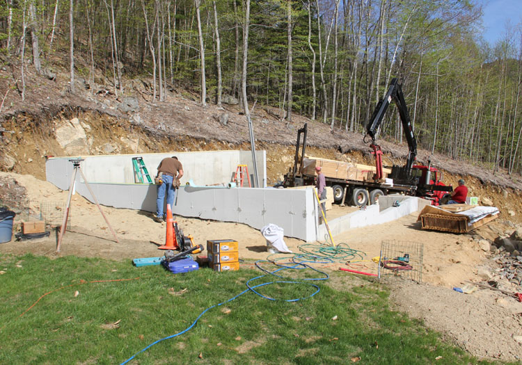

Well today was the first day of framing the new garage.
Materials delivered and work begun early.
Shots shown below are;
Working on 2X6 plates.
Started to put up walls.
All walls with I-Joists raised up.

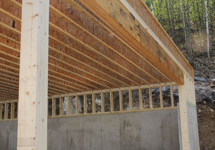

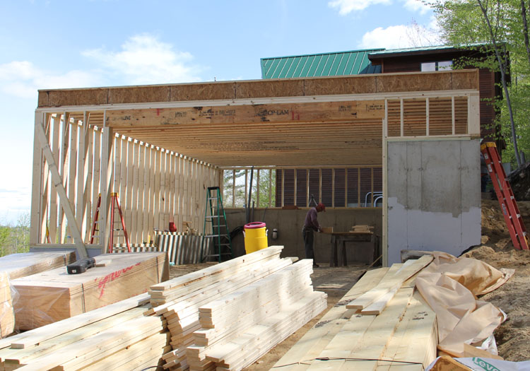

Next group of photos....
View from front door.
3 Lam beams over 8X16' door.
I- Joists 12" on ctr. over 2X6's
What got done today.
Not a bad days work. :)

What size I-joist are you using .........do you know what the floor rating is (PSF).....
What do you use for the end of the I-joists to tie them together....?...OSB...?......
Sorry for questions.....Thanx for the pix
