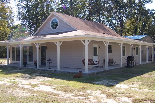

Brandi,
This is a house that I built last year for a client. It's done in Hardi siding that I painted, but could easily be stained to look like wood. Same with the posts and trim.
