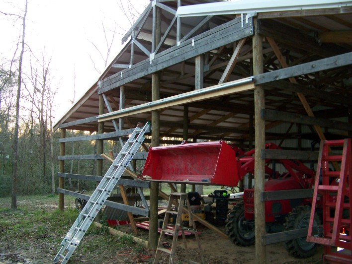

Thanks! Today I got the flashing up over the door rails.:)

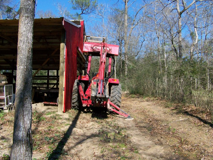

I went ahead and worked on the back door header and tracks today. I did this because it takes two folks to join two rails with the track rail splice. One to hammer it home and the other to squeeze the other rail end. Luke gave me a hand and it popped right it like a glove. I removed the 2x6s at 8 and 10 feet and added doubled up 2x8s at the 10 foot level. I only have 20 feet from the barn to the back fence,so it is hard to get the Big RED Beast back there and the bucket square to the barn as a work platform. So I will need to rig up a platform in the bucket and support it with chains from the bucket hooks. Then I will be able to park the tractor beside the barn and work from one side of the bucket platform.
hugs, Brandi

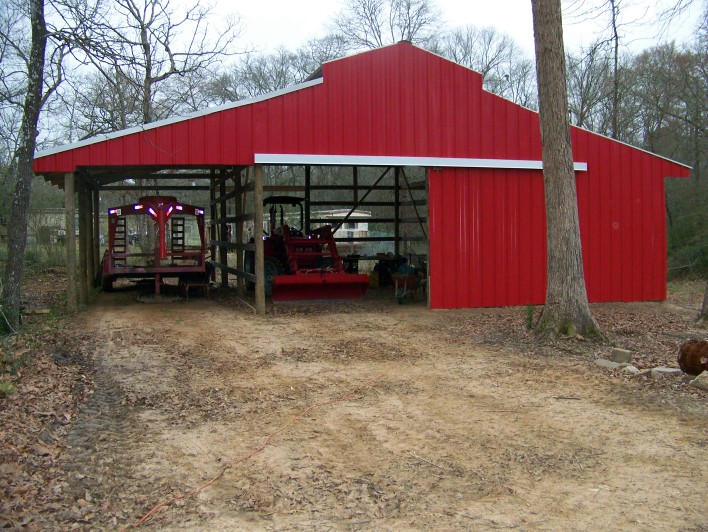

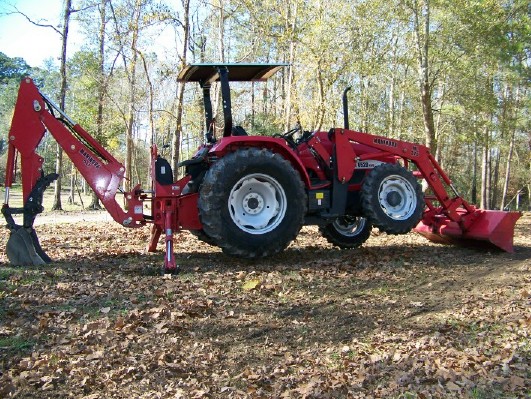

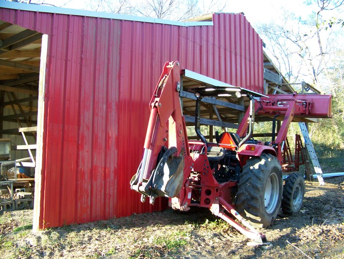

I built a platform for my FEL bucket to work off of.;) It is described at http://www.tractorbynet.com/forums/showthread.php?p=1339997#post1339997
I now have almost all the upper roof metal installed.:cool: It has been fun and I am sore all over. Now I go back to work and rest for a couple of days!:)
hugs, Brandi
