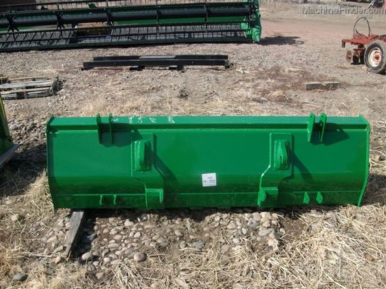

Here is another picture of the grapple brackets on the global 85" bucket:
Thanks. Those extra brackets look like they could be useful to various pulling/chain connection points. I have asked the dealer to pull one for me to look at next to the 73 incher.
