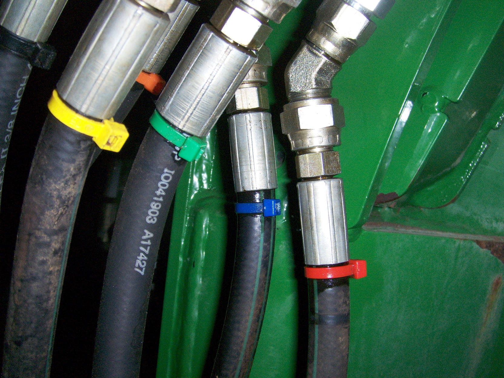

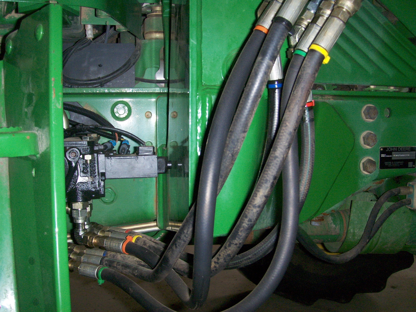

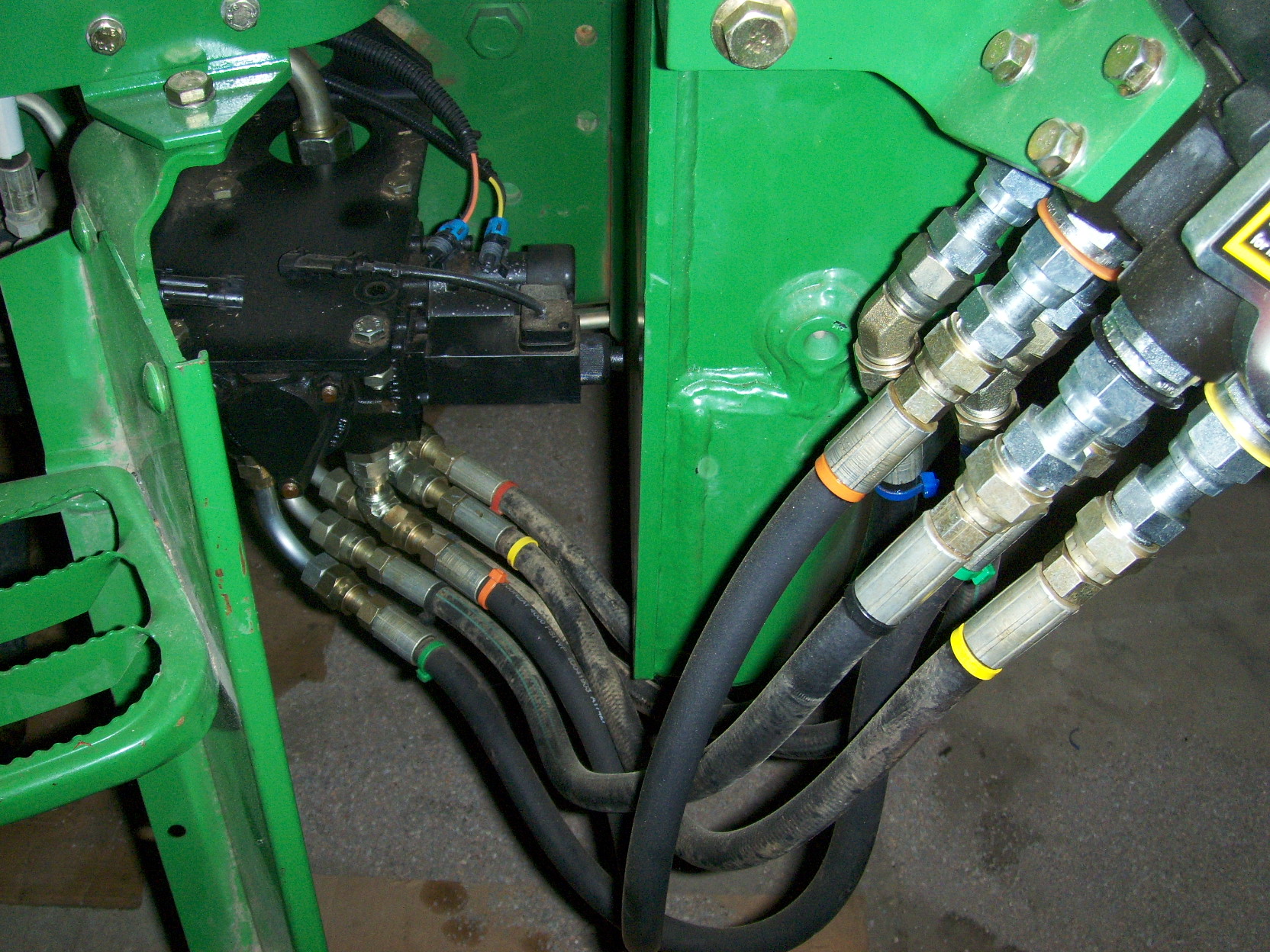

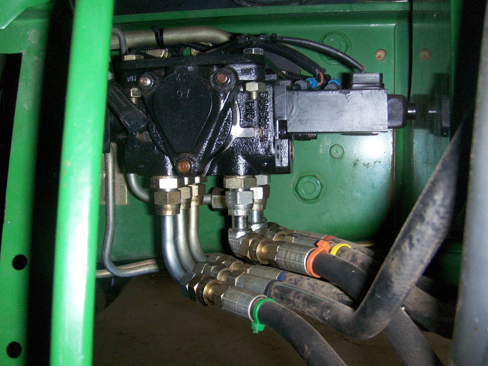

Here are pictures of the hoses from the mid valve to the multicoupler. There were two big wide tie wraps on the hoses. I cut them off when I swapped from quick couplers to the multicoupler. I have not bought replacement large tie wraps yet. The boom hoses were too tight so I added some 45 degree fittings to make them longer (cheaper than new hoses) I also had to adapt from JIC to ORFS. My hoses were JIC, the multicoupler is ORFS. This is not as clean/simple as I would have liked, but I did not want to buy 12 new hoses.
I been working on an idea for a different bracket for the multicoupler to turn it 90 degrees, like yours is. Then it will stick out almost 6" less.
