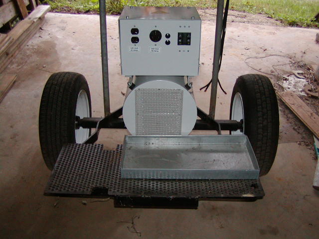

One thing I failed to mention about storage, which I thought to be important.
I was afraid the air vents, both front & rear, had large enough holes that dirt dobbers might be able to get through and I could just see, the first time I went to use it, all air passages would be stopped up, so before I put it in the barn for the first time, I covered the vents with smaller mesh wire.
I also cover the control head with a black plastic trash bag & tuck in around the bottom to keep the receptacles clean.

Yep, Neal, aren't the mud daubers fun in Texas? /forums/images/graemlins/wink.gif Lots of RV generator and air-conditioner problems are caused by mud daubers. And when I didn't drive my old 3/4 ton truck for a couple of weeks, I found that the automatic choke didn't work; raised the hood and found a mud dauber nest on the linkage that was blocking it, more mud dauber nests inside the air filter housing, etc. Your screens are a very good idea.
