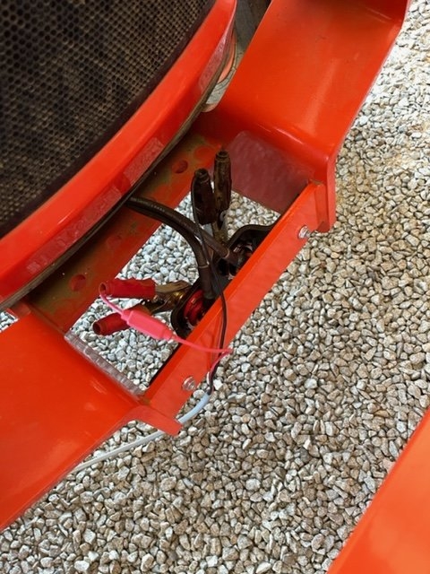

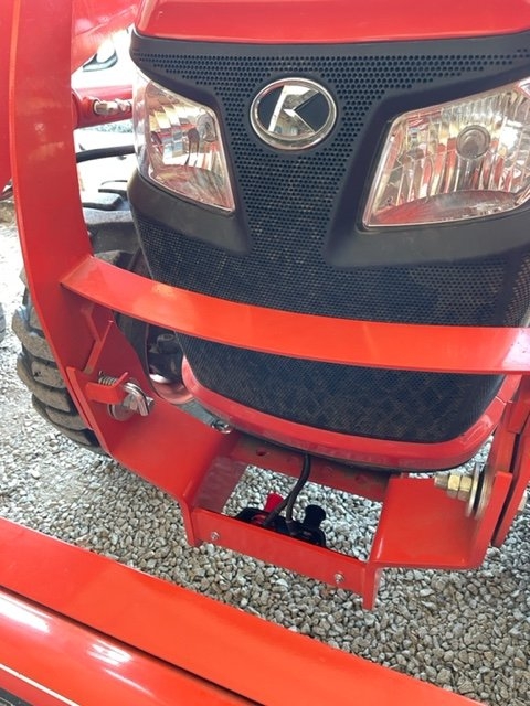

I found these on Amazon for my Kubota MX.
   / Need 12Volt Terminals For Front Of Tractor
#14
scootr - That's a good set-up for jumping or providing power. Did you make the bracket for the posts?

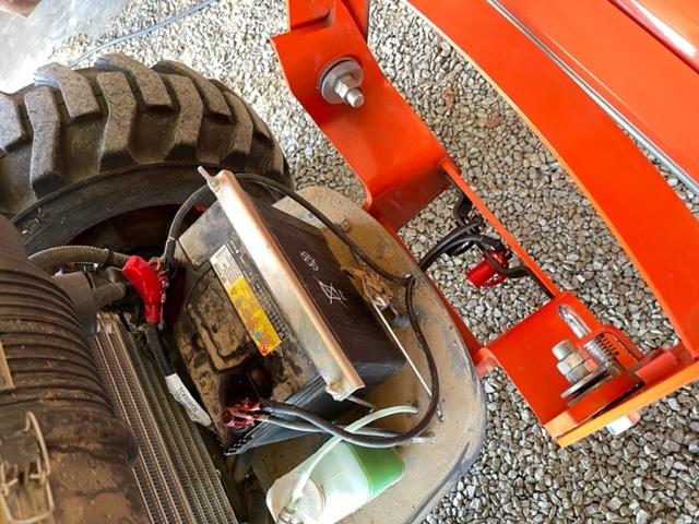

I recently put a winch on front of my Deere 3038e and use it a lot since. It has a remote control. Since Deere battery is in front leads winch to battery are only about 3ft long (guessing). It came with heavy wire, about 2 gauge and I put a 50 amp fuse right at battery + positive. I connect a charger or maintainer at winch terminals.
If I ever had to jump start it I'd connect directly to battery.
The bracket was there, part of the engine guard. The idea was to have a 12v supply for a fueling operation but in the picture there is a battery charger attached... a benefit I didn't consider.

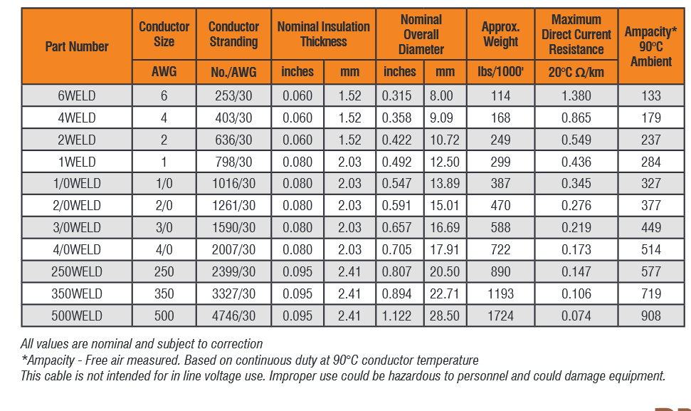

Some advertised information on jumper cables seems to be a bit optimistic. As an electrichicken, I''m aware that the rated ampacity of a conductor may be exceeded (in some cases quite a bit) for short durations without damage. But there's also at least some concern about voltage drop due to higher current. Then the connection needs to be considered. Many of the clothespin type of ends found on jumpers make very limited and not necessarily tight contact with the battery terminals. In any case, I can't help doing a bit of an eyeroll when a #1 cable is touted as handling 800A.
Here's a chart from a company called PriorityWire and Cable listing various sizes and ampacities of copper welding cable. These ratings differ from the "building wire" used for normal wiring. For example, #2 welding cable rating on the chart is 237A. For #2 that would be installed as part of regular electrical work, it would be rated between 90A and 130A (depending upon the insulation type).
