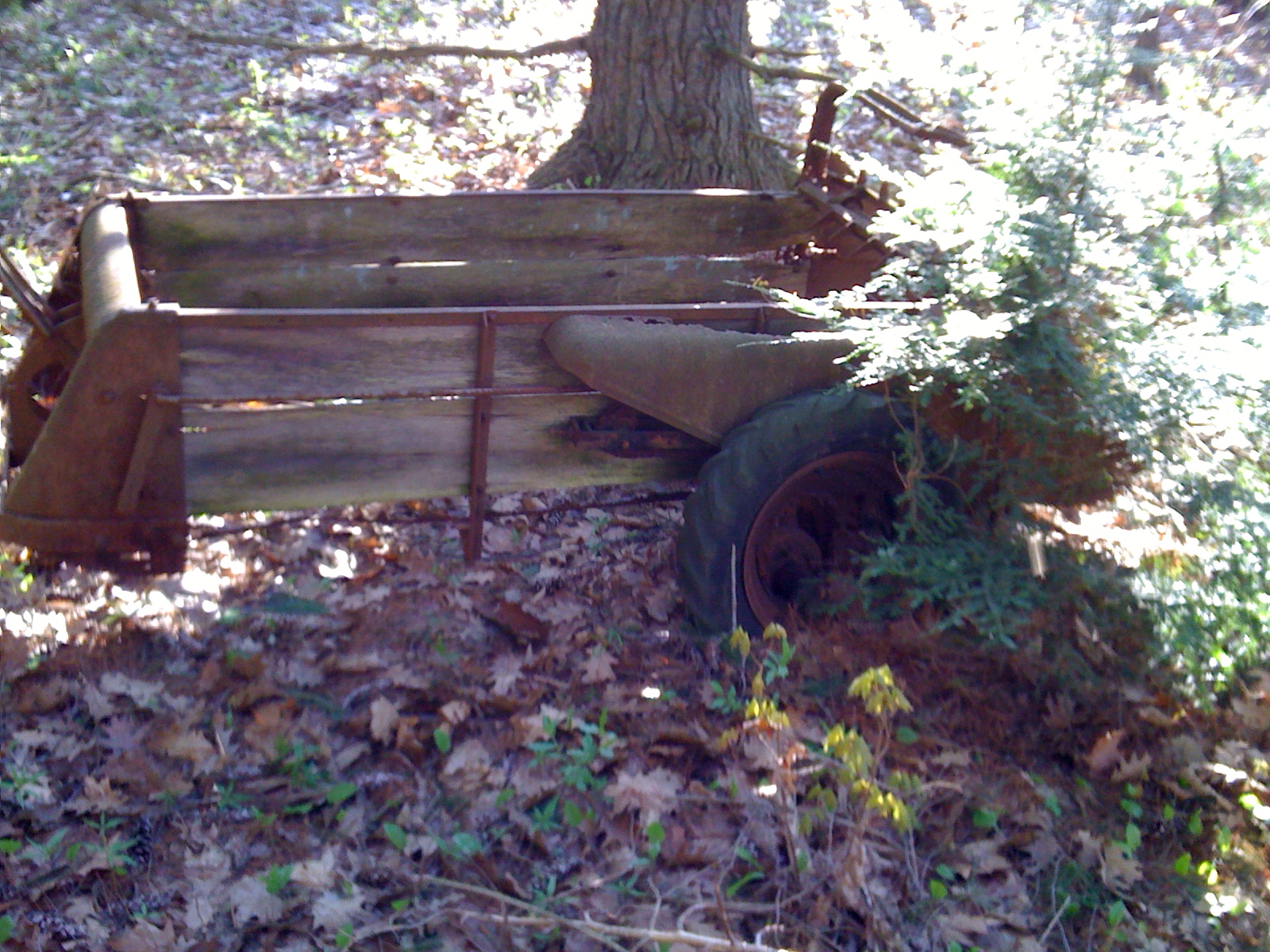

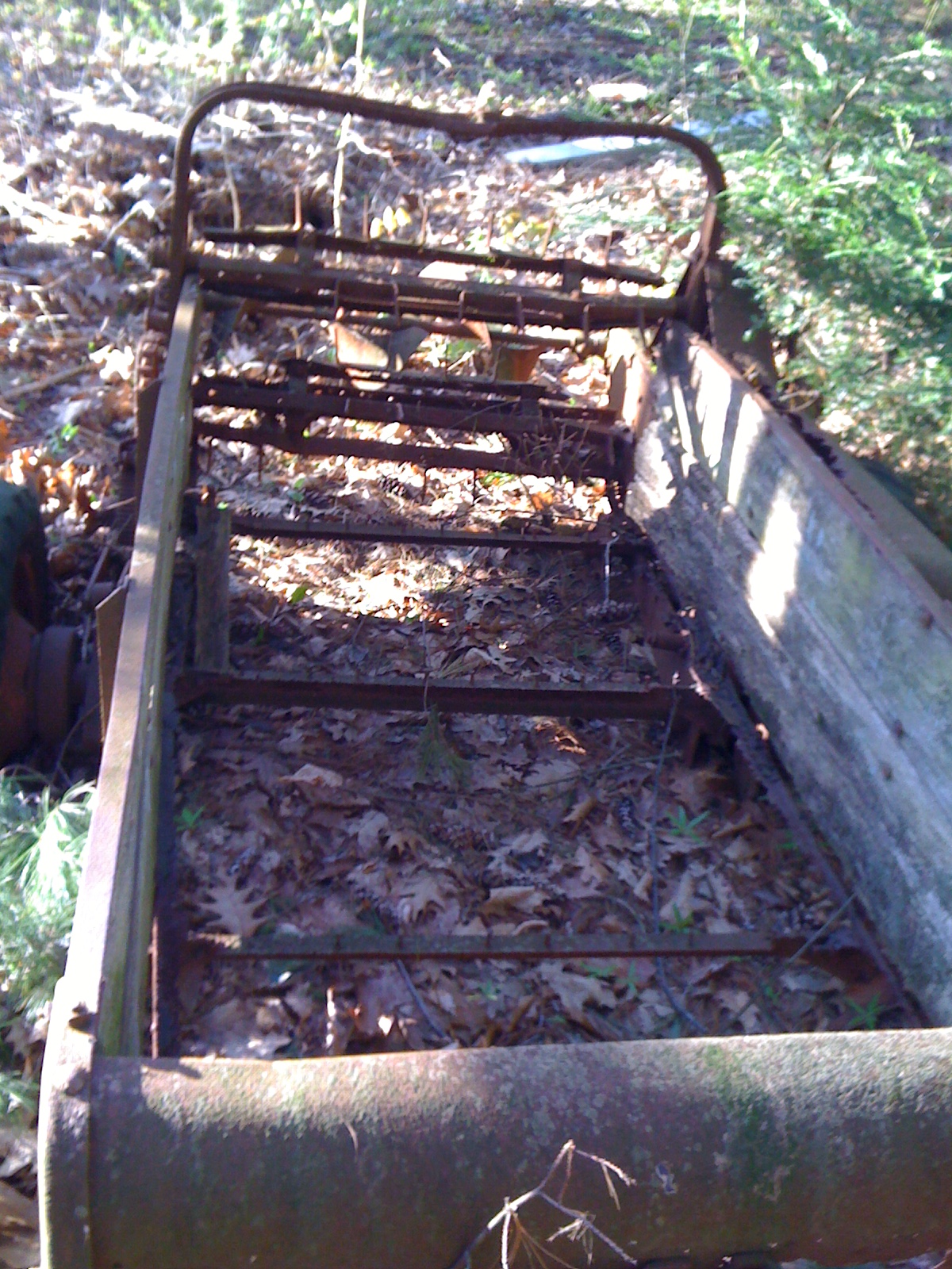

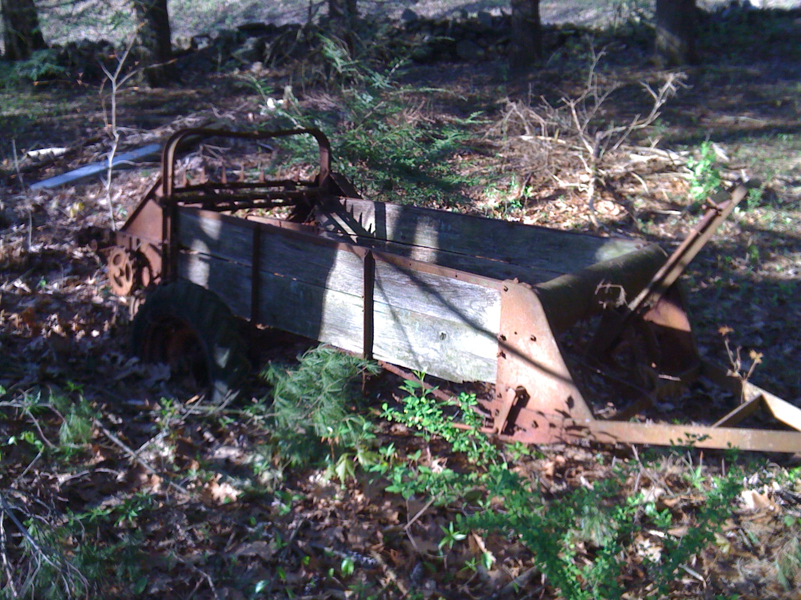

Started this in Wanted but I think it will belong here. Another project.
Re: Wanted small manure spreader
Got some pictures. I can probably get it for nothing. It is a McCormick Deering 100 that has had the metal sides replaced. It would certainly be a project.
I want to use it to lay down 400cy of chips on a walking trail. Probably don't need the beaters, the apron chains are missing but may be available $300-500
Wheels are gone . Can use a hyd motor to run the apron chains. Has possibilities but only if I can get it for nothing.

If you need new apron chain, here is a link to Shoup parts. Shoup Manufacturing Company I got new chain for my little Cobey spreader there about 7 or 8 years ago. I just bought the detachable link chain, and made up my own. If the cross bars are there, they even have the attachment links for those, and rivets. I just heated the rivets with my O/A torch, and hammered them out flat.
I believe I would go ahead and chain up at least the top and bottom beaters, and use the ground drive. That little bit of spreading action may save a lot of handwork, as it may just drop it out in piles.
Or..., maybe check on Craigslist.. Around here there are more than several useable small spreaders of that size in the $400.00 to $600.00 range. Some larger ones in the $800.00 range... Of course..., that's not saying they don't need new apron chains either...

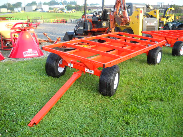

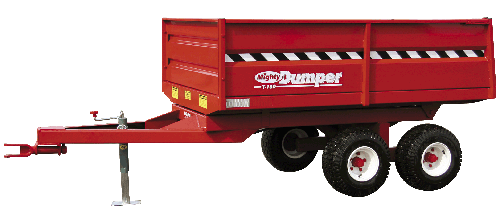

I think I am going to give up on a spreader. Old ones need too much work and there are not many farm equipment auctions in SE NY where there might be a newer one. Not many equipment dealers around here with trade in's either. So I am now looking towards a dump wagon. I can make it work somehow.
Does any one here have any experience with any of the equipment in the attachments. Probably looking for a 4' x 8' box with 1.5 -2 ft sides 3000-4000 lb load capacity. yard and 1/2 dirt or 2 yards of chips. What works better double tandem wheels kind of in the middle or wheels at each corner with the front axle steerable. This would be low speed , woods roads.
The mighty dumper is built by John B M Manufacturing
The farm M is by Country manufacturing
Kory is Kory They don't make a dump body but the running gear looks good.
Any body have any experience with any of these.
I would be towing with a NH TC 34 Hydro .

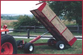

I have been trying to find a 2 ton off the road dump wagon. I find 3000# and 5000# . The 3000# looks about the right size 48-50" wide 70-80 " long
12-18 high sides. I mostly want to move wood chips. Make the sides higher. The tree guys found me and I can get all I want. Trails 5-6 ' wide in solid woods.
So Pronovost has one , no cylinder , $3070 list local dealer. There is another one Mighty dumper John B M mfg. Dealers are 60-70 miles away and it is also Canadian as is Pronovost. Probably same price. I keep looking. King Kutter at TSC same thing $1800 with cylinder and hand pump. hmm say welds brake or brackets bend. I can fix them. I don't need the hand pump, maybe I can get it with out. Probably not. I may have a hand pump for sale.
1st picture is Pronovost then KK
The $1800 was last year
