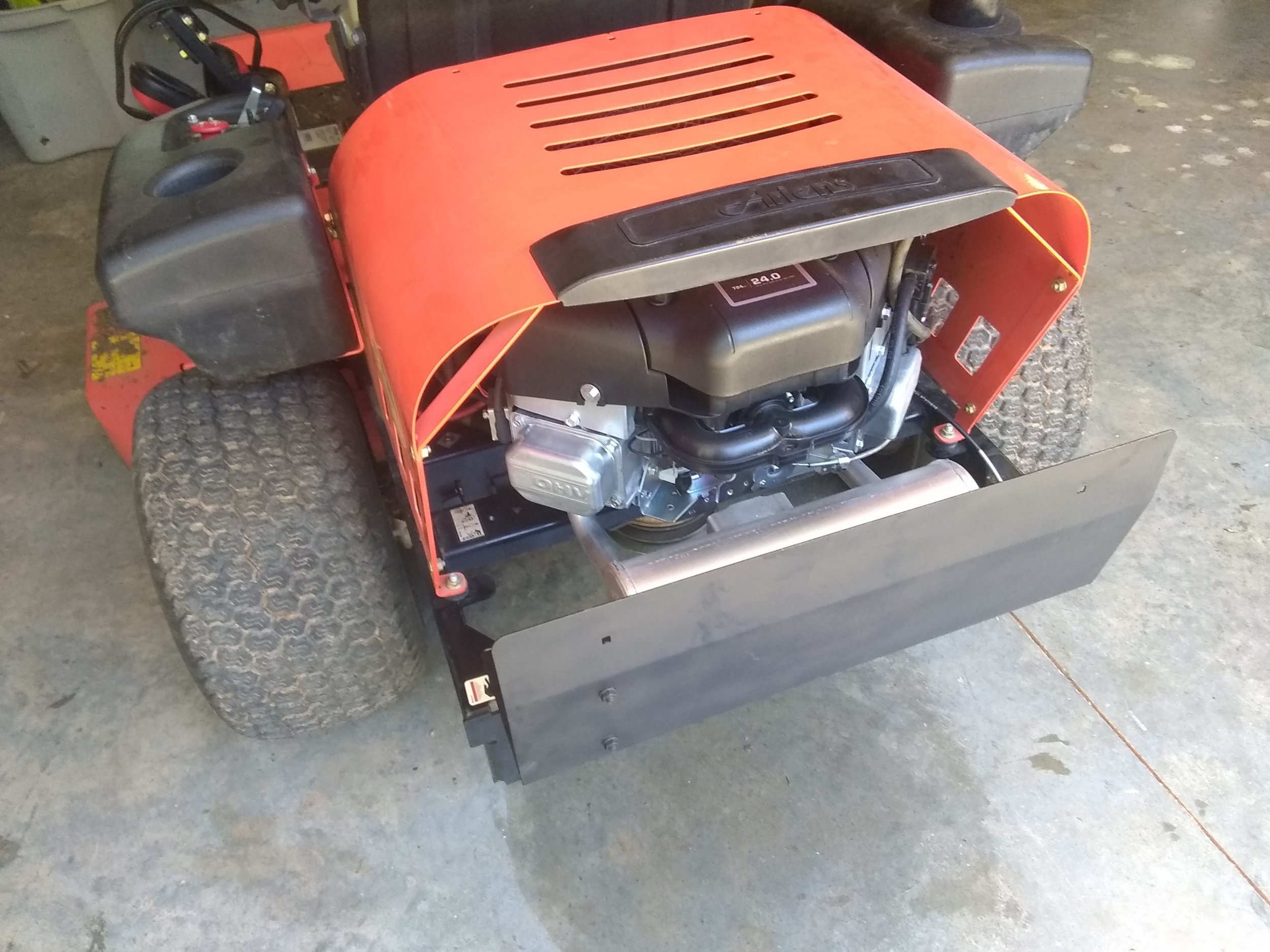

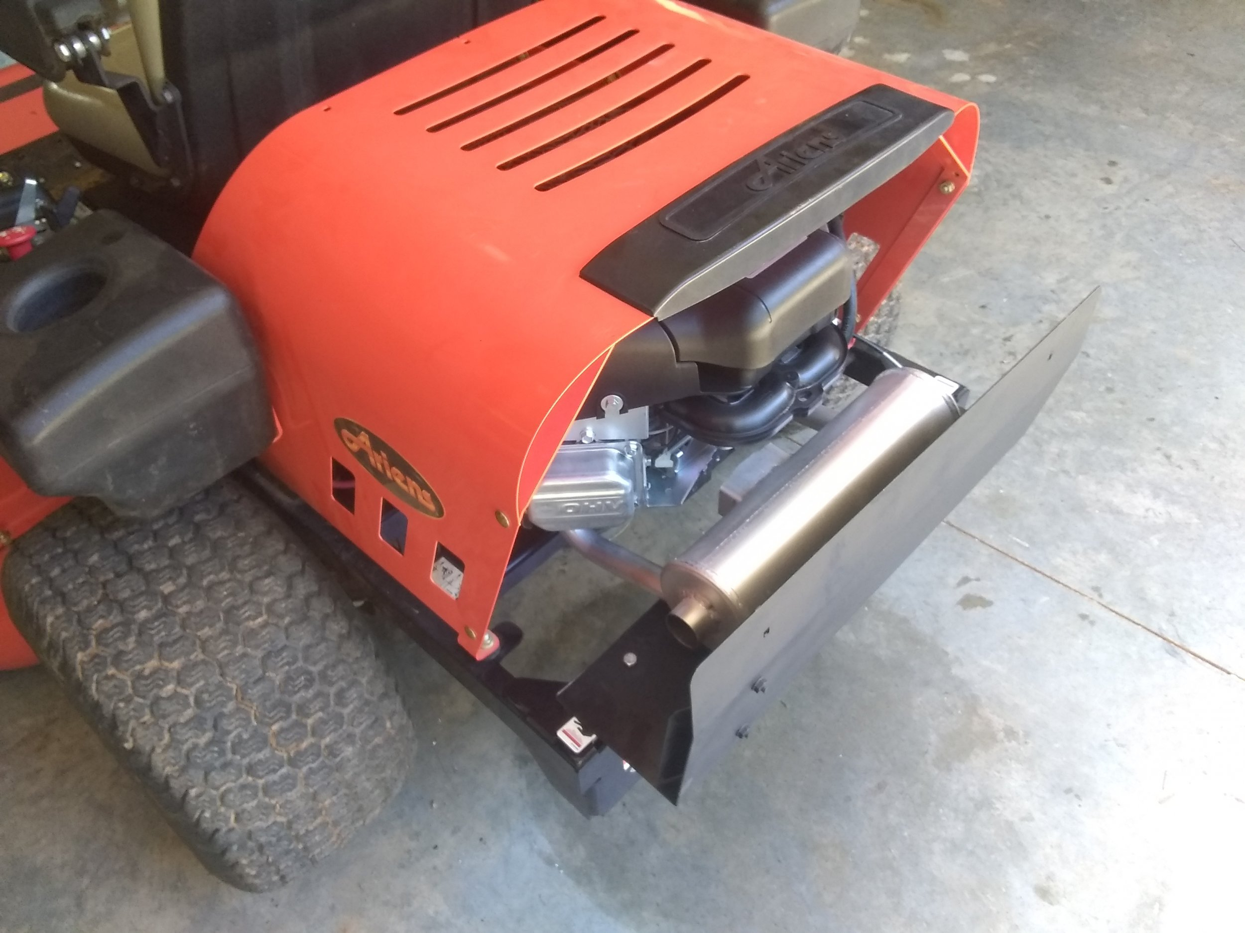

The bottom skid plate from the Kohler muffler setup provided the needed materials for the Briggs muffler heat guard. Won't put up much of a fight if it backs into something, but will work fine to keep hands and knees away from the muffler when hot.
