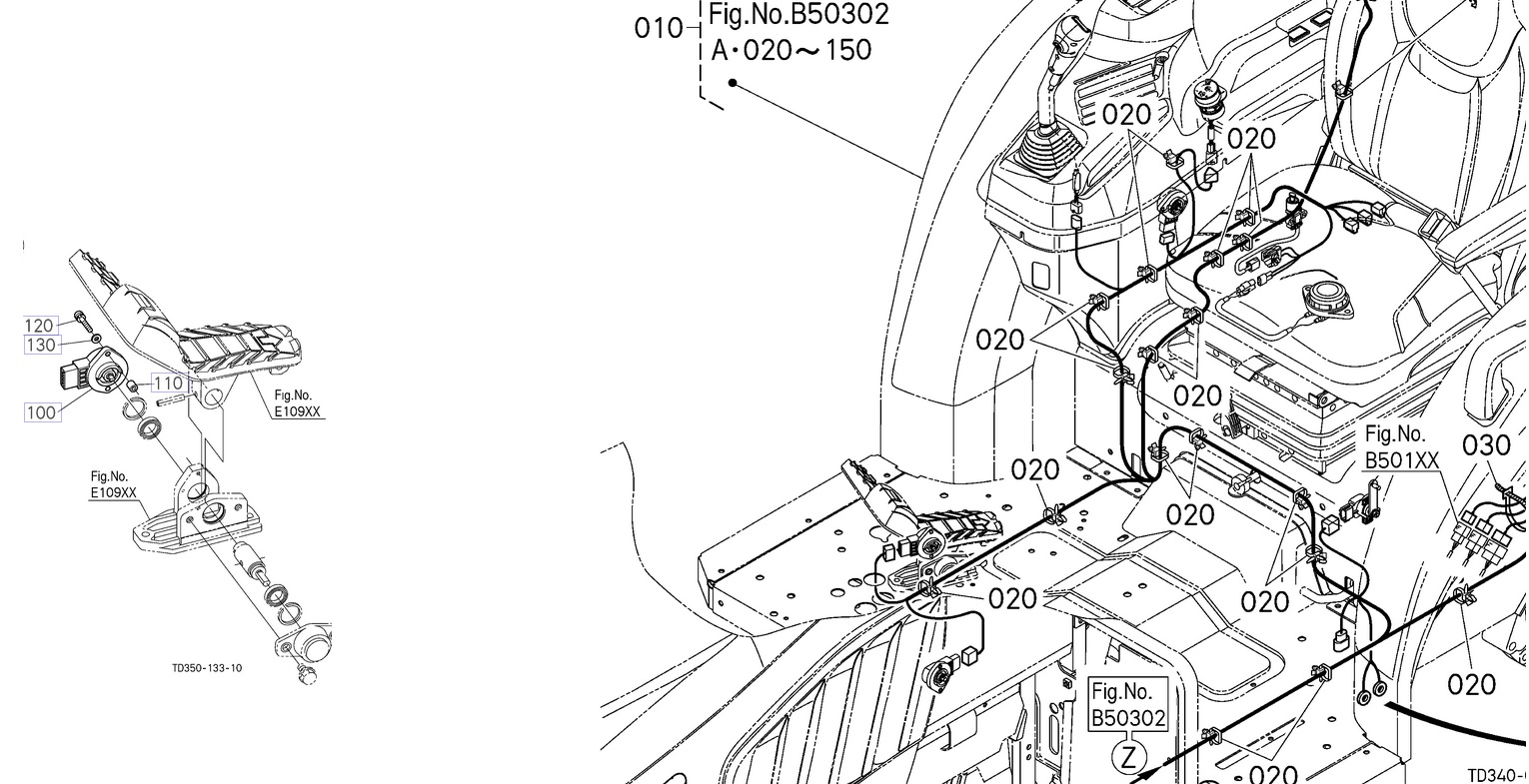

If you are running the engine at pto speeds the shuttle is going to be very abrupt and really rough without the clutch, the engine needs to be running pretty slow to smoothly change direction. The HST pedal on the 60 series is light and easy to work i am sure it could run it with a stick if need be. Unless i am completely reading the parts diagram wrong it looks like the hst pedal just uses a electronic sensor so you may be able to relocate it anywhere you want in the cab as long as you can run wires. There is a plunger the goes through the floor but seems to only connect to the auto throttle advance cam, maybe it would work without this? hst pedal.jpg. I am only guessing though from quickly looking at the parts, worth taking a look at.

If you are running the engine at pto speeds the shuttle is going to be very abrupt and really rough without the clutch, the engine needs to be running pretty slow to smoothly change direction. The HST pedal on the 60 series is light and easy to work i am sure it could run it with a stick if need be. Unless i am completely reading the parts diagram wrong it looks like the hst pedal just uses a electronic sensor so you may be able to relocate it anywhere you want in the cab as long as you can run wires. There is a plunger the goes through the floor but seems to only connect to the auto throttle advance cam, maybe it would work without this? View attachment 385691. I am only guessing though from quickly looking at the parts, worth taking a look at.
That looks like the Kubota L6060 uses a rotary potentiometer to tell the HST controller user movement request and that would be reasonably easy to relocate.
bmhibinger should share how he would like to work the controls as there are aftermarket joystick handles that can use a variable potentiometer that could control HST movement straight from the joystick lever leaving the lefthand free to steer.

I looked through the HST control system of the Kioti NX series and it literally is as easy as moving an electric sensor up so the hand can control it. In fact, the very same sensor that sets the throttle speed is used to determine HST pedal position.
