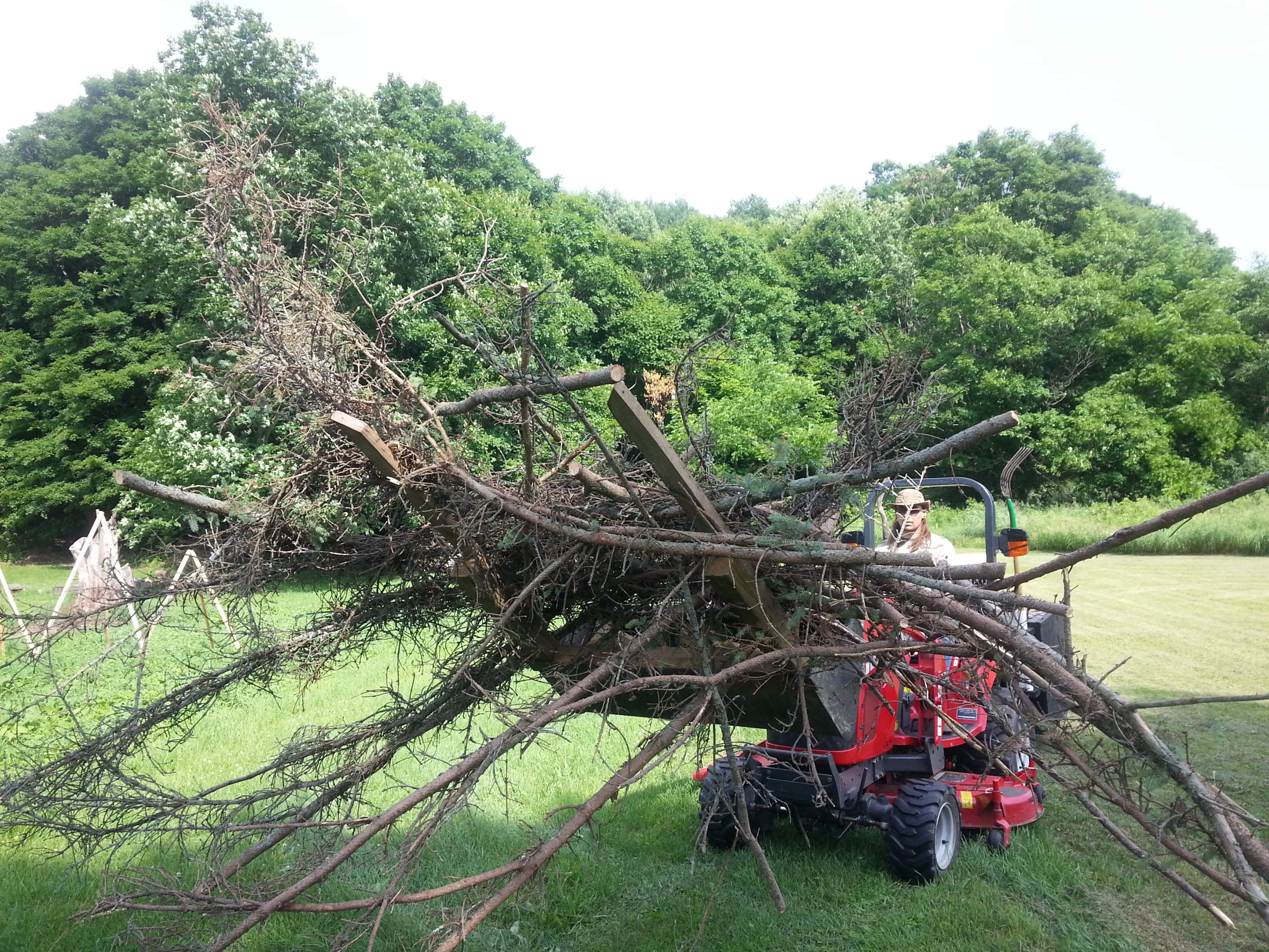

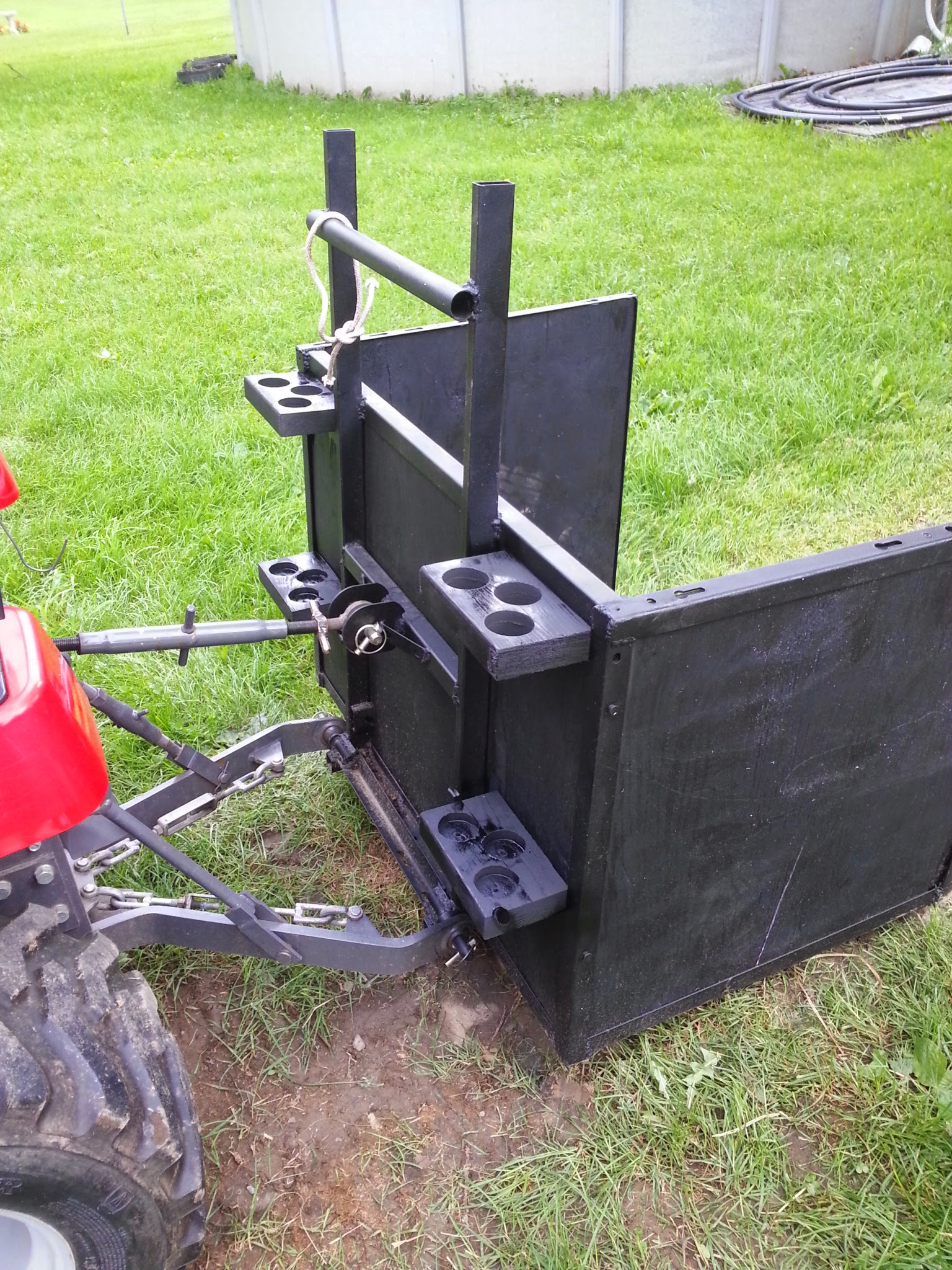

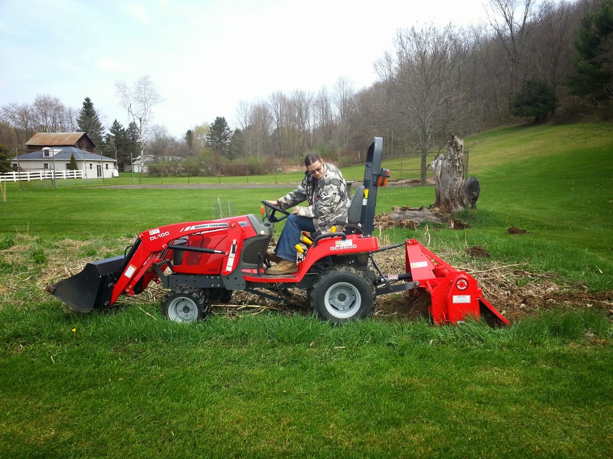

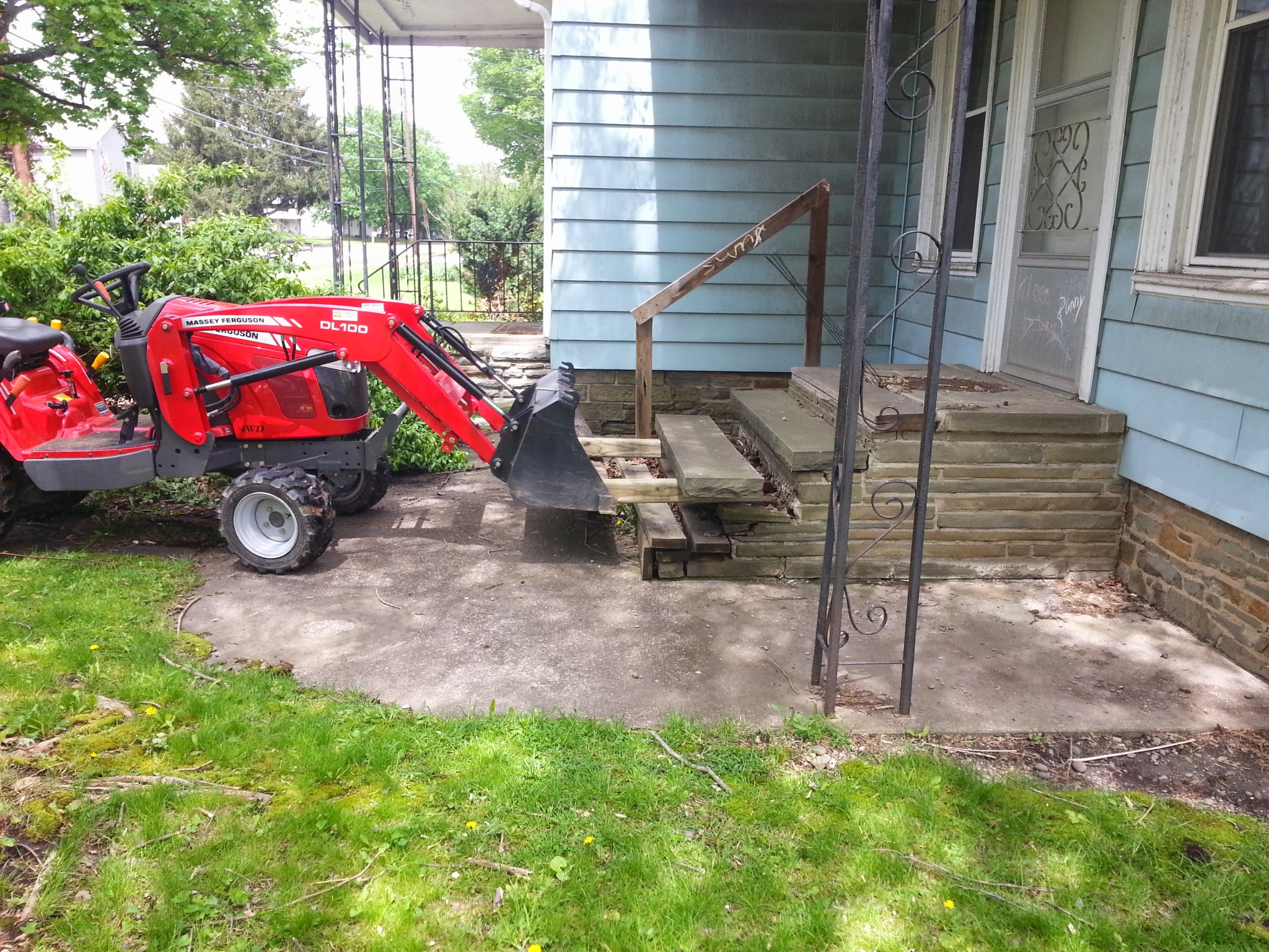

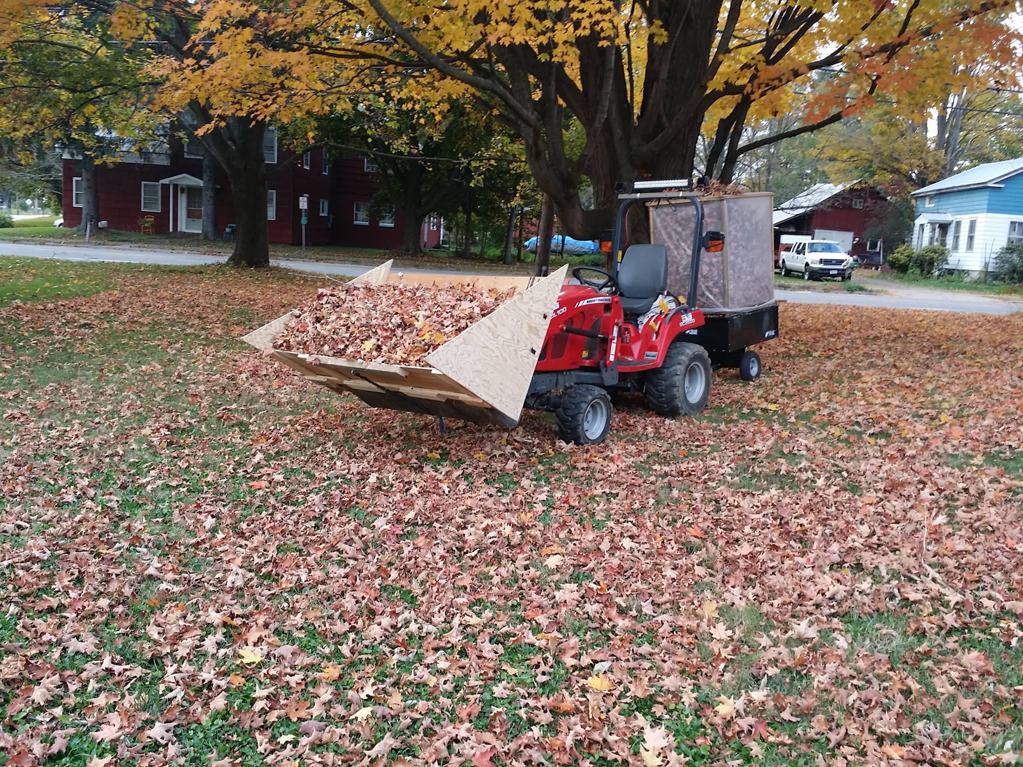

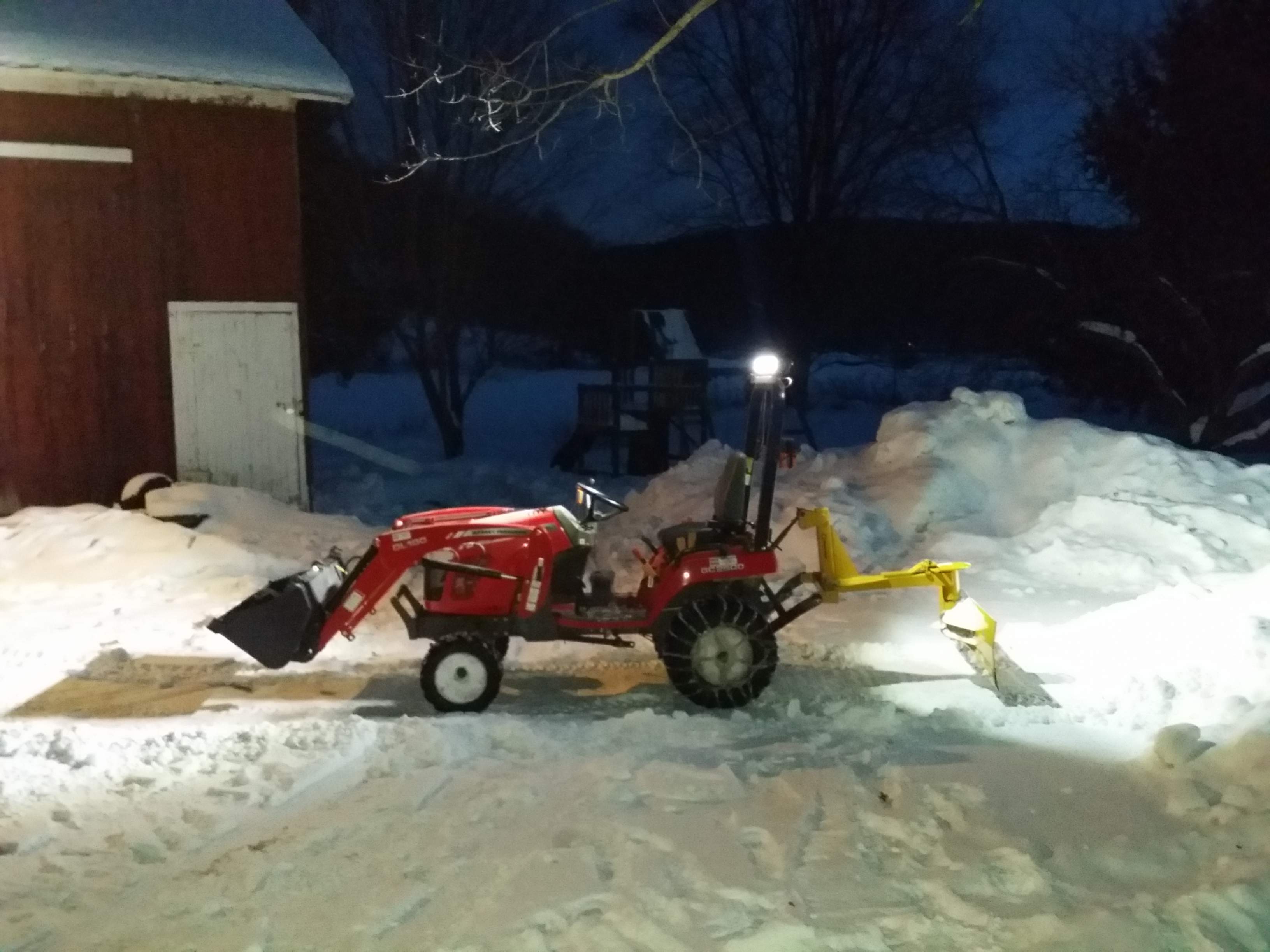

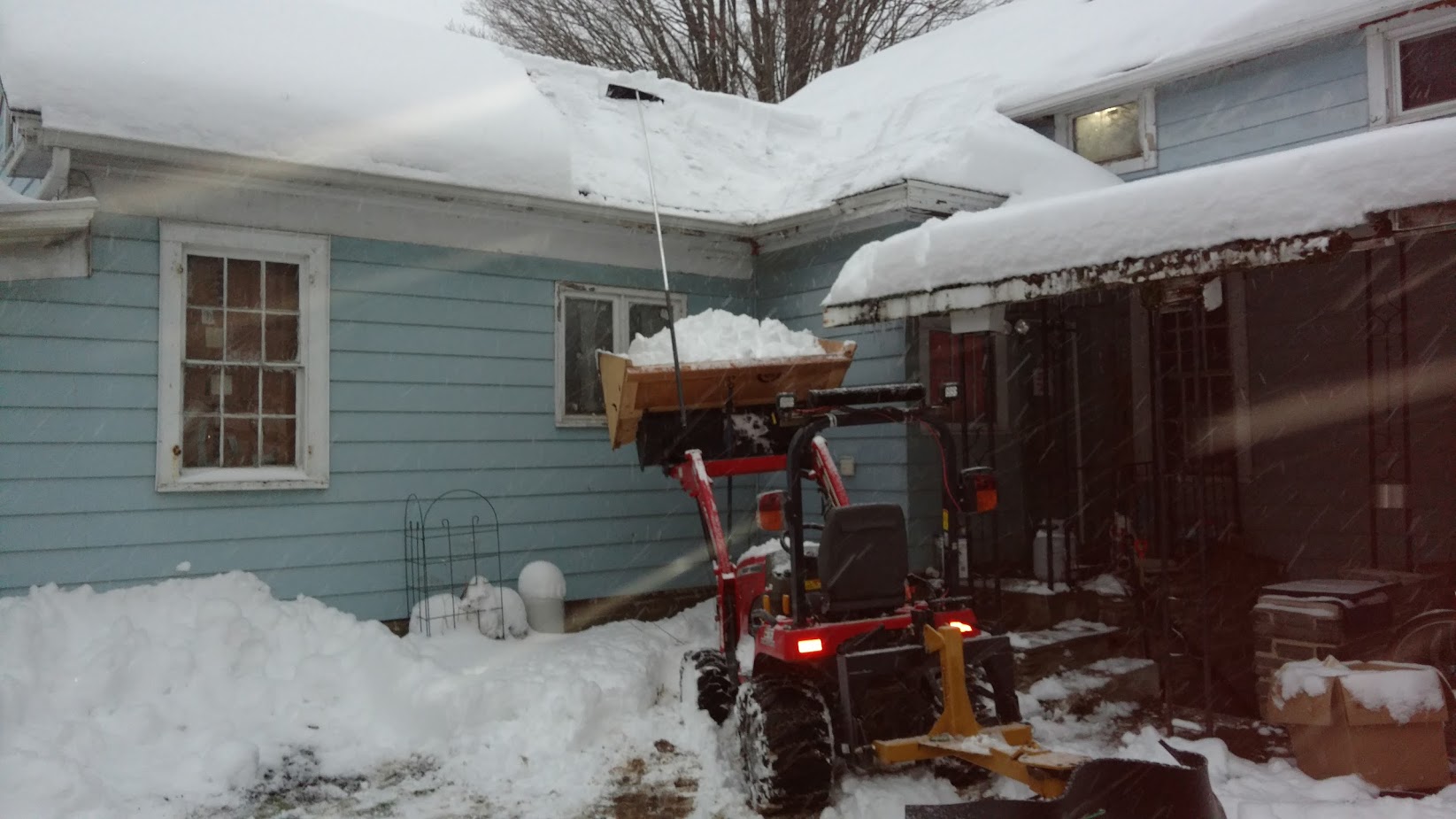

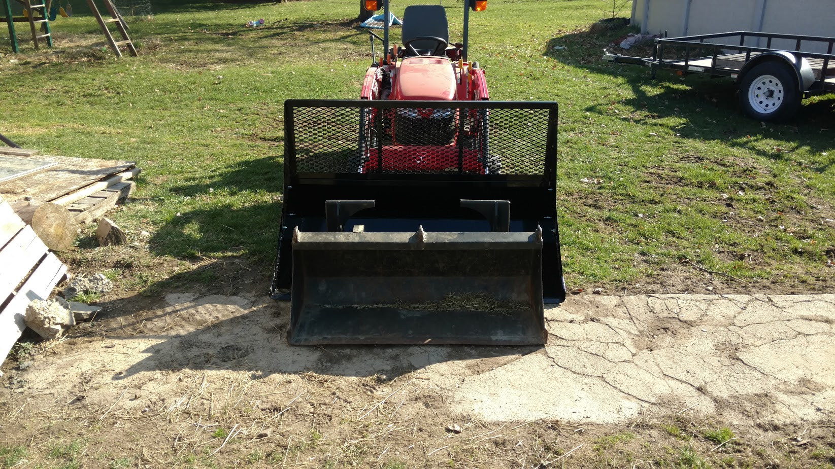

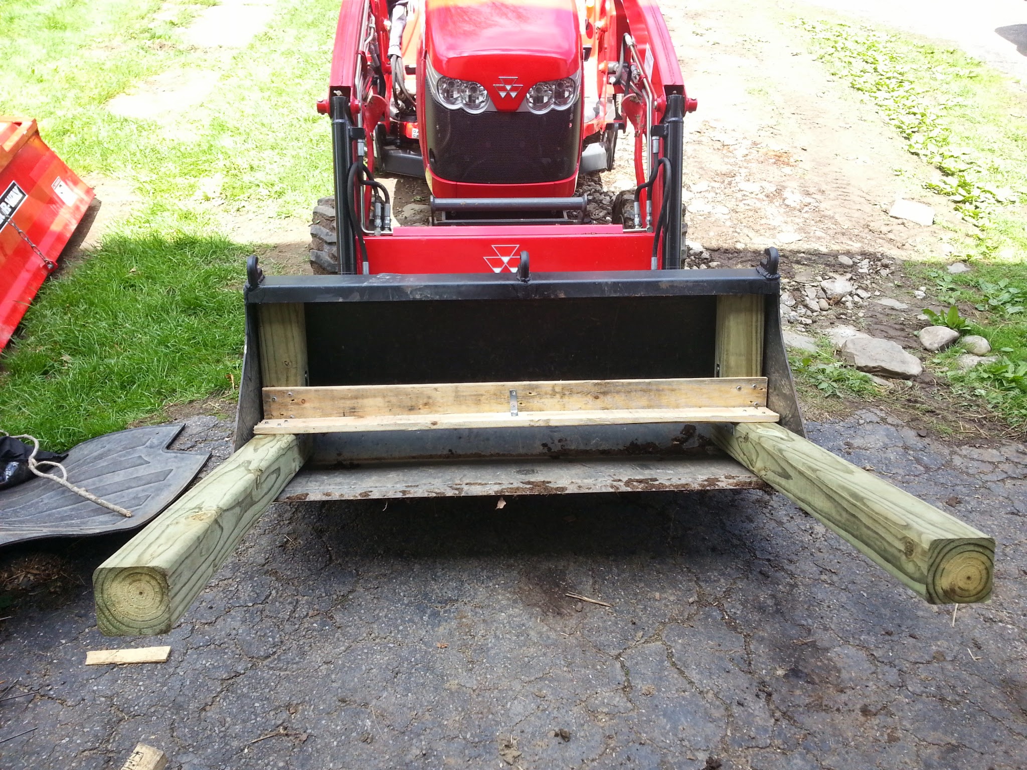

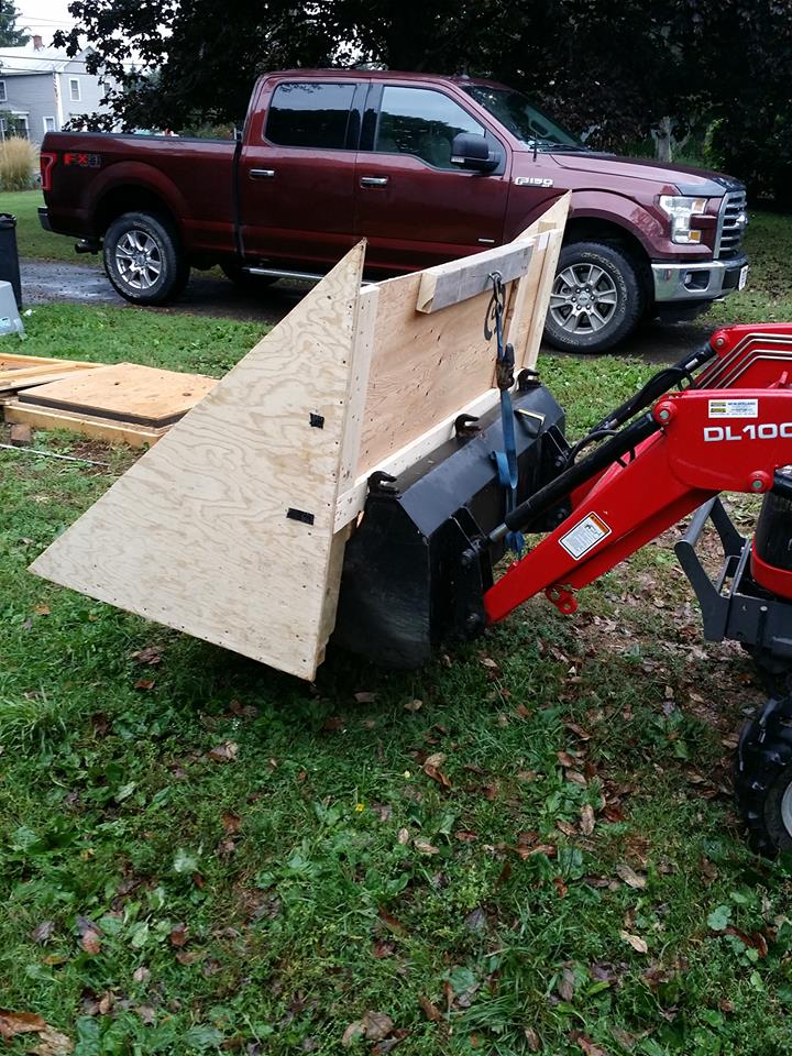

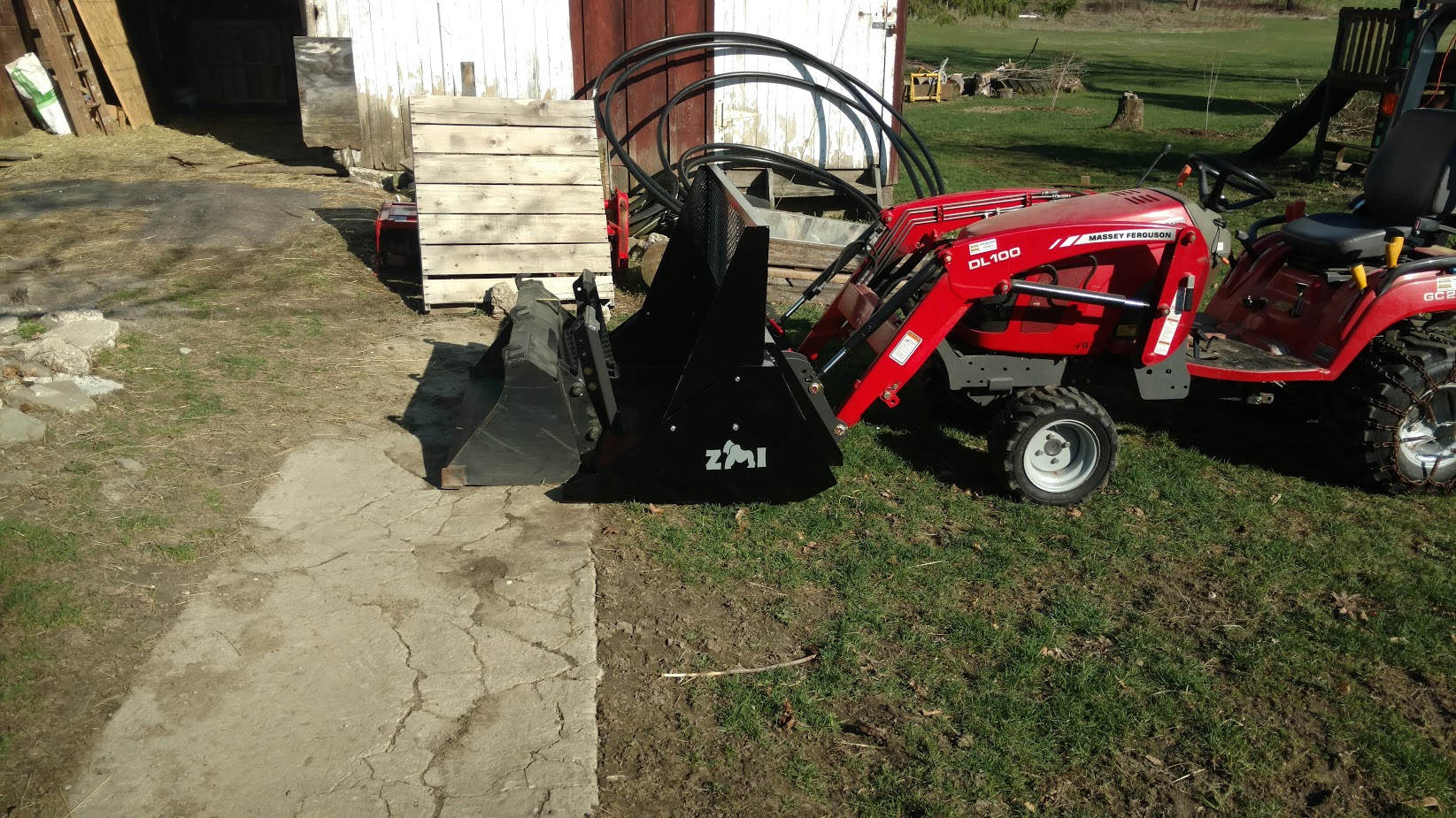

I love the thing! haha But then, I was the guy working at Sam's Club who'd use the forklift for everything possible, not just getting stuff off the racks. Drop 10 pallets of paper towels and push them down the aisle to their bays. Nudge pallets back in line under the shelves. Haul a stack of pallet jacks back to receiving.
My tractor is the same. Home made 4x4 post forks and a piece of plywood held a 5 gal bucket of aluminum paint at roof level so I didn't haul it up the ladder. Extensions on the forks picked up a whole stack of pine branches at once after a company dropped the dead tree, and my buddy and I cut it up. Forks and larger platform hauled chunks of pine that wouldn't fit in the loader. It tills our garden, and is my favorite wheel barrow for mulching/composting around the flowers and fruit trees. I've pulled shrubs out by their roots with the loader and a chain. It mows and clears snow. I used the loader to dig out a friend stranded in 19+ inches of snow with just a cheap plastic shovel, and an elder gentleman's driveway that his neighbor got his truck stuck trying to clear out. (Couple ladies stopped me while on the other job and asked if they could hire me. No idea what to charge, but I made $100 that day in a couple hours.) I used the forks to lift off 300-ish lb stone steps, carried them back to my fire pit, then set them on log sections for benches. Tearing down those steps (door is walled over on the inside, insurance company made us maintain them for liability reasons) was a job I'd dreaded doing before. I figured I'd need to chisel the mortar away, and somehow drag these "huge ***" stones into my truck bed, then fight to get them back out. The remaining stone crumbled under the loader and was scooped up. I did it all myself without any help in like half an hour. My 11 yr old daughter can even drive it, till with it, and work the bucket somewhat. This year I might start her on mowing since I can take the bucket off in a few seconds now.
The ballast box is a tool holder too. So it carries my rakes, shovels, etc while we do yard work.
I even had a custom bucket designed and built for it to replace the wooden expander I made so cleaning out the barn, and raking snow off the roof takes fewer trips (and less time).
I did load the rear tires with 11 gal of washer fluid for more ballast (using a submersible pump, 5 gal bucket, and adapter off amazon), and swapped them left to right to get 3" wider wheelbase for stability which helps a lot. And a quick hitch from harbor frieght to make it easier to swap 3pt implements (also adds about 60lbs of ballast).

One thing I wish it had were split brakes as I lose steering traction plowing snow, but I haven't seen that option on this size tractor. So I might just throw chains on the front. It's really only my driveway and sidewalk that are the issue and I have R4 tires. So maybe some turfs or doing some grooving on the tires would help.
