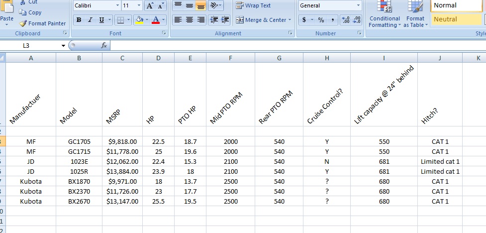

The more Im researching the more I think we may be ok with the SCUT. I dont see us doing anything too ground breaking other than normal household stuff. Heres what Ive got so far:
What other categories do I need to look for. Ive noticed its tricky finding some of the specs.
A couple questions:
- What is the importance of the lift at 24" behind? I noticed the massey is over 130lbs less than JD ands Kubota?
- What is the limited cat 1 hitch on the JD?

   / Need guidance in selecting Mower vs Yard Tractor #86
Those are 3pt lifting weights I believe and not loader. That's 24inches off the tractor on the 3pt
Limited Cat 1 I would guess is fixed lifting arms that can't be taken off, you would take them off to put on a backhoe ext. just a guess. Not sure.
