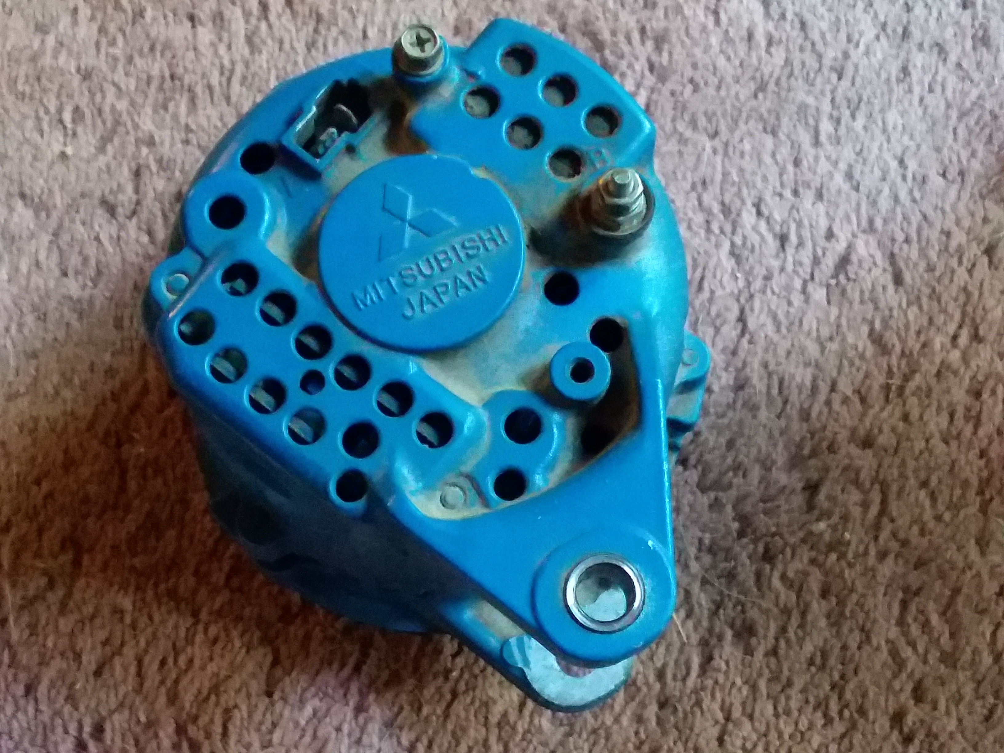

Just got back from Autozone and the alternator is bad. Now, the question is $263 for one from NH or $75 for aftermarket from Amazon www.amazon.com/ALTERNATOR-FITS-TRAC...jbGlja1JlZGlyZWN0JmRvTm90TG9nQ2xpY2s9dHJ1ZQ== Is there a major quality difference between OEM and aftermarket? I would prefer to stick with OEM but that's a substantial difference.
On closer inspection it appears that the back of my original is a little different than the one from Amazon. Is the extra plug in terminal on the right hand side of the Amazon one only used for some tractors? Thanks.

The after market alternator is most likely chinese and has multiple applications. If you don’t have a wire to plug into it don’t worry about it as long as it has the socket for your 2 wire plug. For the difference in price you can buy a couple of cases of blue paint to make it match. The NH unit is probably made in the same Chinese factory as the after market one. I think you have found the cause of your problem. Get all the gauges, senders and fusible link gathered up and proceed with reassembly. Your fuel sender is probably OK but to be on the safe side replace it. Same for the temperature sender. If the oil pressure gauge is electric replace it’s sender as well. Fuel level accuracy is not critical but oil pressure and temperature are. Keep me updated as you progress please.
