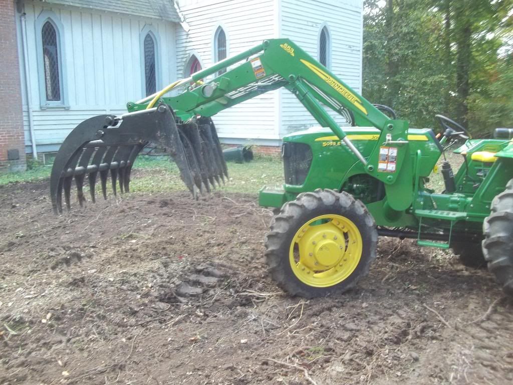

thanks.. how do you like the stump grapple? how versatile is it? Im wondering if a stump grapple would be just as beneficial since it could dig for me as well... can you pick up brush with with it? I actually called RCO in Gville and it was 1900 installed for the 48" grapple which I thought was kinda high.
I haven't used it enough to form a firm opinion. Probably 2 hours of use so far. I like that I can dig with it, but I'm leary of digging too much. My tractor is brand new so I'm feeling my way along, trying not to tear anything up while I discover the limitations of my equipment. One thing I don't like, as I mentioned, is the solid back of it that prevents me from seeing what the bucket part of the grapple is doing.
Yes, I can pick up brush with it.

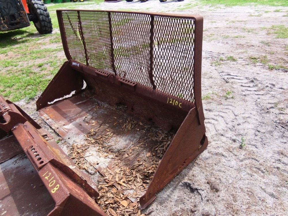

i have the wildkat version of the bobcat one in your fist post. i paid $1200 at auction and 25 for fittings. it works great pushing over trees and picking them up raking the ground, i have cleared a little bit with it
the land (wish i had before photos but i don't, bigger trees (6"+) were cut with a saw and the stumps ground)
If I could find that style for 1200 I would have definitely bought it too.... that's a good deal. It looks pretty tough have you have any issues out of it?
so far it has heldup to everything i have thrown at it.
