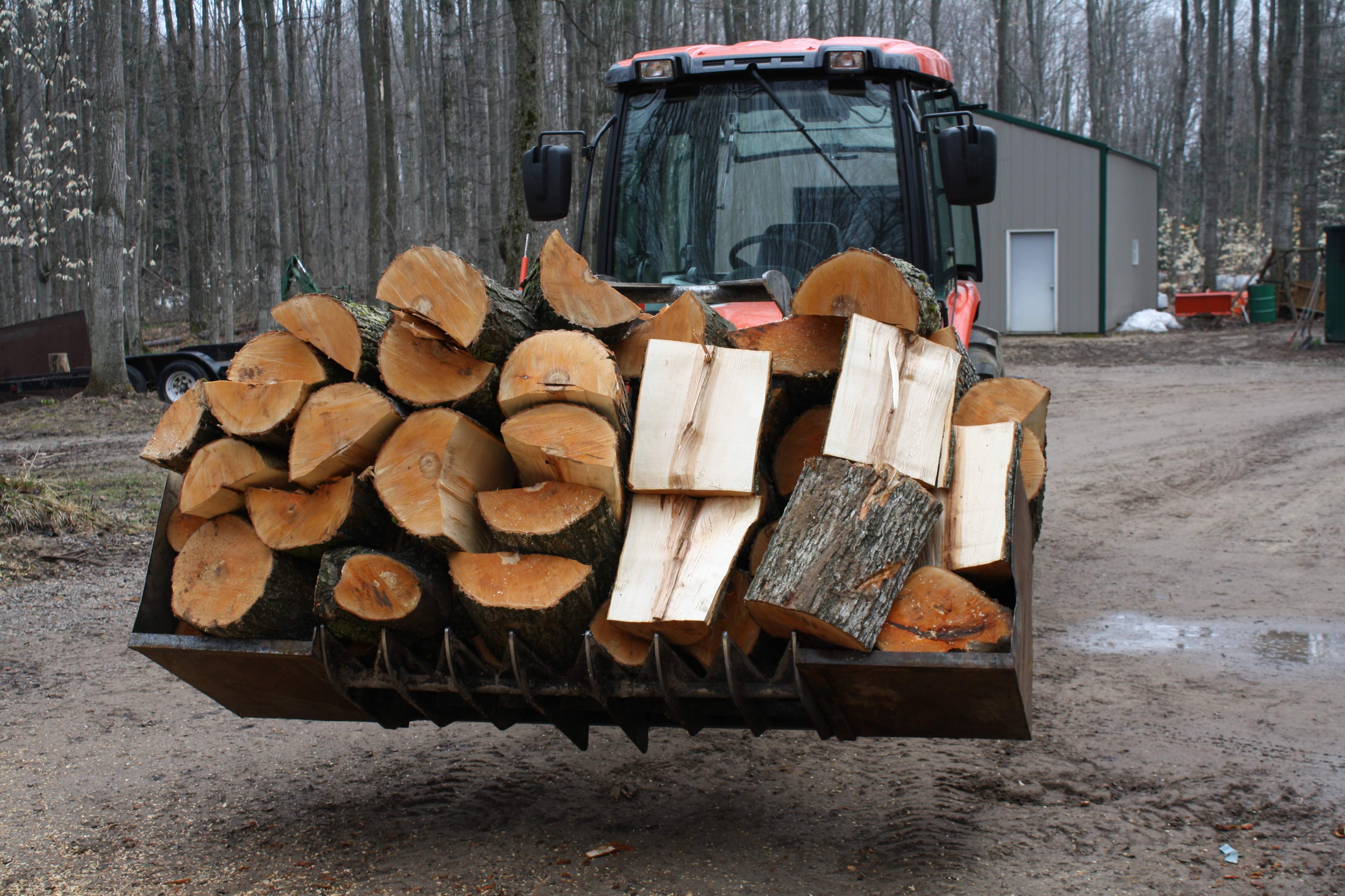

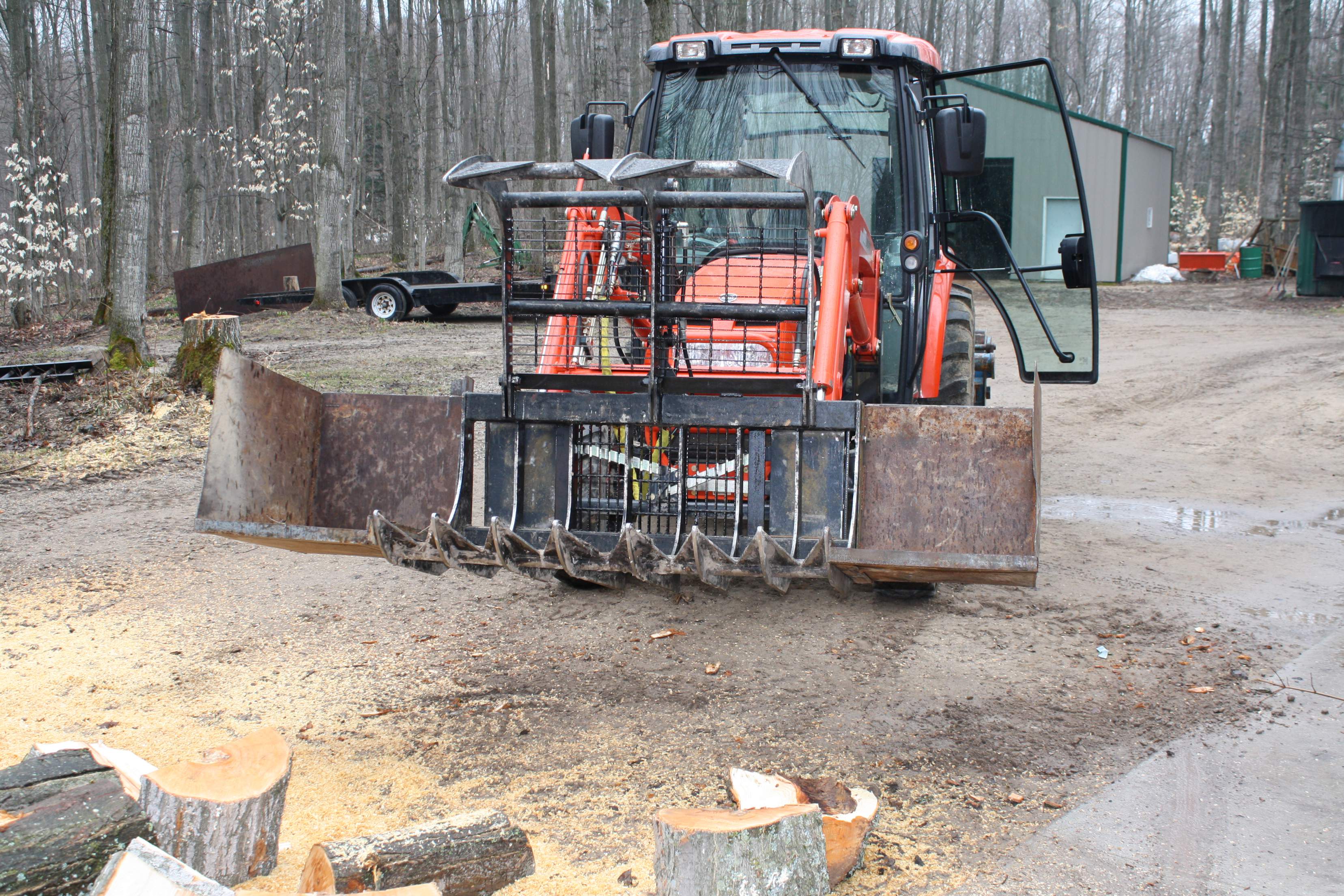

I agree that the the 48" grapple should do everything needed and then some. I see no real advantage to a wider grapple unless you deal with a lot of firewood, want to carry multiple stumps or similar objects at one time, and don't mind only grubbing 4' at a time.
A narrower grapple is also cheaper so it saves money AND weight.
Unfortunately, the FACT remains, there is no one single grapple that is best for everyone, even the beloved48" single time grapple is not the BEST choice for everyone.
Of the thousands of posts here on TBN, I've never read any that day they regret going for a wider OR narrower grapple than they did. However, I've read some that say they regret going with HD versions.
