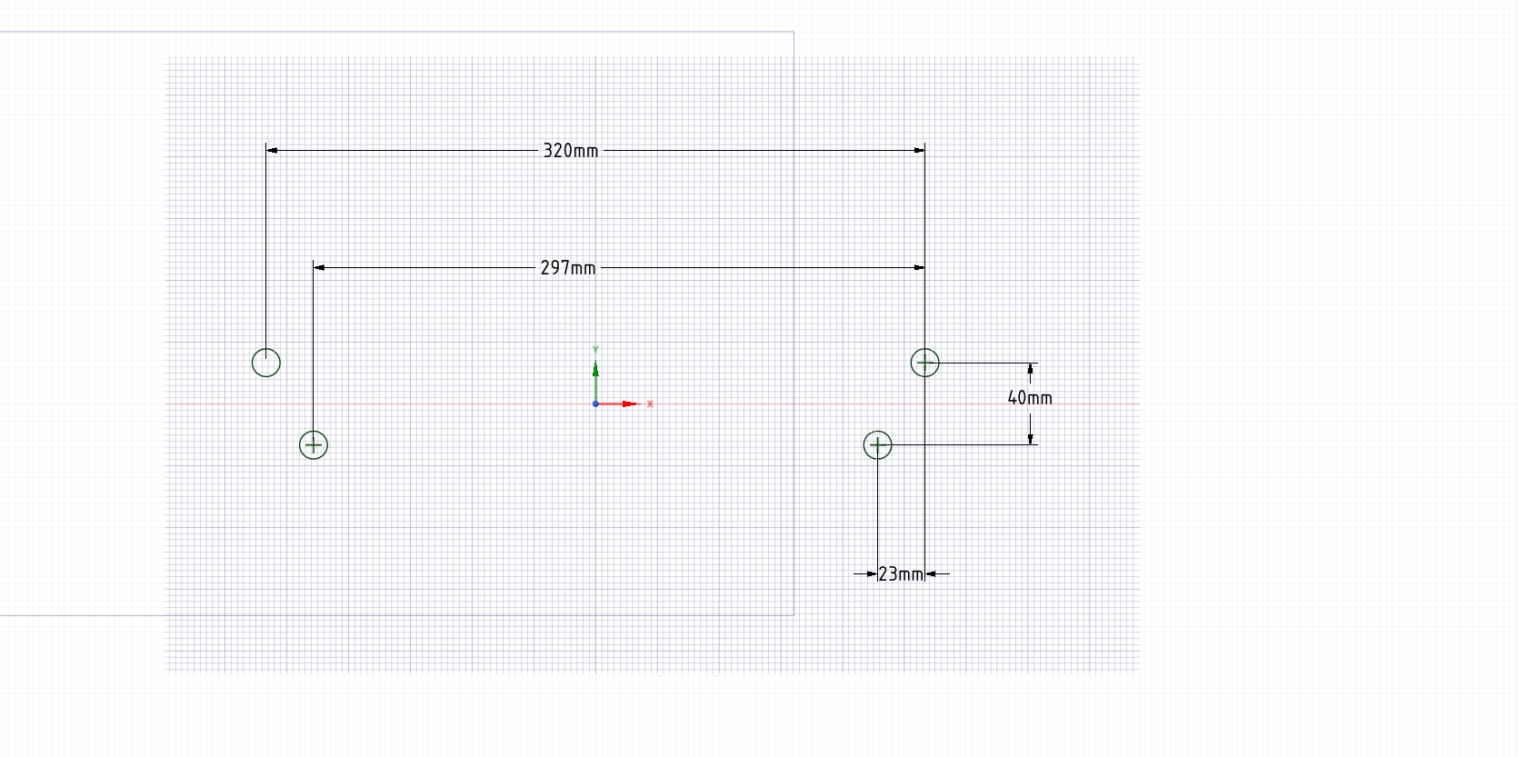

   / Need help idintifying motor mounts for an 8.3L Case built Cummins. #24
This should be the dimensions for the holes in the front of the block. Sorry I can't supply more data than this, but I hope it will help. Good luck!

#27
I'm assuming the "23mm" measurement in the drawings is supposed to be 11.5mm? Something is not correct there.

#28
I recreated the sketch in Solidworks and plotted it 1:1. I'll cut it out tonight and see if it fits the engine. I have a draft of what I was going to build, but I'm not sure if I want to go this complicated.
These dimensions will definitely help me fix my model.
My original plan.....not sure if I'll still do it like this or not.
   / Need help idintifying motor mounts for an 8.3L Case built Cummins. #29
Double checked the print, and 23mm is the call out. Is it possible Cummins had a proprietary block for Case? Check the mounts you have to see if they match up.

#30
Duh. I had 297mm as the dim between both bottom holes, not a bottom and the top on the right. Now it does look like the wrong pattern. That put the angle between top and bottom hole center line and vertical at 29.9 deg. That is way too much. The angle on my holes is around 14 deg. I'll cut out the corrected pattern and hold it up and take a picture tonight. I got to pulling fence last night and welding up some junk for work and got to bed about 11:30. I should have some time tonight.
