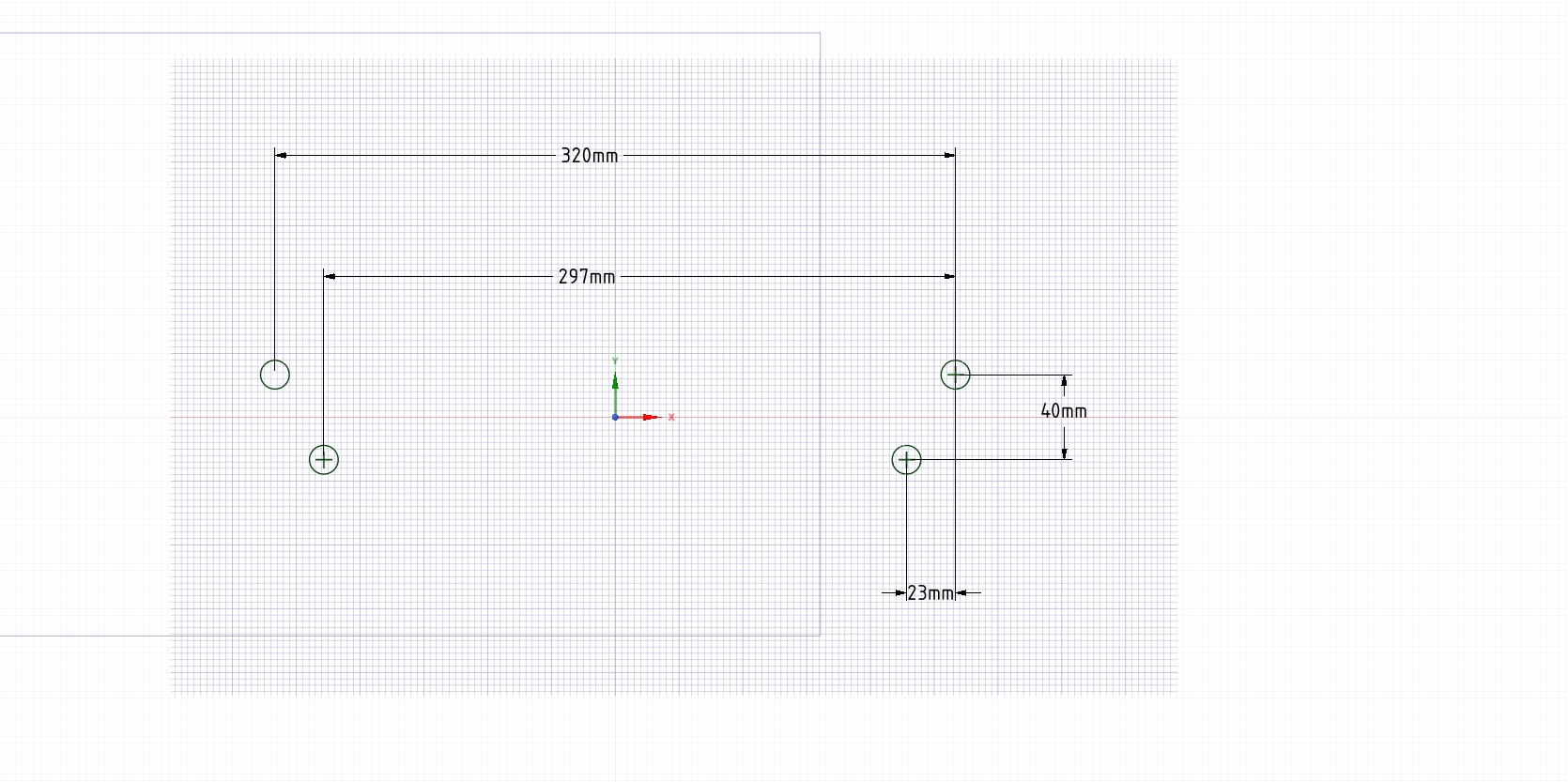

No, I haven't, I'm in OK. It is getting taxing to call folks and explain this whole 20 minute long story every time. LOL My buddy Chris Mayer (Mayer Farm Equipment, LLC) buys 8.3L's and puts them in combines. He send me the one in the picture that is close but won't work.
I've been researching this for over a month with no luck. That is why I thought I'd ask a new batch of folks on this forum. I was hoping someone here knew something the rest of us were missing. The only thing the irrigation application is stopping me from using is the normal yoke because they use some off-bred timing case that has different dimensions. This is the case I have next to a normal 8.3L timing cover gasket that is on 99% of the 8.3L motors.
I don't know. I'm at a loss. I'm trying everything I can to avoid building a mount from scratch out of plate.

All the 8.3L in trucks are mounted with the yoke mount on the front aren't they? It is only the ag applications that mount it on the side. Every truck in the salvage that I ran-sacked had them mounted like that but the mounts just won't work for mine.

Whomever designed this timing case didn't leave much room for a support like this....naturally, it's an ag engine and was mounted on the side like you said. I would have swapped covers when I had the engine torn down if I had realized this was going to be such an issue. I really didn't want to pull the cam so I let it slide.
