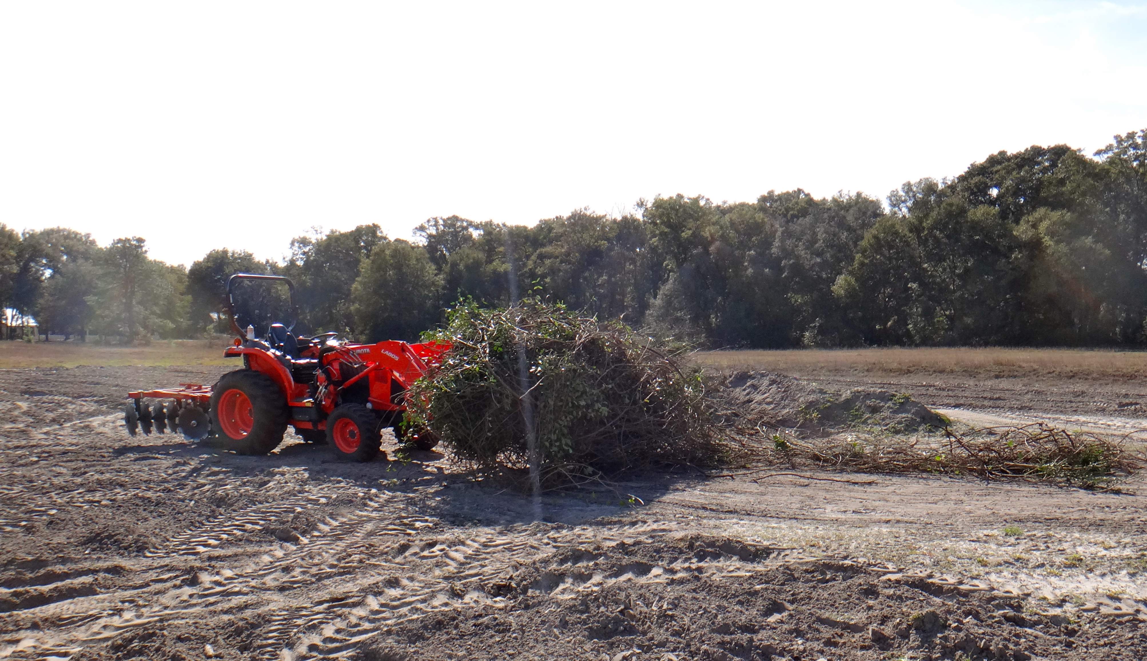

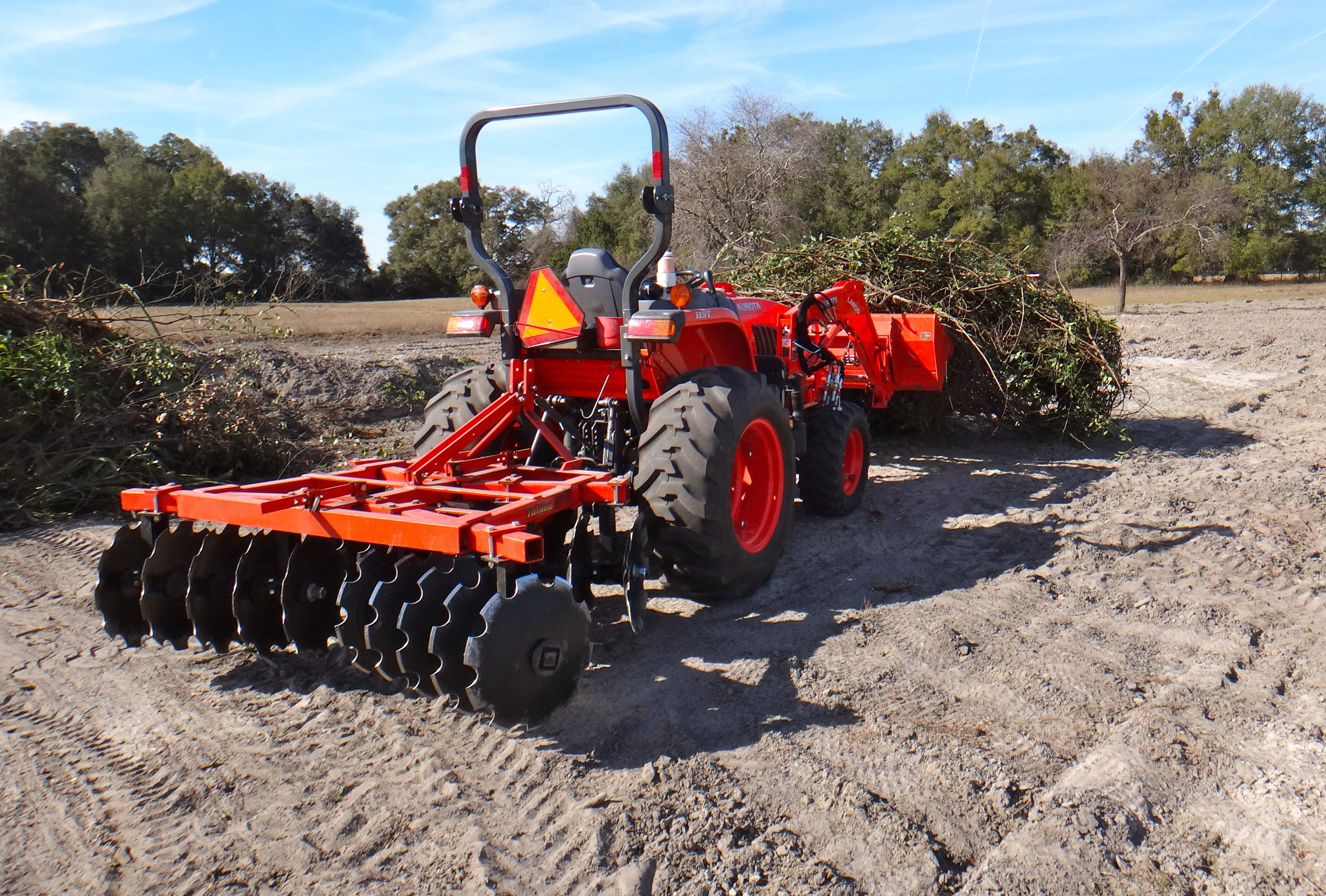

PHOTO FROM YESTERDAY: Approximately 1,300 pounds wet vines and woodland debris on Debris Forks, counterbalanced by 18/20" Tufline Disc Harrow @ 915 pounds. Vines were torn from trees and ground with a Ratchet Rake on HD bucket.
For woods cleanup and light grading a Ratchet Rake is a high value FEL attachment. (Photo #6) There are many Ratchet Rake videos on U-Tube.
