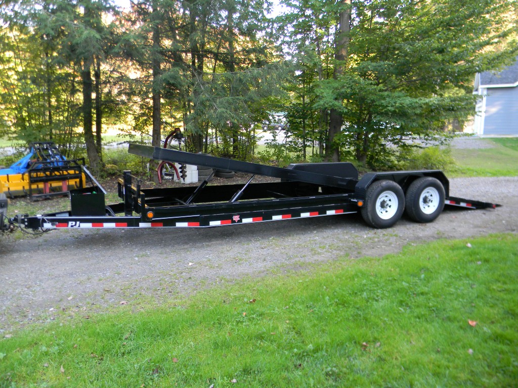

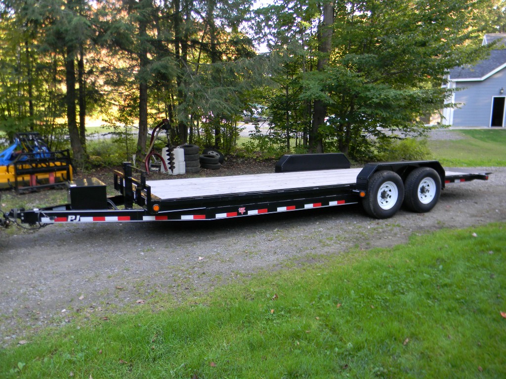

Check PJ Trailers. I have the TF model, 22' tilt bed but mine is power up and down and you want gravity. I've attached pics and have taken measurements showing the axles are placed back quite a ways. I believe the TH and T5 models are gravity tilt. Look at their brochures and give them a call for specifics on where the pivot points are and how they work. No, I don't work for PJ, I do like my PJ trailer though.

The OP is inquiring about a split deck tilt trailer.
Yours certainly does not look like a split deck trailer to me.
