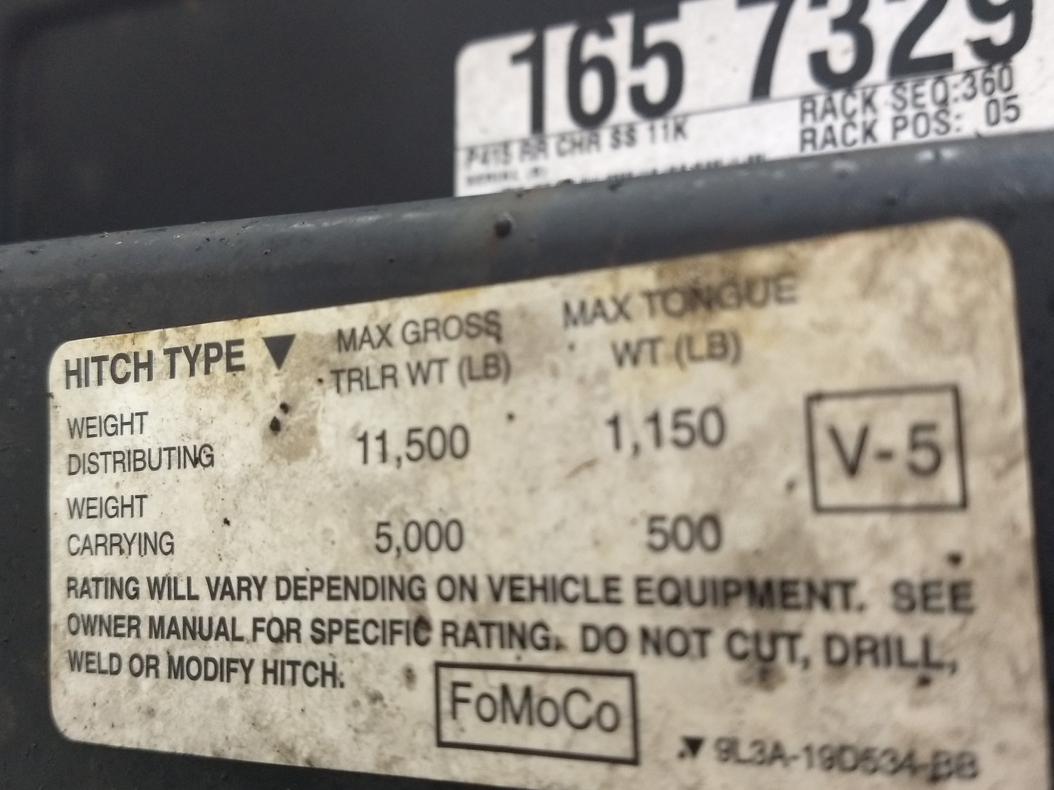

This is a picture that might lead you to believe it’s a class V hitch. I don’t know what the V-5 means but not class V.
The last Chevy 3/4 ton I had appeared you didn’t need a WD hitch for something up to about 11,500 pounds, at least that’s what the hitch sticker said. I didn’t read the manual close enough to see if it said other wise.
V-5 is an old standard for testing this hitch. The industry has gone to SAE J684 for receiver hitches and SAE J2638 for gooseneck/5th wheel hitches. Really the whole "class" system is a joke as you'll find "class 3" receiver tubes on 2,000 lb rated hitches for vehicles "not rated to tow". Remember, it's always follow the lowest rated component of the towing system. If the car's not rated to tow, your overweight.
State laws can override when a WD hitch is required. I know some states require a WD hitch on anything over 6K lbs.
   / Need help with purchase of weight distribution hitch #80
Curt says this: Also, the receiver is not rated any higher than the ball mount/drawbar. There are also differences between OEM hitches and aftermarket. A lot of 2" are class 5.
"Class 5 hitches are a bit different from other hitch class ratings, as this class is not officially recognized by the Society of Automotive Engineers (SAE). This means that the information on how much the hitch can safely tow should be verified by the manufacturer."
Curt also has their industrial class 5 hitches with a 2.5" receiver tube. Class 5 hitches are tested with extrapolated numbers to the higher ratings. There is a SAE 20K taskforce in the works but nothing has been published yet for test requirements. They should bump it up to 40K as Ford went ahead and jumped their darn ratings yet again!
