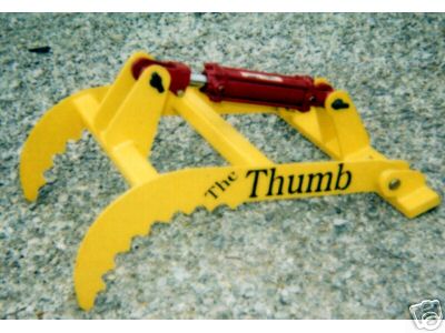

We are getting ready to put a bucket grapple together for our 72 inch NH bucket and we could use some advice from other TBN members on how to mount the project. We are using the design of The Thumb and making a few changes.

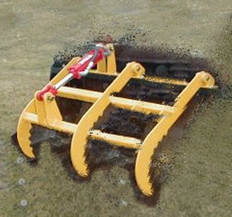

The grapple will use 3 lift arms instead of 2 and we will center the cylinder over top of the center lift arm. We think the additional width will give the materials lifted a bit more stability.
/ Need some advice
Our question has to do with how to mount the grapple to the bucket itself. Originally this type grapple was bolted to the top lip of the bucket itself but i'm thinking that might not be the strongest way to mount it.
If you look how some companies attach to the sides of the bucket i'm wondering if you think this may be an advantage strength wise. Does it make a difference if the support tube is round or square when it comes to overall strength?
Anyone else have any input on how to make this grapple quick attach to the bucket, or should I just settle for pulling the 3 lift arm pivots with the rear cylinder pivot to lift off the majority of the grapple when it's in the way?

I would add a full length brace and put drop ears on each end with Pin holes to match the side of the bucket. You would need to reinforce the pinholes in the bucket. Maybe 4 locations.? 2 on top and 1 on each side. It would be quick release but I think you would get some movement unless your pins could use a taper fit on the keeper????

Ron do you think there are any advantages to using the round support tube over square? Wonder which would be stronger?

the round would be a bit stronger (not by much) but the sq would be easier to work with, align and attach now and in the future...
I'll eventually build one for my tractor too, no time now but one day I will. anyhow the side and top of th ebucket would give you extra strenght for sure. most bolts have more shear resistance than they do tear out strenght.

Square or rectangular tube would make the grapple you are looking at easier to make. I used round because that's what I had. I doubt if it would make any difference in this application.

I think there are 2 advantages to the side mount. The sides of the bucket are aligned to provide strength in shear rather than bending which is an improvement, plus the side mounts are at a radius from th <font color="black"> </font> e pivot point closer to the tips of the grapple to reduce the bending moment transferred to the bucket mount.
Also, the widest possible bolt pattern for the side mount will be strongest.

Usually square tubing is much stronger for a given tube size and wall thickness.
