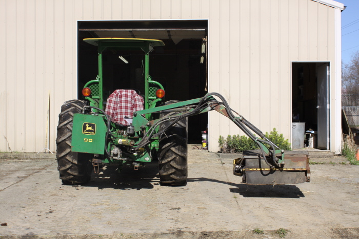

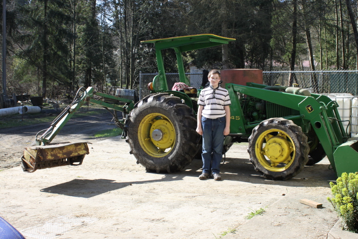

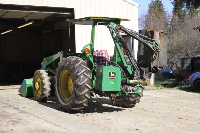

That's good that you tested it so you can find out if the mower has other issues besides control cables. From your pictures, I'd say once you get the control cables worked out you'll be good to go.

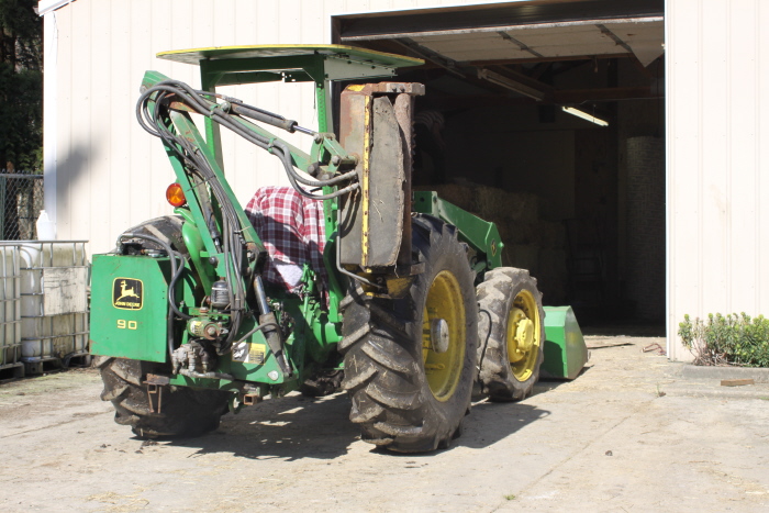

It does seam to have issues, but I should be able to work around them. The arm has a lot of movement if set to float on the ground. A LOT of movement. With controls, I should be able to let it ride and inch or so off the ground and be fine for what I need to do with it. The movement in the arm can be looked at next winter if it becomes a major inconvienance.
I have also discovered that driving with an arm sticking out to the side will take some practice to get used to. LOL

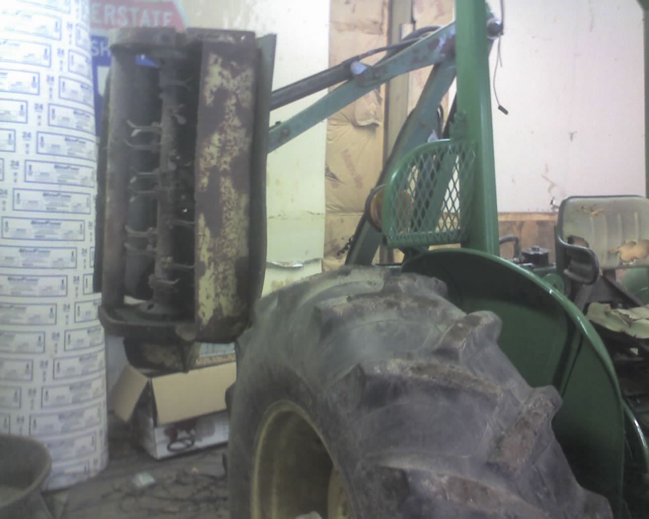

Are you able to see over your tire at the flail head when cutting close in or do you have to lean over to see what your cutting.
/ Need some help with cable controls
#63
So far, with what minimal testing I have done the answer is yes. However, I have not run the mower in close to the tire yet.

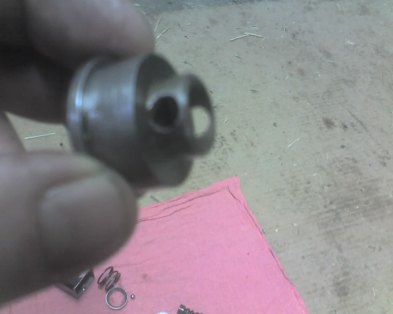

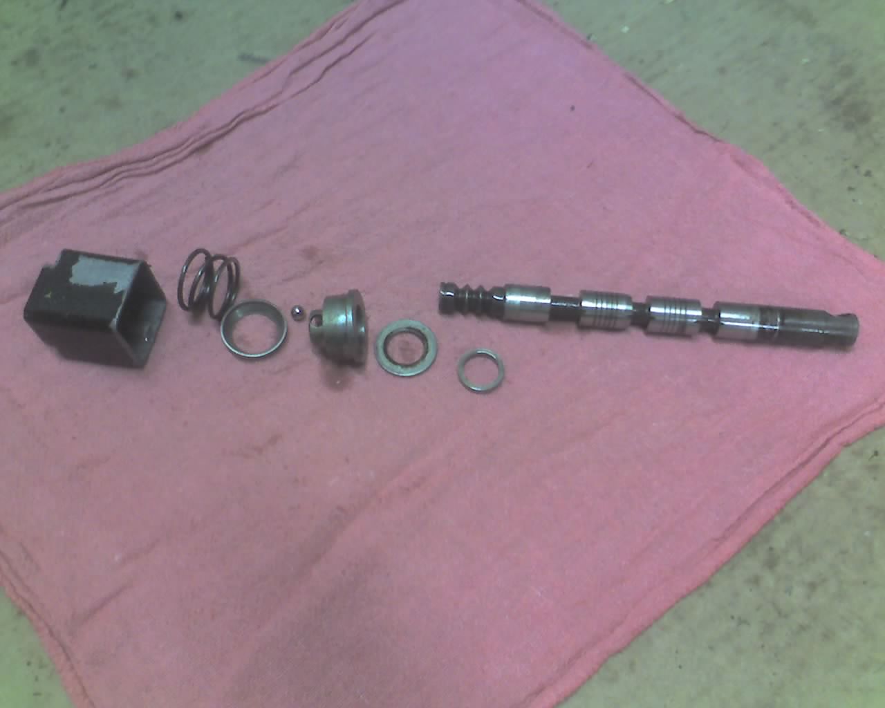

The motor control valve is repaired. Parts...1@ 1/4" bearing, 1@ 1/2" snap ring. Cost...free. One peice of the puzzle complete.
Haven't found a source for cable parts yet, but I'll get there. This should be the easy part once I find a source.
