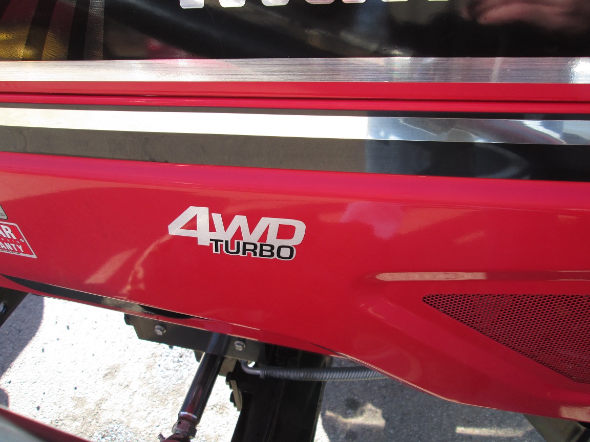

I'm working on a 3316HST deal with a dealer in AR. The backhoe has been ordered and hopefully will get installed on the tractor and then hit the road to my house by the end of next week.
Gotta love this emblem:
