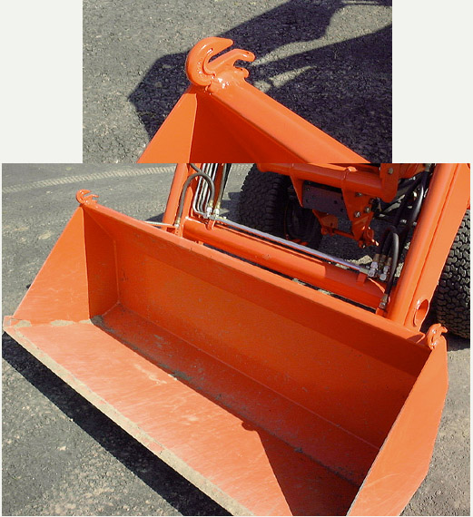

Gotta question.....would it be worth it for me to have them weld a hook in to the top-center of the bucket? I don't have a welder and am thinking that it would help in unloading the "required" implements from the pick up.

<font color=blue> Gotta question.....would it be worth it for me to have them weld a hook in to the
<font color=black> I had the dealer put one in the center for me yesterday before i took delivery on my B2410.
They welded a piece of angle iron across the top and attached a hook in the center. They did a nice job.
Might be a little pricy at 50.00 bucks but i guess thats shop prices.

I'm interested in having one mounted up. My brother in law will do it for me, but I want to see how they mounted the angle iron. On buckets similar to mine I have seen a lot bucket sbadly bent up by wrapping chains. The top does not look too sturdy so I'm interested in the angle iron they welded and how it was done. A posted picture would be great.

Here is a photo of where I mounted the hooks on my B2710 if you are interested. There should be now damage to the bucket with the hooks on the ends.

I was just wondering how you make your hook-ups with the chain(s). I have a single center mounted hook on my current loader - and it seems to center the load or direction of pull. Wouldn't having the hooks out at the corners make for an uneven pull and possibly put a twist on the loader arms, or even worse - want to pull the tractor over? I know I see a lot of them out there with this configuration and I just always kind of wondered how well it works.

PowerMax, you're right in that you don't want to try to lift a heavy load from just one chain hook on the end of the bucket, but I think the two hooks are much better (at least for my use) because they're more versatile. I always try to center the load, but that can be done in a variety of ways. Sometimes I hook a short chain between the two hooks, then hook another chain to the center of it for a single chain pull, other times just run the chain around whatever I want to pull or lift, then hook each end to one of the chain hooks. If you want to pick up something like a log, you use both chain hooks; might be hard to keep it level with only a single hook in the middle. In other words, I like the two hooks, but always use both at the same time, never lift from just one of them.
