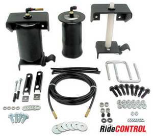

I think a 16ft utility trailer with twin 3500lbs axles would be fine.Be looking at what tires it came with,some just throw cheap tires on it and not true trailer tires(just cause its cheaper,not always better).Also if it has treated wood or not.The dovetail is only needed on the car hauler if your gonna have an high center problem,but down side no side rails.We have pulled alot bigger tractors on 16ft trailers for years.Also you could look at maybe getting airbags for the rear of your truck,not to much $$$. http://www.suspensionconnection.com/images/master/air_lift_ride_control.jpg
airbags.jpg $213

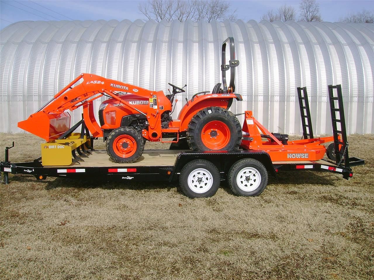

A week ago I hauled it on a 16' dual axle landscape trailer and it was perfect. As was said, if you're going to have a brush hog hanging off of it the 18' would be better. But if hauling with the FEL and BH a 16' works very well and landscape trailers can be had reasonable over car trailers if you have no plans on hauling full size vehicles on the trailer.

I am gonna step up and say- all these opinions is a bit over rated and being over thought. A simple 16'er trailer under 2k unladen weight will be fine for the BX. Airbags are not needed in my opinion. With a dual axle 16' trailer, the BX balances nicely with FEL all the way to front. Just add WD bars and the trailer will sit straight with tacoma.
Look at the facts- BX+FEL+BH=roughly 2600lbs + trailer 1600 to 1800lbs 16'= 4200 to 4600lbs. His tacoma will pull it just fine. Aluminum trailer is nice, but will he be transporting his BX in middle of winter with salt on roads? A simple steel trailer is fine and very useful for other things.
