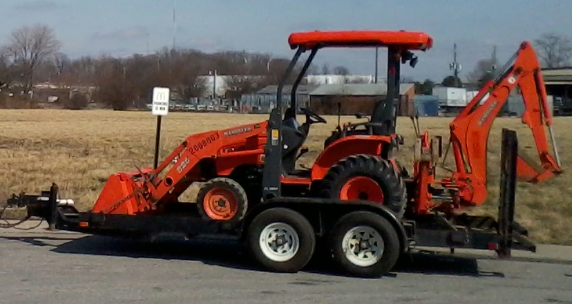

Just curious, you mentioned that is wasn't comfortable because of the length and lack of D rings. What about the length didn't you like? Could you not get it balanced and still have access to the tie downs that were there? I have very few tie downs on my trailer and I will be fixing that soon. I'll probably be adding at least 8 additional places to attach chains and will end up with more than that for ratchet straps. That has caused me a problem in the past when hauling some equipment. If it had more/better placed D rings would the 14' length have been OK? I just would like to know.
Another thing that a lot of people forget is the relative location of the axles on the bed. In my case, having the rear axle of the tractor nearly over the rear axle of the trailer seemed to be the sweet spot when the backhoe is on. If you have a full tilt, gravity tilt trailer, then the axle is going to be much farther forward relative to the lenght of the bed thus required a longer bed to get the right balance. A buddy of my has a 20' (and a 24') 14k tilt trailer and the distance from the hitch to the center of the axles is nearly the same as my 15' with ramps. I know having the tilt is nice for loading, but I HATE towing a tilt trailer when it is empty because it pulls the truck around so much. A split tilt (ie 4' stationary at the front) or a power tilt is OK because the balance is better but the cost is crazy for the power tilt. I attached some pics with my Deere on the 12' and the Kubota on the 15' for reference. I didn't have the box grader or forks loaded in the pic of the Deere, but they went up front and the loader set over them. I've also got a 2' x 2' x 4' tool box that I would mount on the front if I needed it and wasn't taking the box grader. I may have to get a different trailer in the future to hold different attachments but I haven't had too much of a problem because I can put some things in the dump bed. It would be nice to put them on the trailer so I can still haul dirt or rock in the bed though.

Tiedowns was the main concern..My machine took every inch of the 14 ft as well...It balanced on the trailer on it's own fortunately...I just would have liked some extra space to play with,
