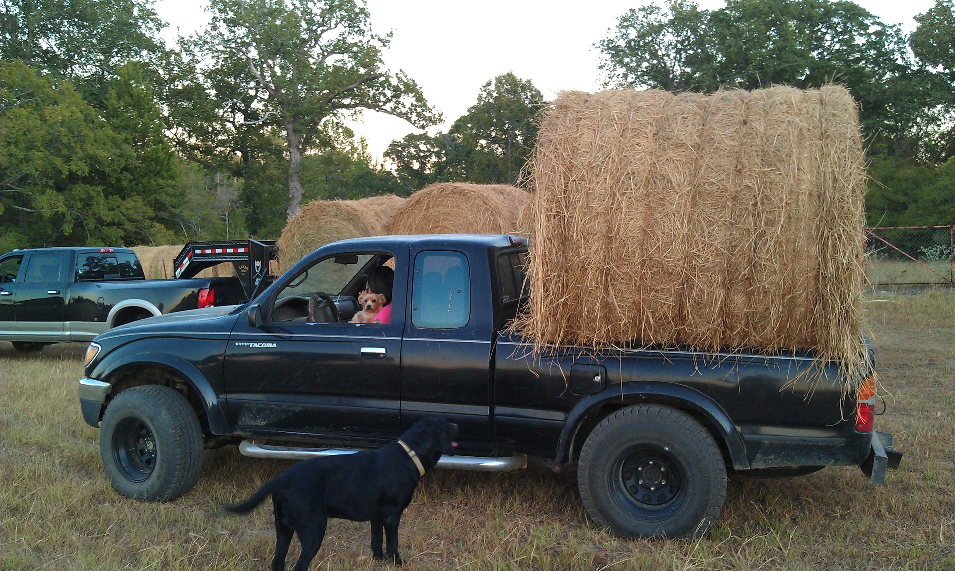

toyota.jpg 1800lbs+ bale,just throw it in the back:D
I have pulled up to 3 of these bales on a 18ft carhauler,I have pulled alot with this little truck.Just depends on how fast you wonna go usually just stay around 55mph,not going to get in any hurry..
