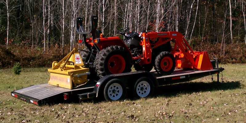

You got a fantastic deal. A trailer like you described would go for about $2.3k from what I have seen around here. Of course we have a 9.4% sales tax so that is a factor when buying new. No tax on used trailers.
When I started looking, I found well used trailers for $1,800 to $2,300 and they needed new tires. Well, tires are about $100 each which added $400 to the cost of a trailer. New trailers were in the $2,300 to $2,600 range. I never did understand why the folks selling beat-up trailers through they we so valuable.
Here is my trailer with a friends L3700 sitting on it. Good luck in your search.

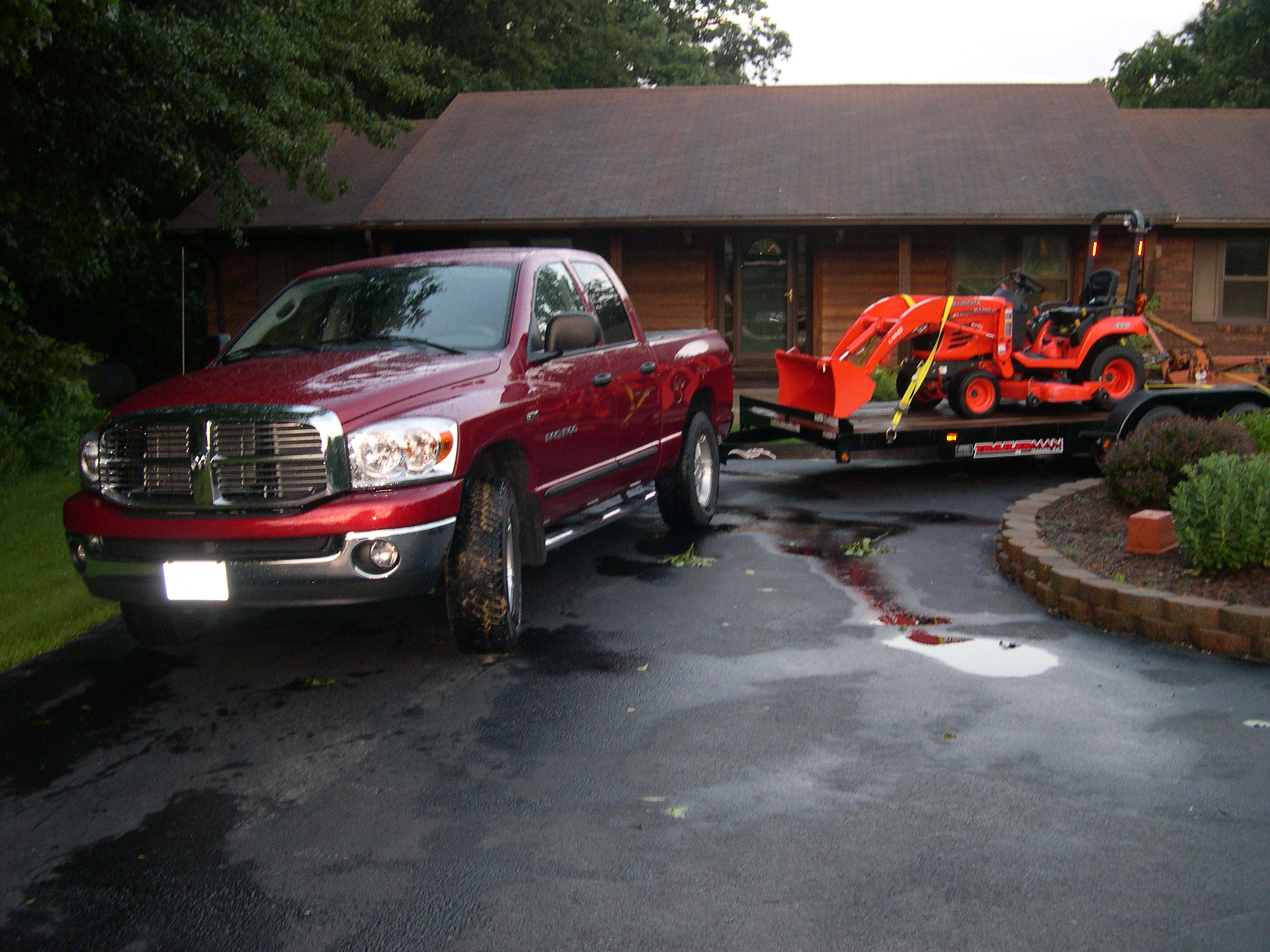

Here is a picture if my BX on my trailer. I don't own the truck anymore but still have the trailer. Its not the greatest picture, but my BX with end loader and a brush hog on it pretty much fills up the trailer. Its a 16+2 trailer, which means a 16' flat bed with a 2' dove tail. Mine also doesn't have any side rails. Some times the side rails get in the way, such as opening a car door, but they can also be handy to keep stuff on the trailer or to tie lightweight stuff down.
