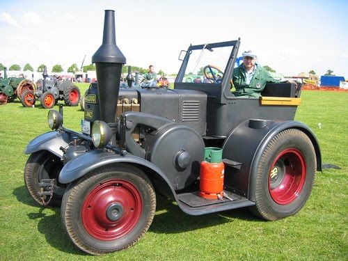

Im actually considering getting some ~40” mud tires for a [AFFILIATE='1, nofollow=true, newwindow=true, title="Kubota"']Kubota[/AFFILIATE] L210 im going to fix up. Was there ever a time when putting large truck tires on tractors was ‘a thing’?
Sure was.
