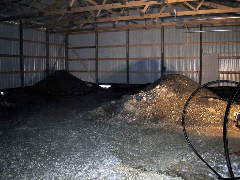

More lotsa fill. There's probably about 50 tons of washed No. 57 gravel there.
A big thanks to JASTN70D who moved almost all of it (99%) ... from the comfort of the heated cab on his TN70D (it got so warm with the sun out - and without the heater running - that he even had to take off his jacket)
I moved a little of it ..... but mostly I just ran the shovel. /forums/images/graemlins/grin.gif

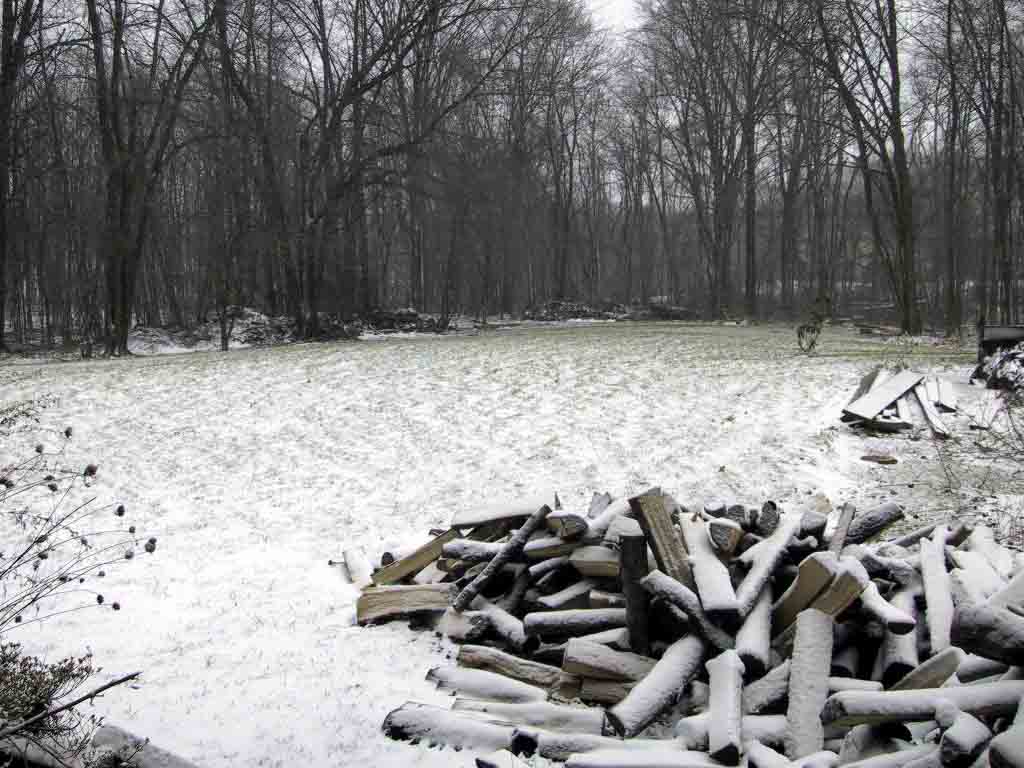

Now that I've finally managed to come up with a plan on exactly how I wanted to finish out the interior, estimate the materials, purchase them and have them delivered, weather has now turned bad again /forums/images/graemlins/frown.gif
29° with winds gusting to 32 mph with a windchill of 15° .... brrrr.
Hard to get excited about going out to barn in this kind of weather ..... too many gaps around the skirtboard and without a ceiling it's next to impossible to heat to any degree ....

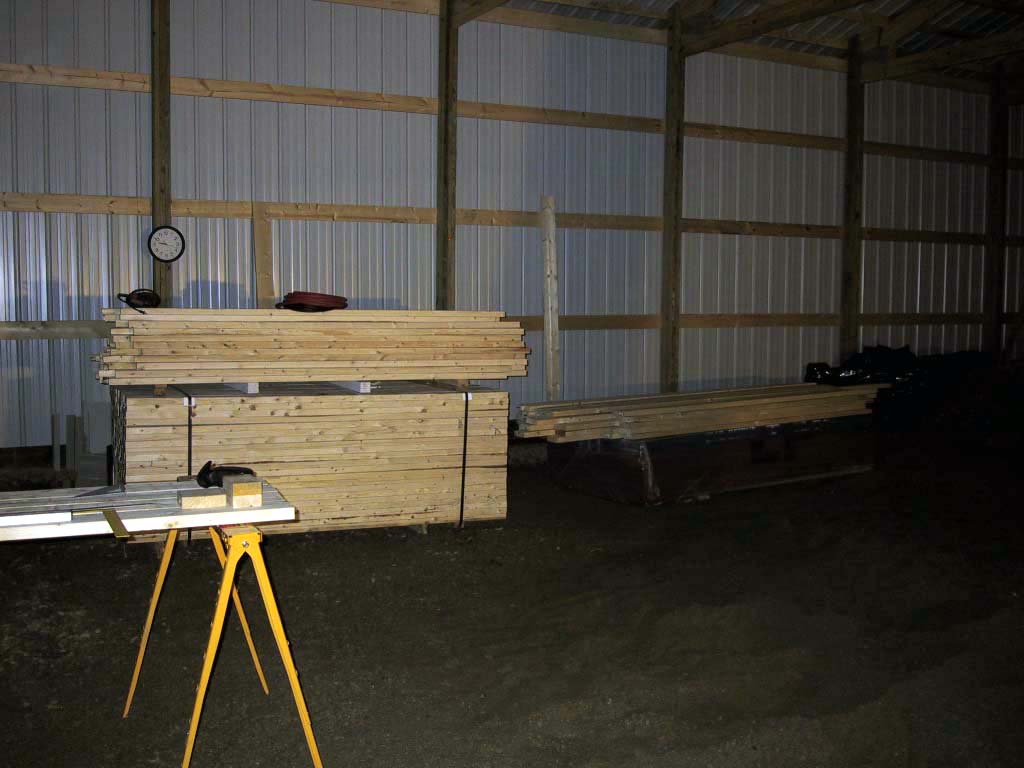

I was able to get the lumber delivered yesterday while it was still nice .... glad I had them deliver it. The guy from Lowes got here just before the rain started, whipped it into the polebarn with his towmotor. He managed to get all but the last bundle (which had some long stuff that was too big for the door) in before the rain began. He got the last one to the door and we hand-carried it from there.

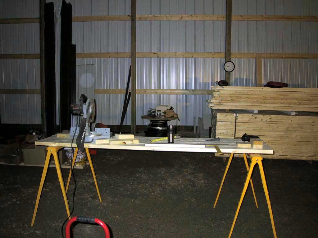

Got the mitre saw pulled down from the shed and set up on sawhorses. Got 17 bottom plates measured and cut and 5 outlet boxes installed before I quit for the evening (at 11 PM /forums/images/graemlins/grin.gif)
