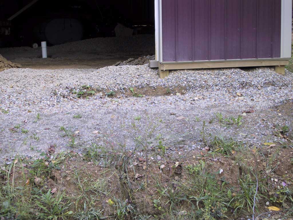

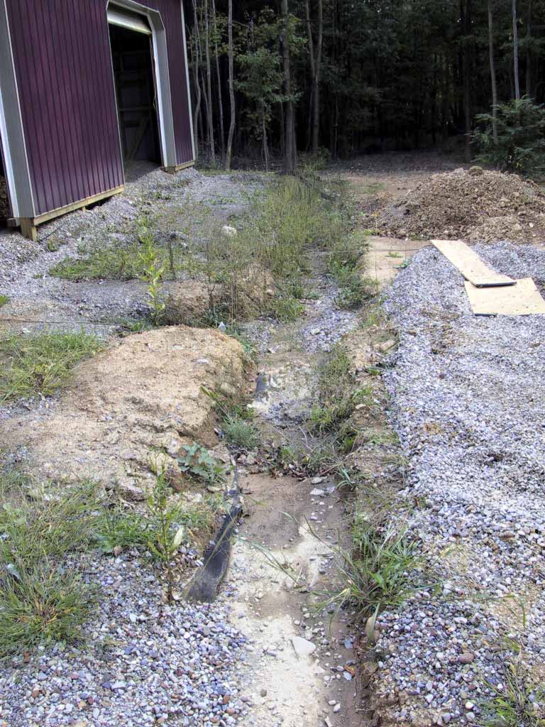

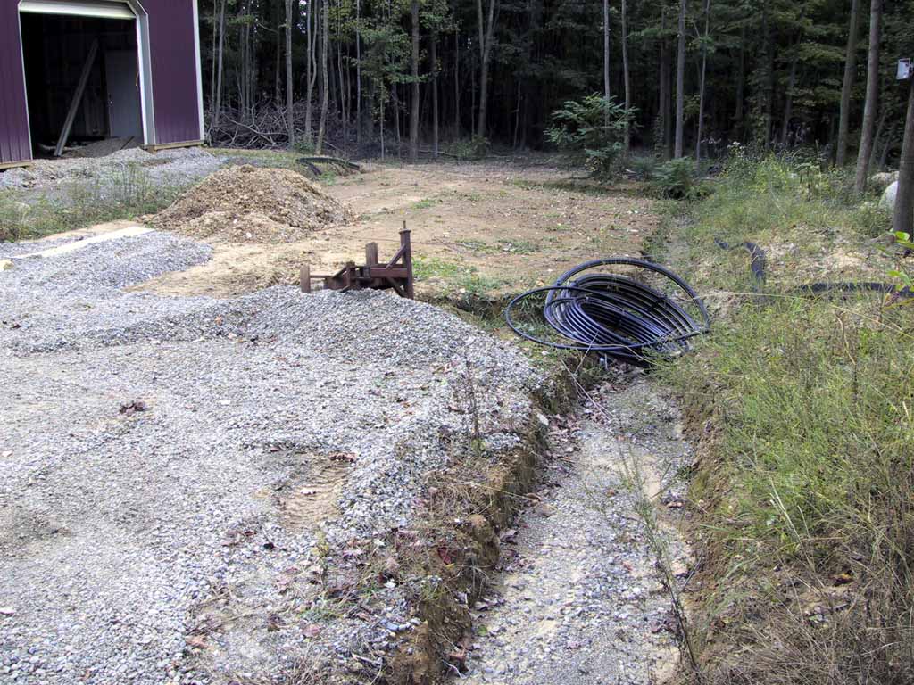

This is what happens when you trench more than you can possibly complete in a day. Take it from me - don't do it ! You just end up creating far more work for yourself in the long run.
Since the barn was cut into grade I tried to get a french drain system installed around the barn last year (Oct/Nov) before they actually started to put up the barn, as well as trenching for the utilities (water, gas, electric). And then it started to rain ..... and rain .... and rain. The exposed clay quickly into a mess making it impossible to work with equipment, and the trenches began collapsing. I would have been much better off just waiting until this summer to even start it. Now I have wasted time/effort situation, and work that I get to do a second time.
If ya plan on opening a trench make sure that you can close it the same day - unless you are totally certain that you will have good weather for a certain period of time. That's probably the best thing that I have learned on this project.

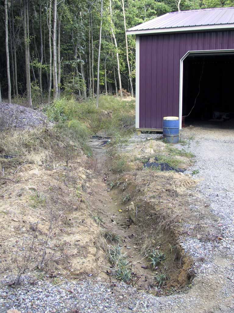

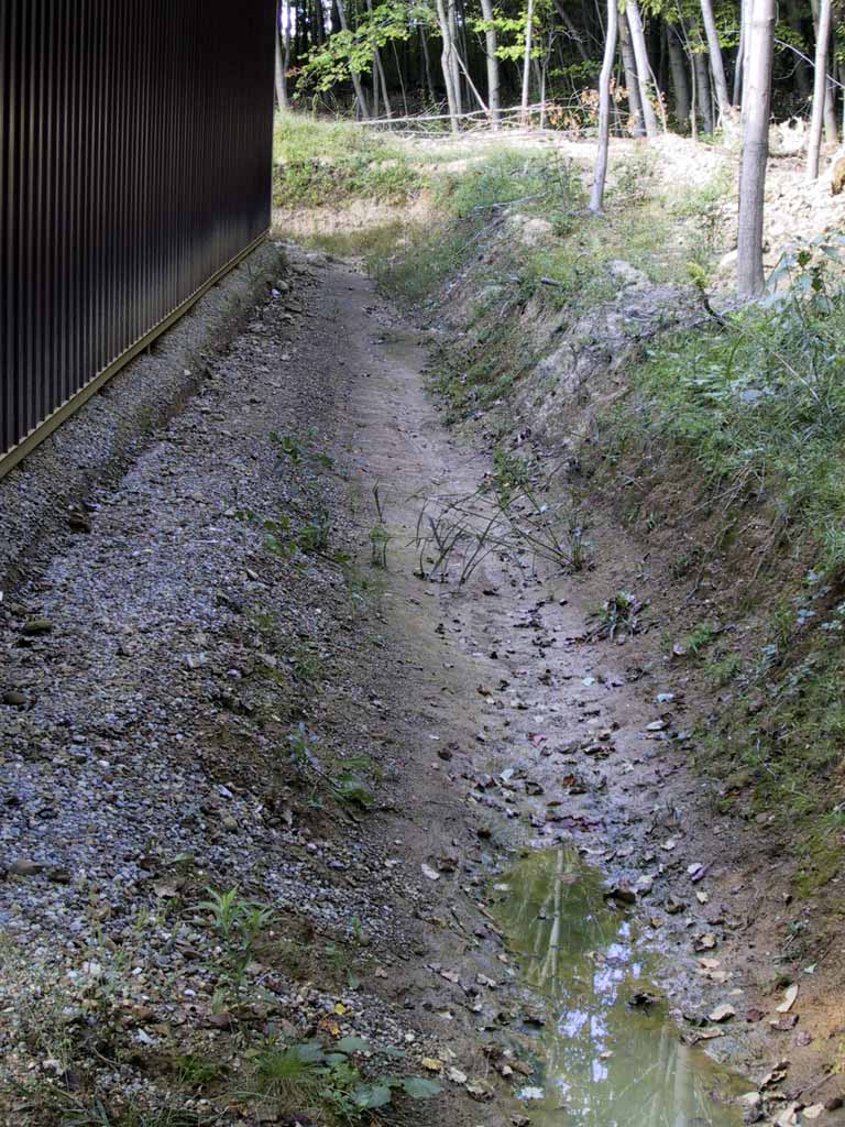

Later today I'll call the guy that will be doing the gutters and downspounts and tell him it's a go. It will take about a week before he gets the material and comes out to start.
There will be two 72' runs of 6" seamless gutter with two down spouts per side (front and back). It's not cheap, but like the wife said .... maybe better to not go with the cheapest sometimes.
The first photo that is attached shows the amount of erosion in the front of the barn that has occurred since last December as a result of no gutters and downspouts (and no gravel on the pad in front.) I estimate it to be around 5" to 6".
The second photo shows more erosion on the back side of the barn. I'll be removing the two trees to the right in the photo and widening the cut into hillside as well as grading it so it isn't quite as steep. The grade above this area (to the rear and to the right in the image) drains towards the polebarn. I've partially built up a diversion bank on the top to redirect the runoff around the barn - still have to finish that up though.

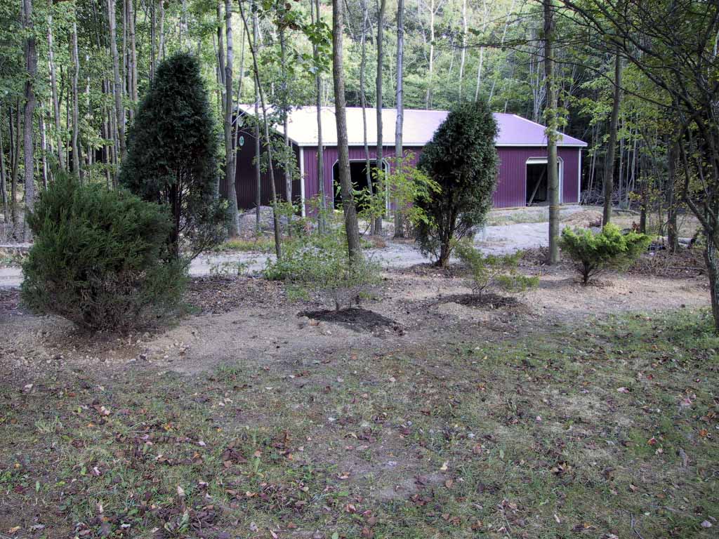

First two attached images are of the border area between our yard and the drive down to the polebarn after it was cleared and cleaned up (thanks to PineRidge for the grapple work) and after we had transplanted some shrubs (2 arborvitae, 2 spruce, 3 azeleas, and 1 rhododendron)
These shrubs were around our pool in back of the house and needed to be transplanted because they were too crowded and they were in the way of the work that we need to do to the back of the house and pool area.
The third image is looking north into the border area (on left in image) from the polebarn before it was cleared and the transplanting done.
