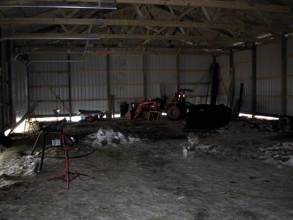

And before too very long the stuff just starts piling up. /forums/images/graemlins/grin.gif
The B2910 gives a point of reference for scale.

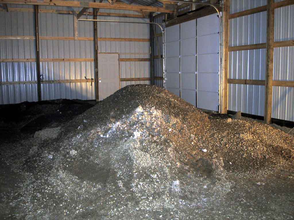

#169
Big gap under the skirtboard - gonna take alot of fill. Lotsa ice and snow too.
