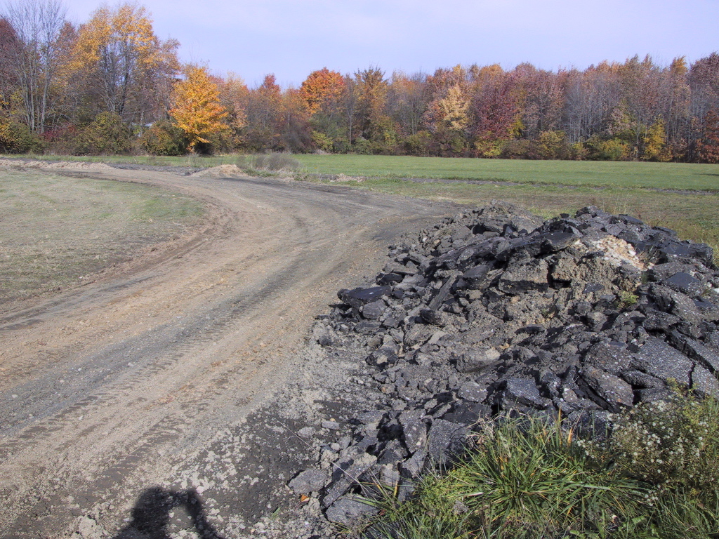

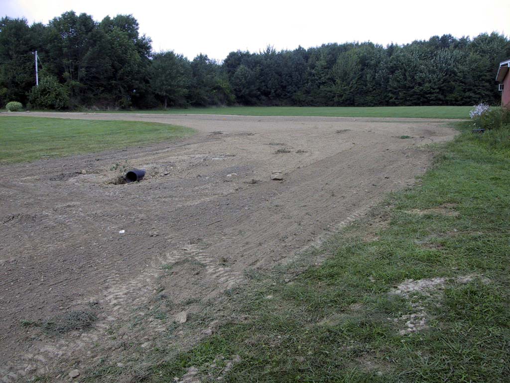

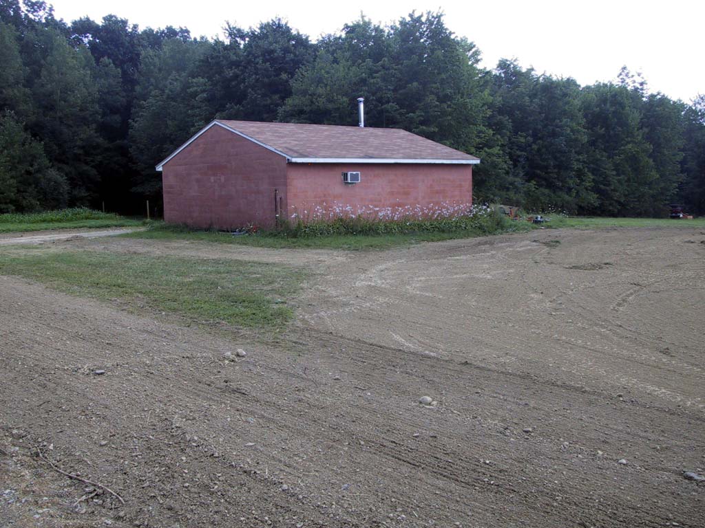

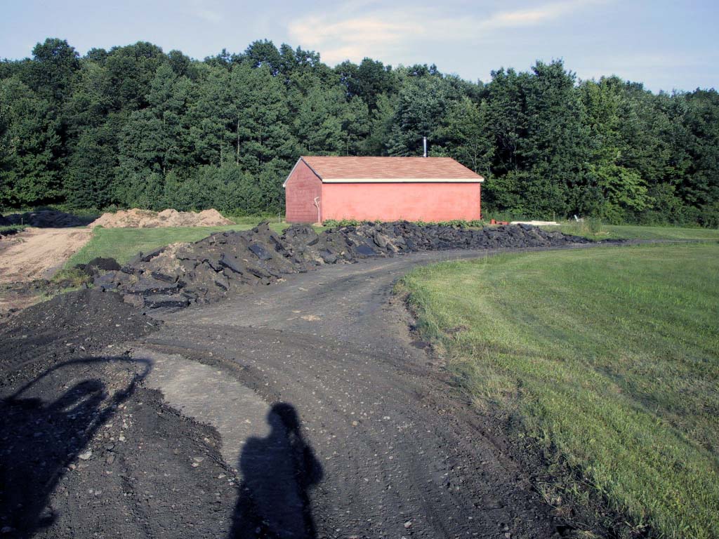

The first three images are the "after" - of the fill, grading, prep for seed work where the old driveway was.
The last two images show the same areas "before"

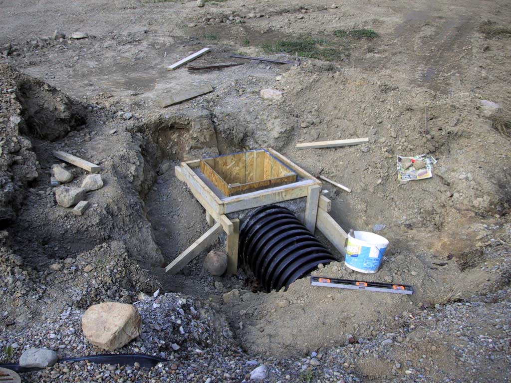

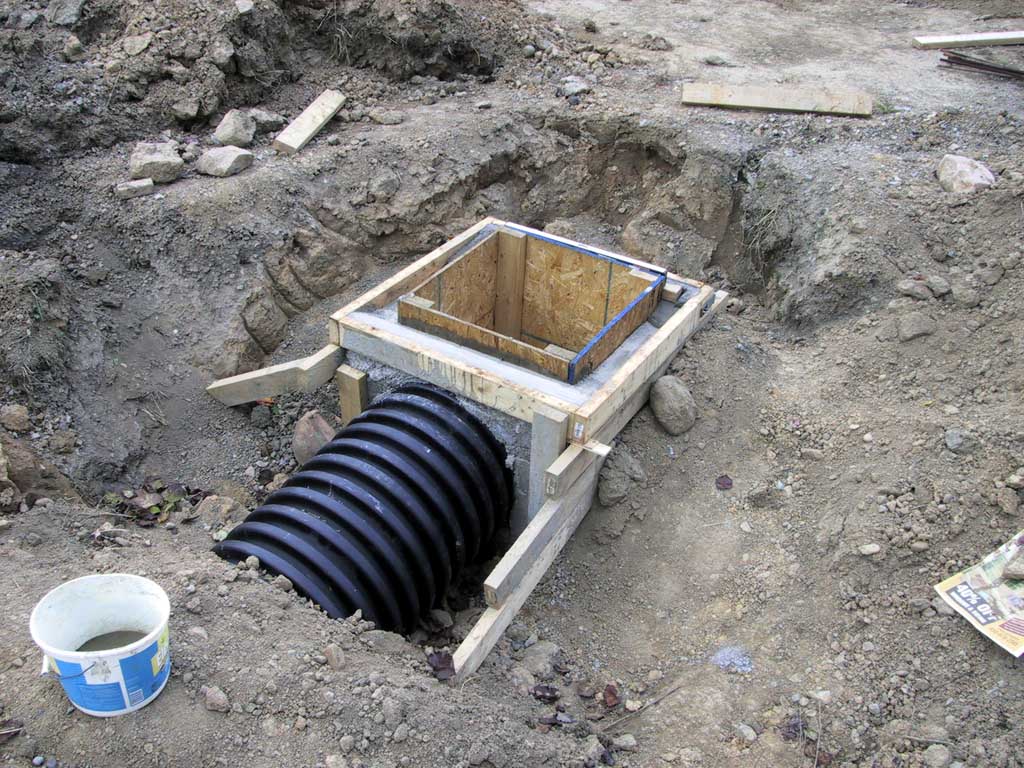

#194
A couple of shots of a 2' x 2' x 3' catchbasin that I'm building at the the bottom of the old drive, next to the new drive. This area is the lowest part of our front yard - probably 4 to 6 acres drain to this point, before passing under the new drive thru the culvert in the picture.
The basin should have about a foot or so of sediment trap in the bottom. It will have a cast iron grate on the top when finished so it can be driven over when I mow if need be.

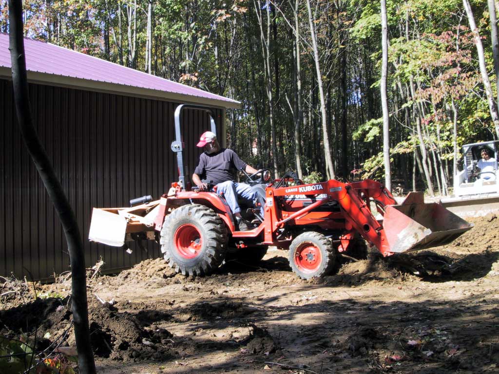

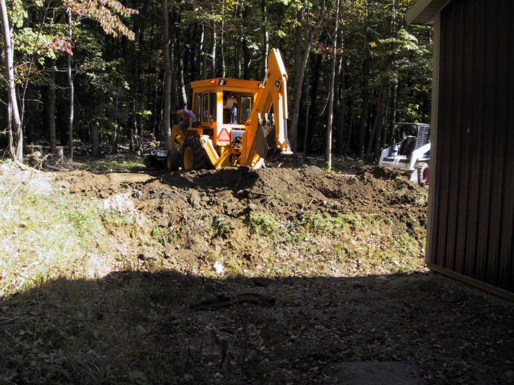

#196
After a bit Zack decided to go get their new JD CUT to help out. Wasn't too long after that that his Grandpa, Jeff, showed up to investigate what he was up to. We got to talking about what we were doing as far as taking the trees out and the retaining wall, etc. and Jeff ended up talking me out of putting in a retaining wall and just grading off the bank and planting it grass. It would have been a huge job for me alone but Jeff offered to go get the JD 310 and Bobcat to speed things up a little. :D

#197
Of course he no sooner had gotten the JD down to the site than someone else was ready to take the controls .... so Jeff had to settle for the Bobcat. :D

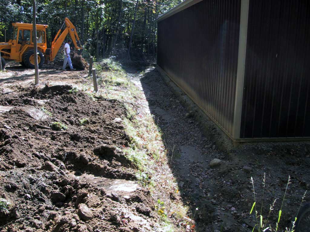

#199
Jeff made fairly short work of the tree and stump removal with the JD

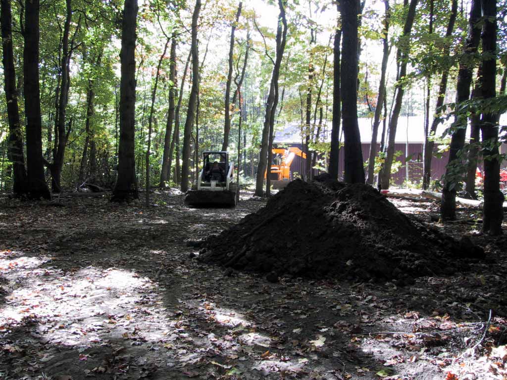

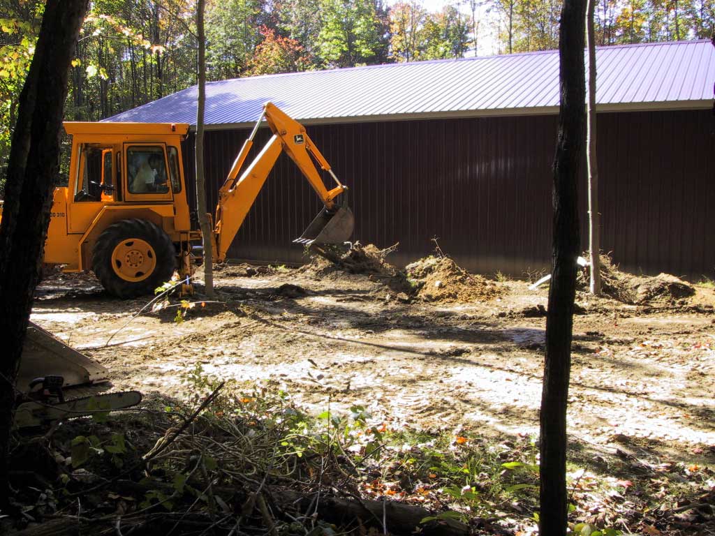

#200
With all of us working in such a confined space it was about like a three-ring circus but it turned out just fine .... after a little bit it was like a well-oil machine. Jeff took out the trees and lossened up the top soil, I used the B2910 and boxblade to pull it away from the dropoff and pile it up for Zack who used the Bobcat to move it over into the woods and pile up out of the way.
