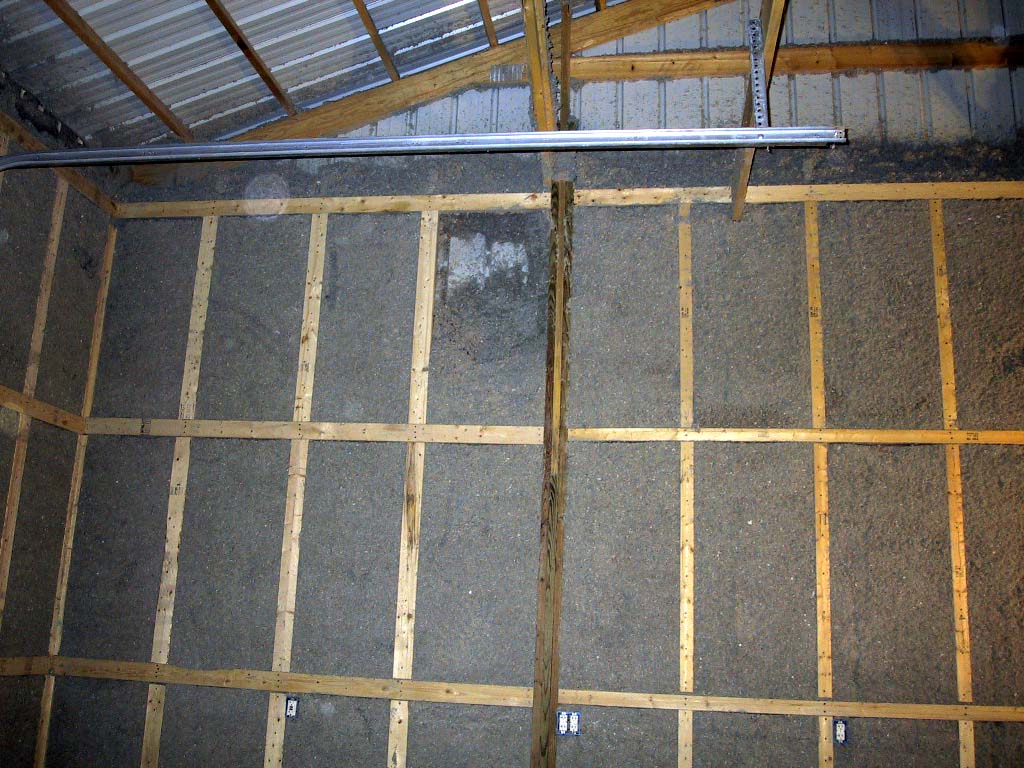

Eddie - you're quite welcome - happy to share. Yeah, it sounds good (in theory) - we'll see how it works out in practice ..... I think it will be ok.
It does seem to work well for hard to fill cavities - and it is very dense - not like cellulose that's blown in dry - it won't settle much if at all.
Attached is a pic of one of the areas where some of the insulation fell out up at the top. The horizontal board just under the overhead door track is all the higher the OSB will go and it's open - so once I get the OSB up there I just pack the insulation down in from the top.
This afternoon I found out about something that may be aggravating the problem ..... I was sitting in my lawn chair out in the barn taking a break and I noticed a couple of visitors ..... a pair of barn swallows cruising around and hoping all over the place. :mad:
I got the impression that they thought that they had found an ideal new location for a home - plenty of available building materials. So I walked back over to the house and got my pellet gun. :eek:

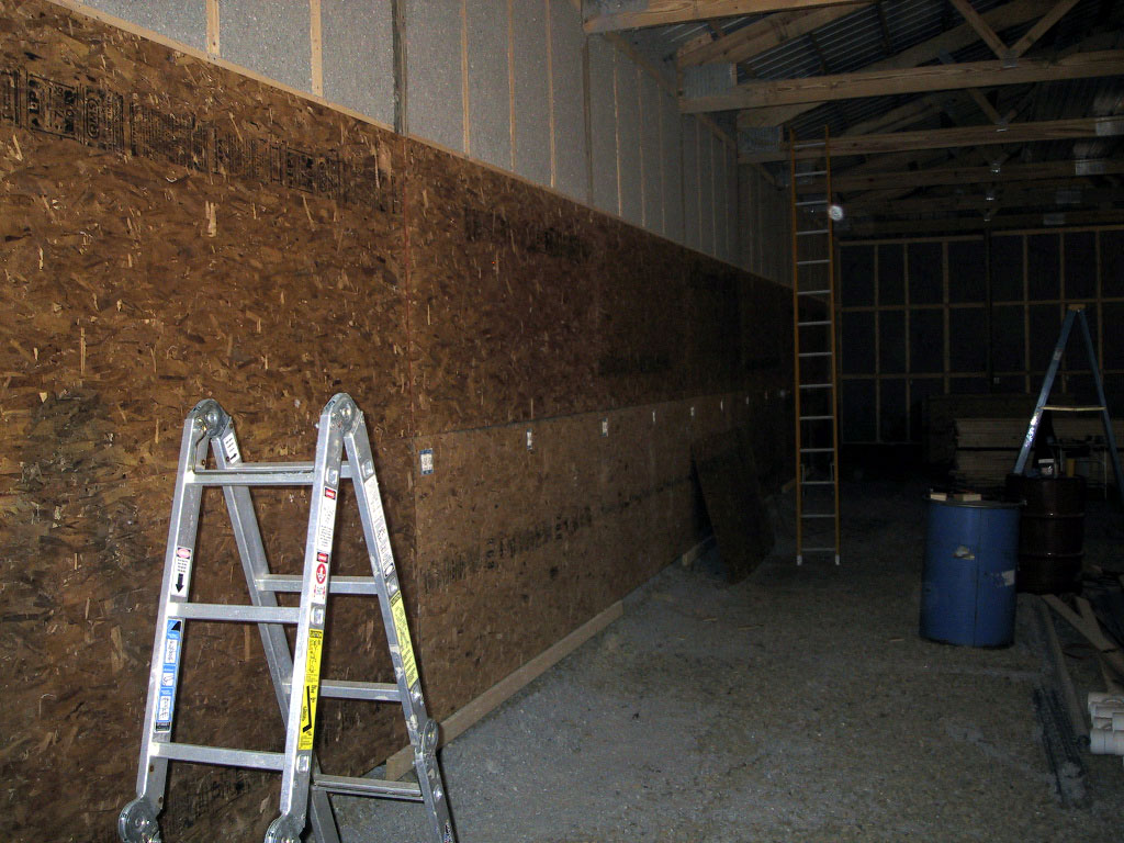

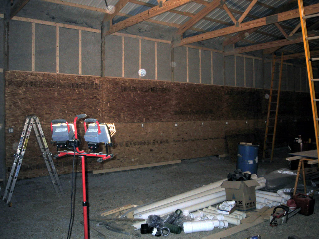

Attached are a couple of images of the OSB going up ..... and the wall of endless outlets. :eek:

   / New Driveway and Polebarn #213
Did you go the Roto-Zip method for cutting out outlet boxes, or use an old fashioned jig saw? If you used the Roto-Zip how easy is it to use?
#214
Mike,
I went the RotoZip route, although I'm not really trying to trace around the (installed) boxes - I just measure and mark the board before I put it up, using a box to trace an outline and then cut that. So far it's working pretty good. I find it fairly easy to control and follow my lines .... but you have gotta pay attention 'cause it could get away from ya pretty easily if you didn't.
I ended up getting the deluxe Sears Craftsman roto-zip kit which is apparently an RZ20 made for Sears by Roto-zip, rather than the Roto-zip kit offering because Sears seemed to include more stuff for the same money (and more of what I wanted.)
The wife wasn't impressed at all ....... until I mentioned that it could be used to remove tile grout and then she said "Now you talking about something I'm interested in" :D

I've decided we're going to skip renting a drywall jack for the third course of OSB. Walking the sheets up a step ladder and then tacking them in place with a finish nailer is just working out too well.
I walk the sheet up and set it on top of the sheet below and then Lynn leans a 14' section of our extension ladder over against the sheet to hold it there while I tack it.

We've got 30 sheets up at this point. All the backwall is done, except for the end sections (north and south) .... same for the south wall - all up except for the end sections.
Out of that 30 I had to measure and trim 10 sheets for outlet boxes (2 per sheet) and another 7 sheets (on the top course for the back wall) for the bottom cord of the trusses.
