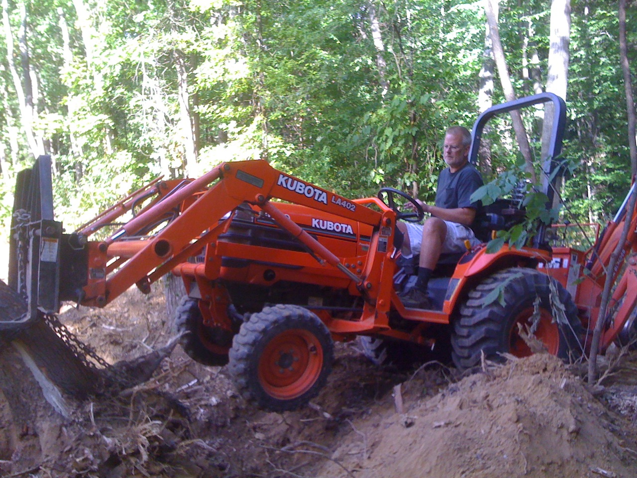

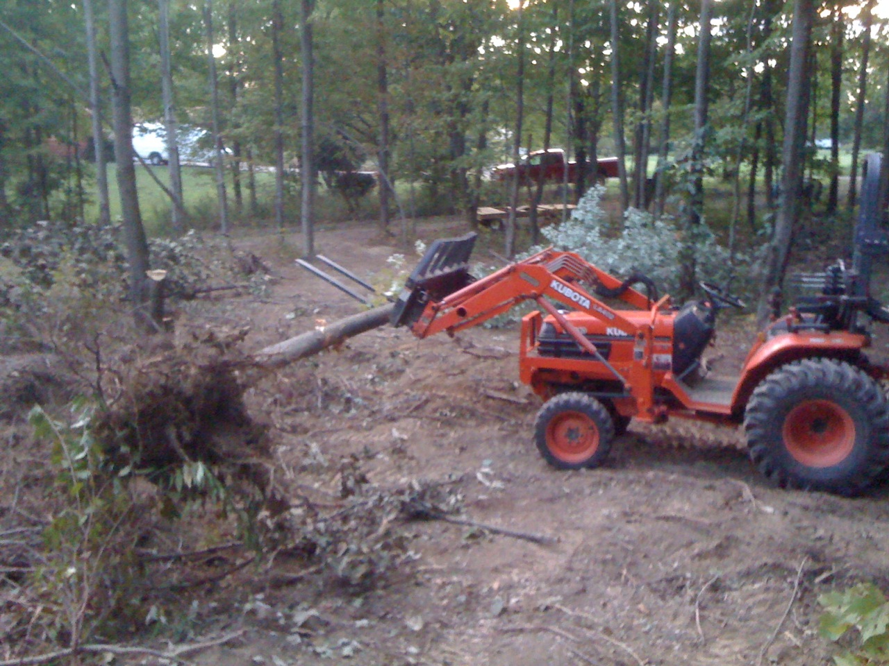

Yeah .... I thought more than once about callin' ya' to see if I could weasel an afternoon out of ya ..... the grapple on your TC-40 would have come in handy (more than a few times. ;) :D)
But I got it done .... (my pallet forks came in pretty handy :thumbsup:)

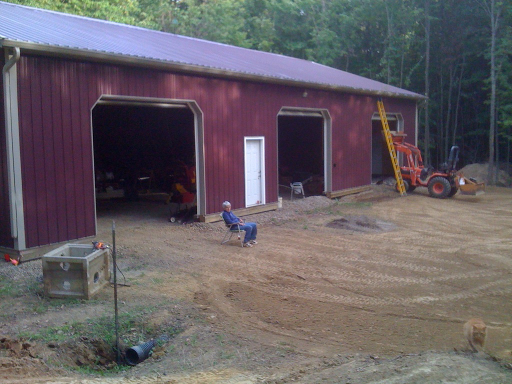

Front of the barn as of this evening, with my "helper" on break, relaxing in the chair. In the lower right corner one can see the other helper - Mister Kitty - racing up to assist with the photography.
Got the gutters on this side cleaned out .... just in time for the fall refill :confused2:
Pulled the catchbasin yesterday and knocked 3 more holes in it to connect the lines from the french drains and the tightline from the downspouts on the north end of the building. Got it back in the hole, re-set, and the bottom below the exit pipe 'creted in before the light was no more.

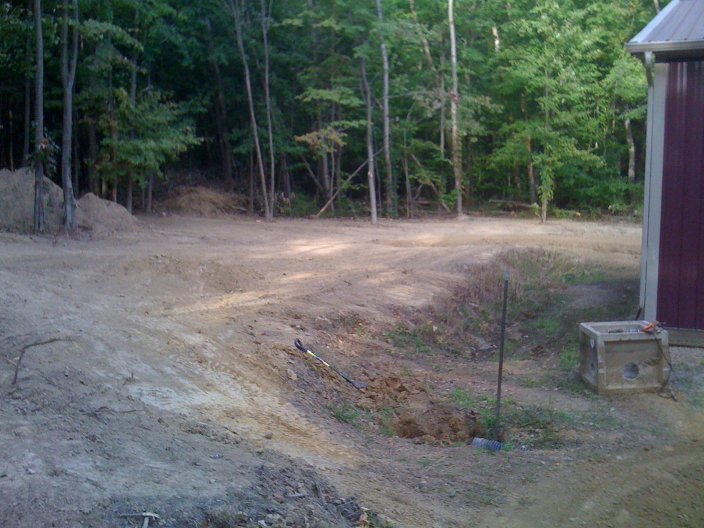

This is the north end of the building - took out about 15 to 25 trees on this end. The trees came right up next to the dropoff .... one of them was actually starting to get undermined ..... glad I caught it before it went over :cool:
I've removed around 2' or so of topsoil to uncover the clay.
There will be two french drains installed on this end - one further upslope, to (hopefully) intercept subsurface water before it gets down near the barn, and another one closer in - probably 8' to 10' out from the building - to drain any water in the ground near the building itself.
Additionally, over the lower french drain there will be surface drains which will be tied into the tight line for the gutters. All of it empties into the catchbasin.

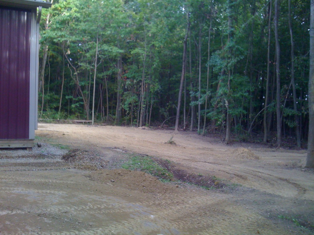

Back side of the barn (faces east) There is about a 5' to 8' drop over 30' or so, from the woods to the barn (grade at north end is higher than the south) ..... this side will get the same drainage treatment as the north side - one french drain upslope, another down low, and surface drains.
This side had been graded to a slope previously, a couple of years ago. I put the ledge in today so I can run a mini excavator across the slope to do the trenching.

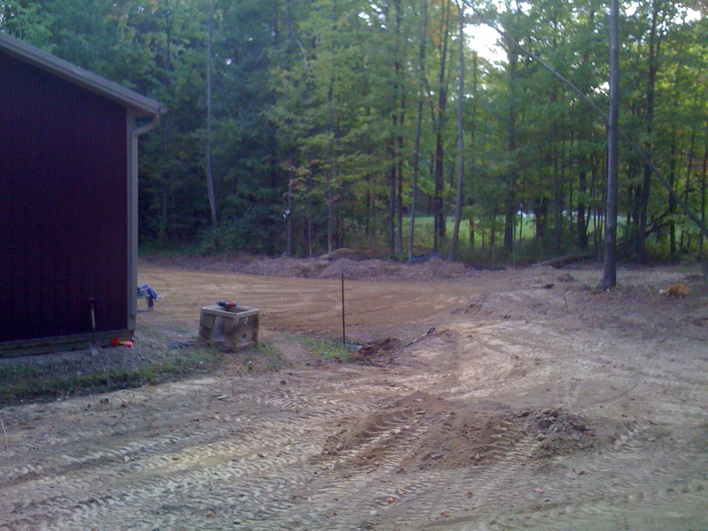

South side of the building .... took out about 15 or so trees on this end.
I'm pretty good on this side ..... there will be one french drain on this side nearer the building, since grade mostly slopes away from the building .... maybe a surface drain or two on the back side (tied into the tightline for the downspouts), where there isn't as much slope.
There is a wild fern in the middle of the image which I managed to save thru all the tree felling, stump grubbing, and grading. It is unique and different than any of the wild ferns I've seen growing around here. May try and transplant it as native landscaping to an area that will be less prone to traffic.

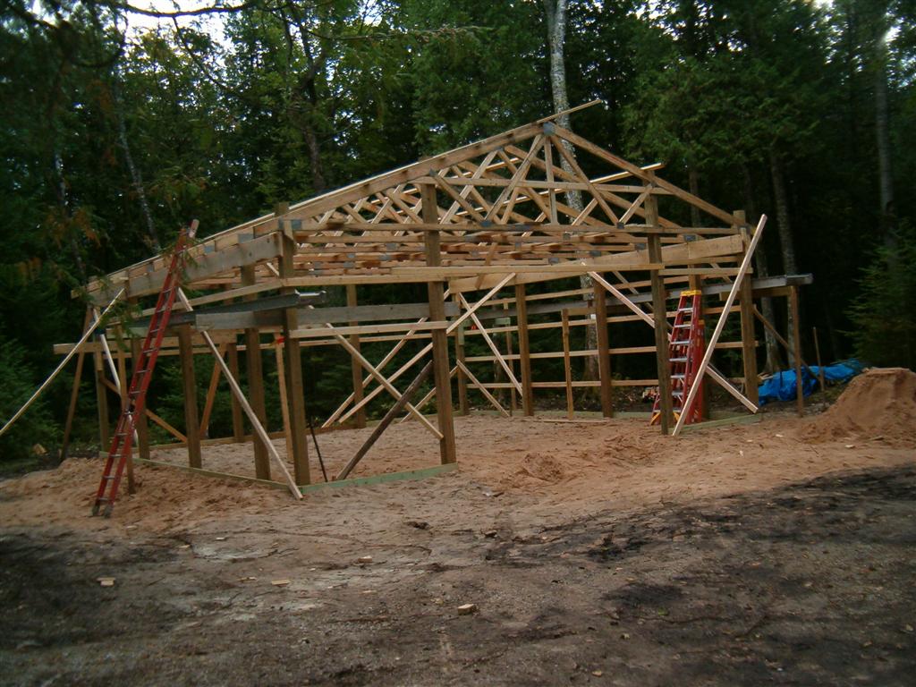

I'm in the process of erecting a small pole barn myself. I made sure however to haul enough fill sand to provide a favorable grade for the floor and to provide a positive flow away from the building. Perhaps you were not able to do that but just hoping your grade is high enough also. I mention this because you noted that your grade was, "building pad was cut into a bank"
I priced several pole barn packages prior to purchase. To make the price cheaper I suppose, every provider included a treated sill board specifying above grade. I don't care for that. Since I wanted to screed the concrete floor directly off the top of the sill board the outside grade will probably touch this sill board. Since this area may be in contact with the ground I figured it should consist of .60 ground treated lumber even though it costs a bit more. I have seen that .40 stuff fail in less than 10 years when used for ground contact applications.
I don't think one should count on visquine to provide much protection over the years because it treats the effect and does not address the cause.
